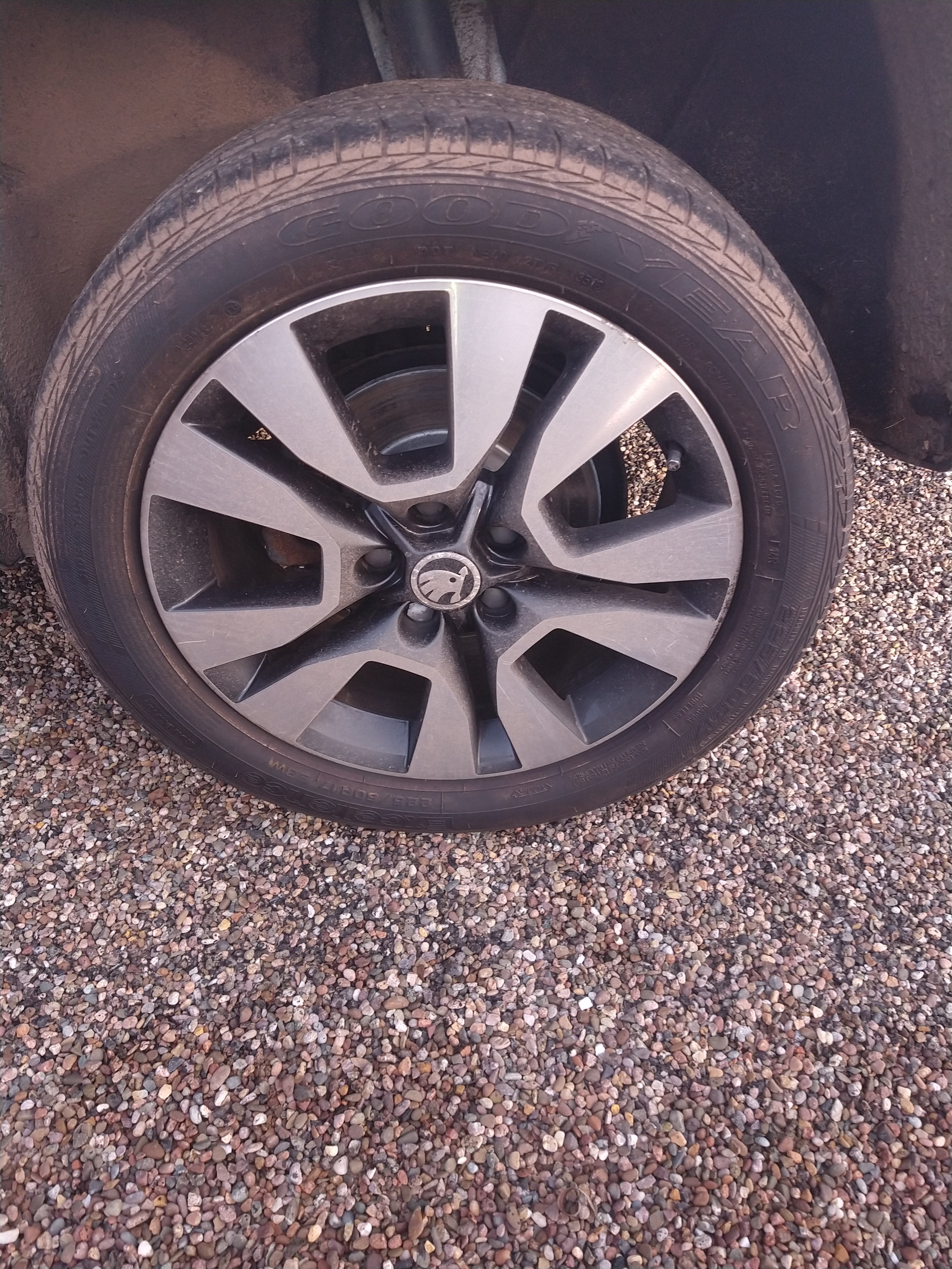

Do you have a photo of the wheels?

Have the wheels been confirmed as OEM or suitable for run flats though as you may be starting a different mixed up conundrum?
Here is a picture of one. I will take advic when the tyre fitter comes this evening. Cars were never this complicated in my day - nor did they have computers.
