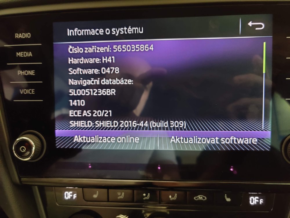

Perfectly, work it..IMG_20200907_143700.thumb.jpg.63b5986d9329b471457ebf65309f61f5.jpg

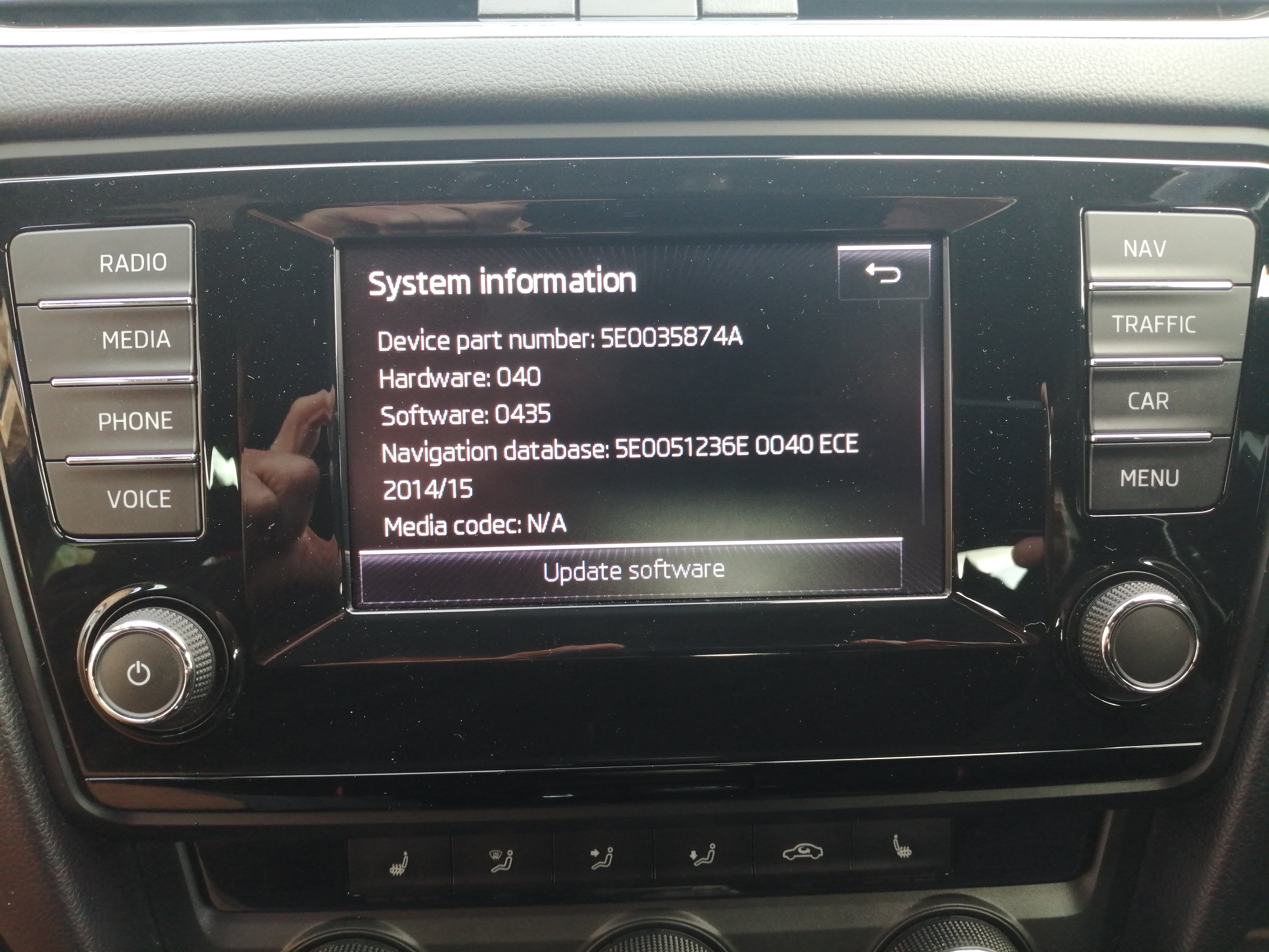

How shaould I know what is your unit device part number and software?
Hardware version: 041
Firmware version: 0435
MIB I
MIB I
Bolero
You are still missing device part number (e.g. 5E0035819C)
5E0035840A

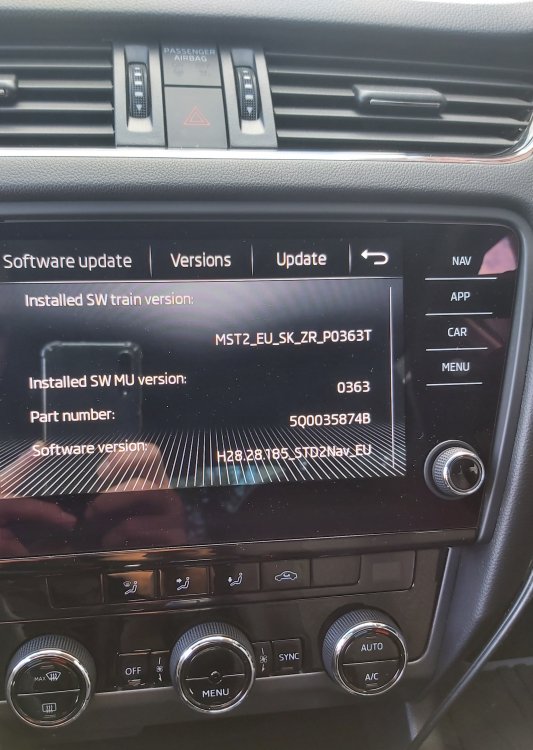

Device part number: 5Q0035874B
Hardware: H30
Software: 0363
Can I have the 0363 as well please? Just in case I do not like the new update, so I can revert back to old one.
