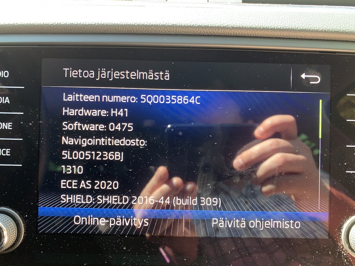

Hello,
I see that the SW version of my Amundsen unit is a pretty old. I visited the official dealer recently, but unfortunately I was not told that there is a newer version. Would you send me a link to a newer version to update it?
Thank you

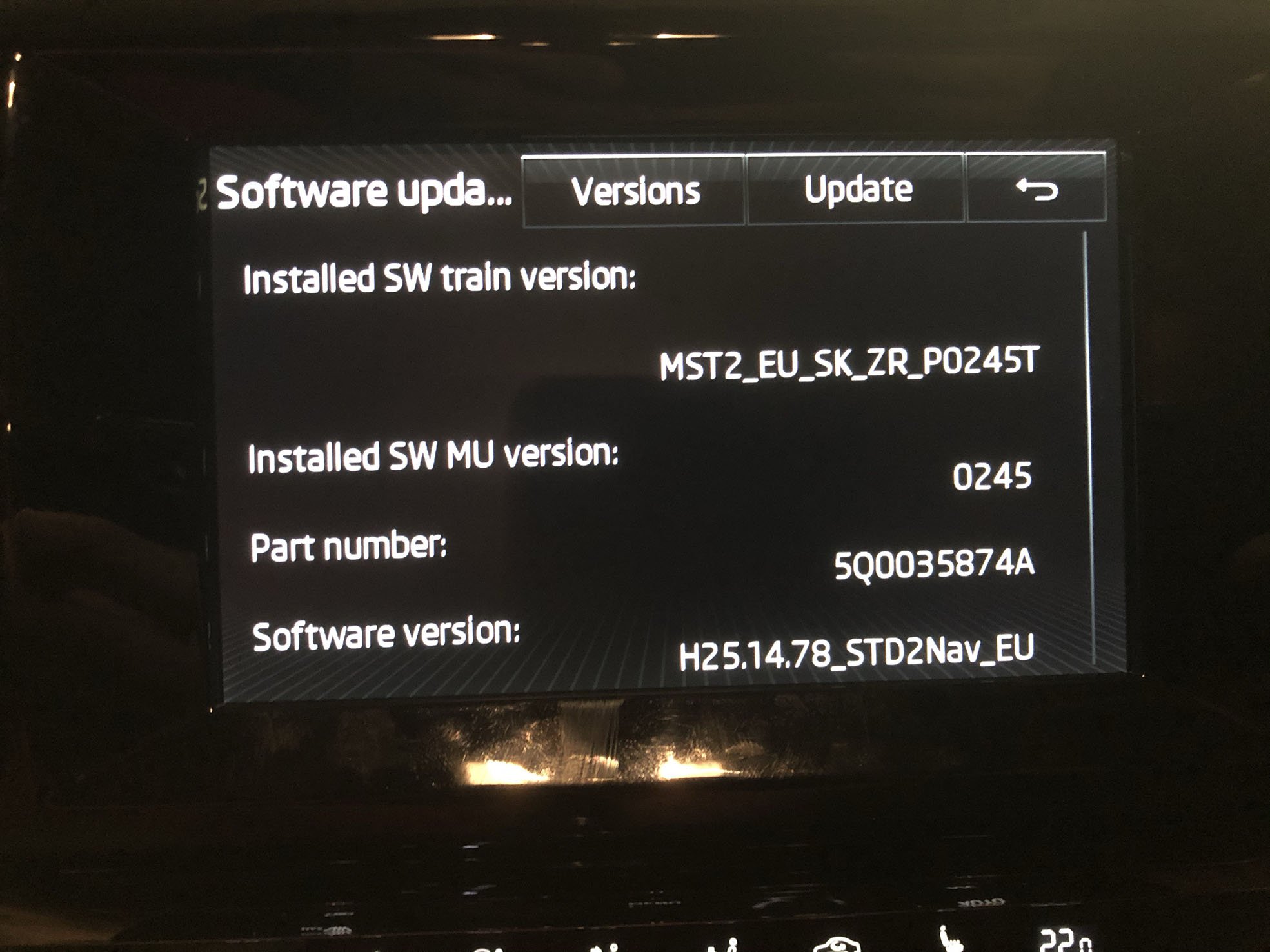

Hi
Can I update this unit ?

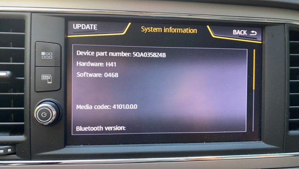

Hello, I own a Seat Leon 3 5f my18 with multimedia mib2.  can you offer me an update for it.  Thanks in advance.

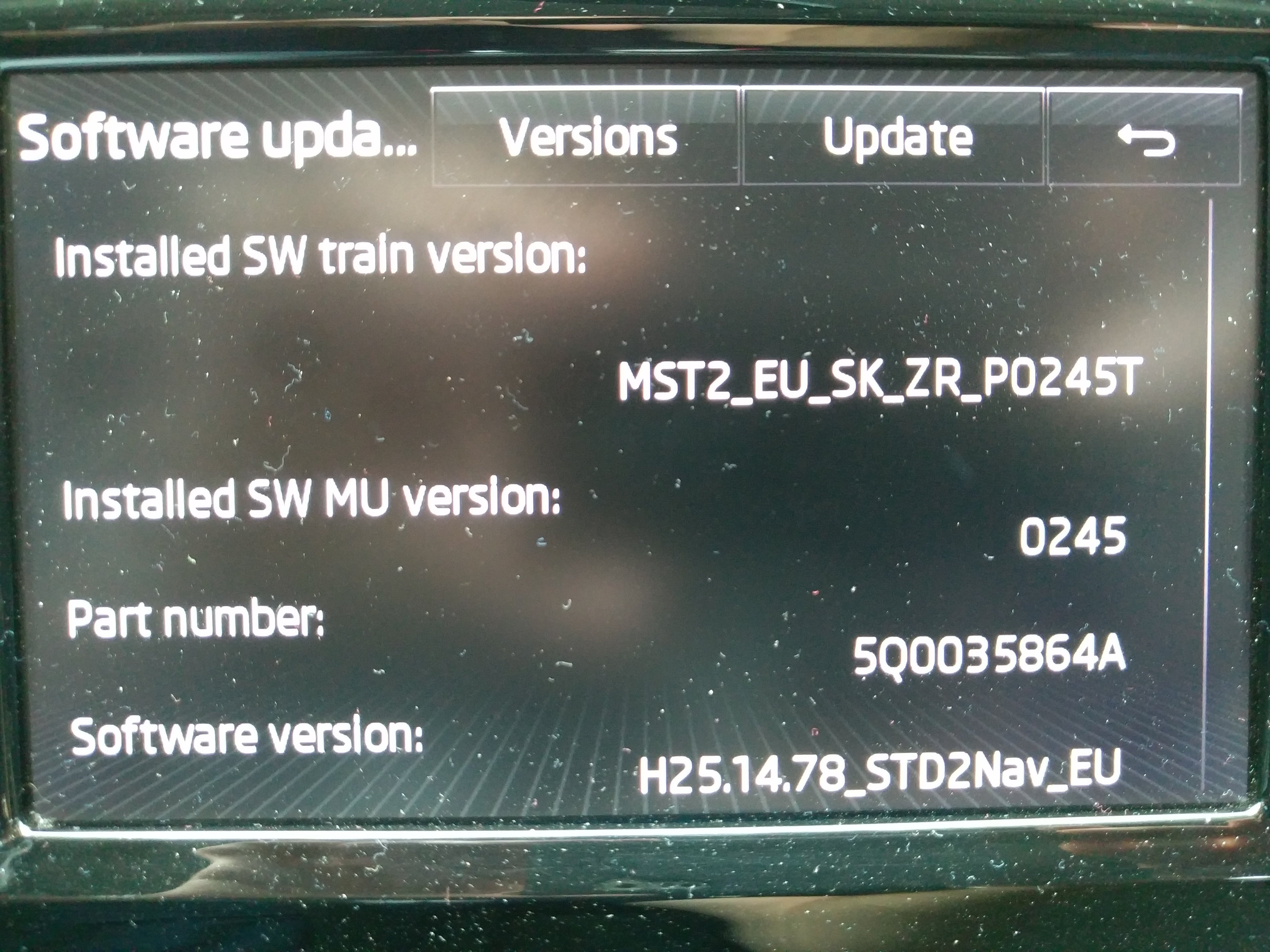

Hi. Any update for this?
And this one

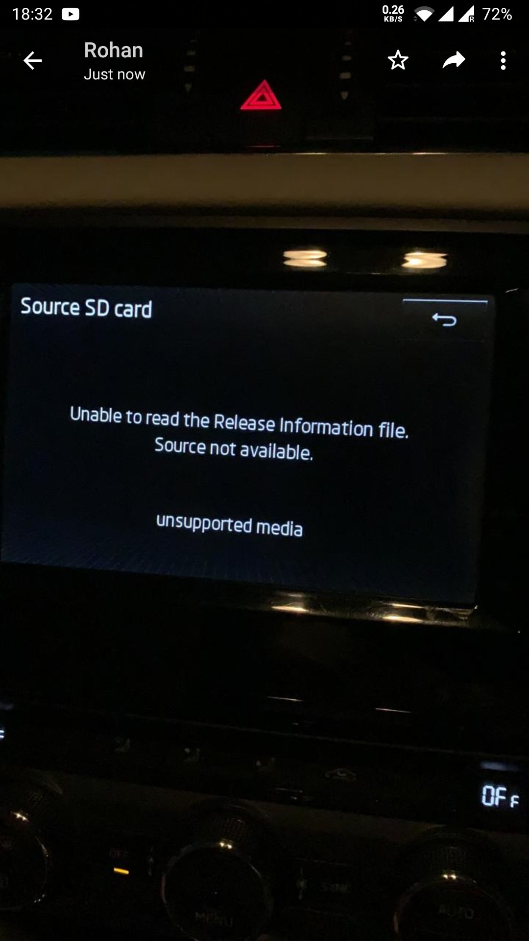

@pab567 I get this error
How many times I have to mention that sw upgrade must be made from service menu.... (long press menu button)... and that all files must be unpacked to FAT32 formatted SD card, initialized under MBR, and must be unpacked to the root folder (file metainfo2.txt and all folders must be directly in the root)...
Thanks @pab567 you are the best! 😀

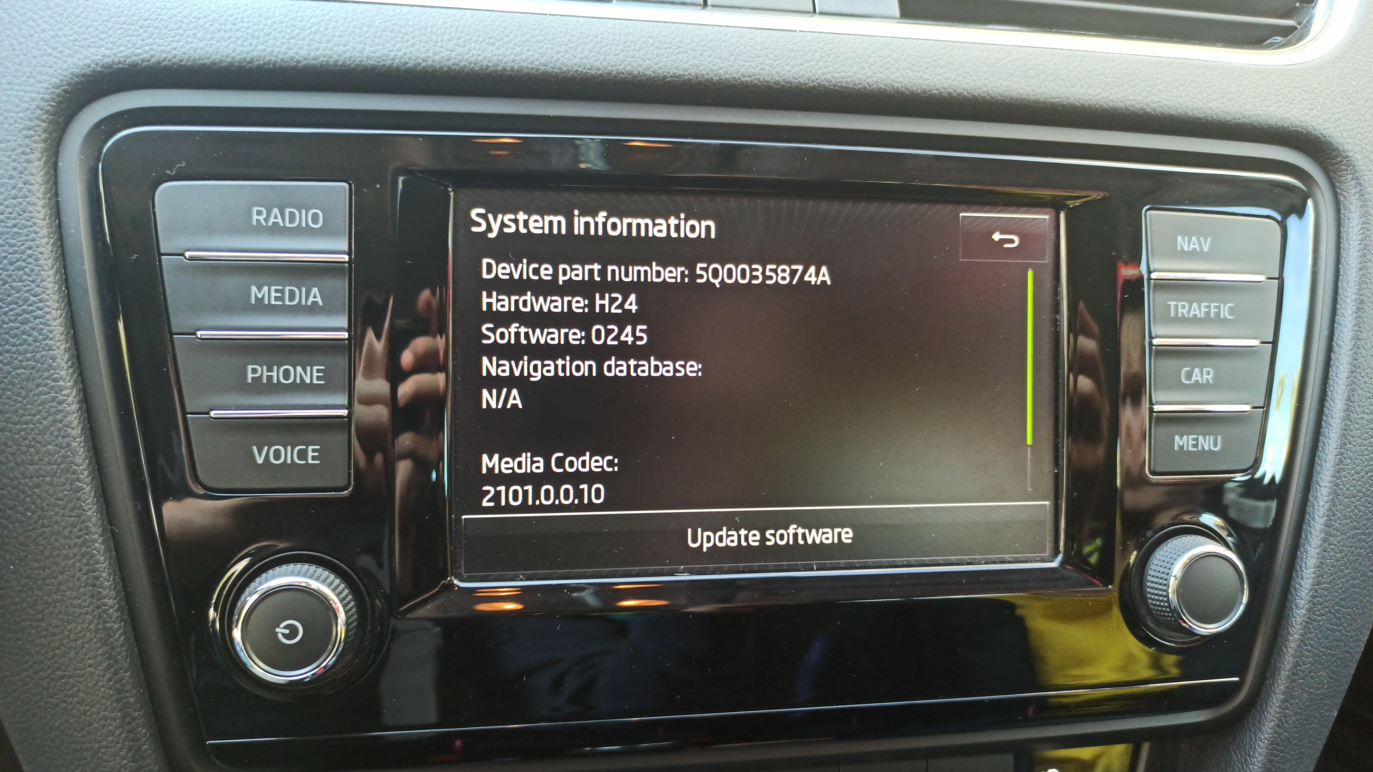

@pab567 Hi there, coming right in from my car dealer. Did buy a used Skoda Octavia. Can you tell me if there is an update available? Thank you very much. If you need more details just tell me.
Can you send me update for this radio ?
