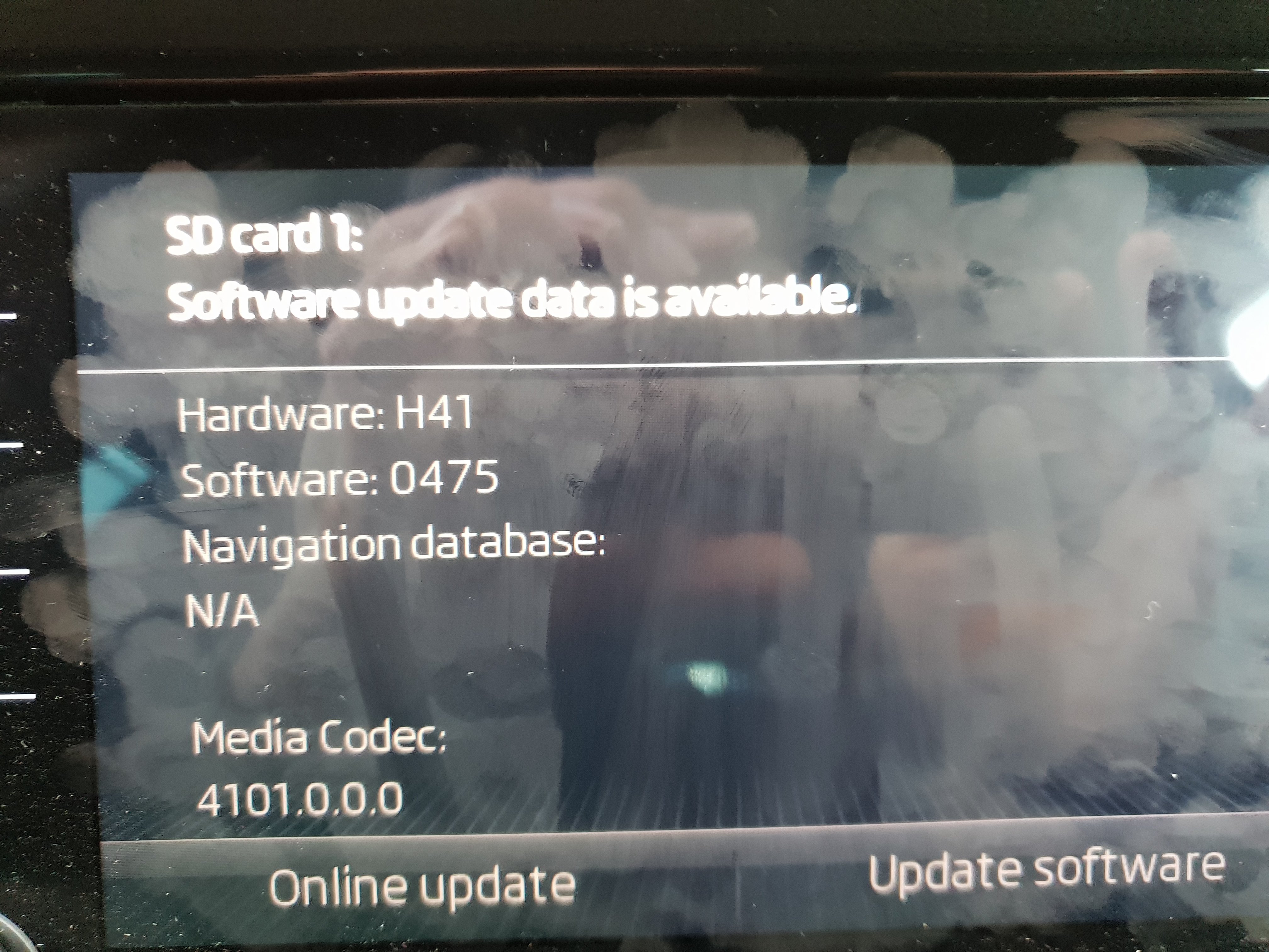

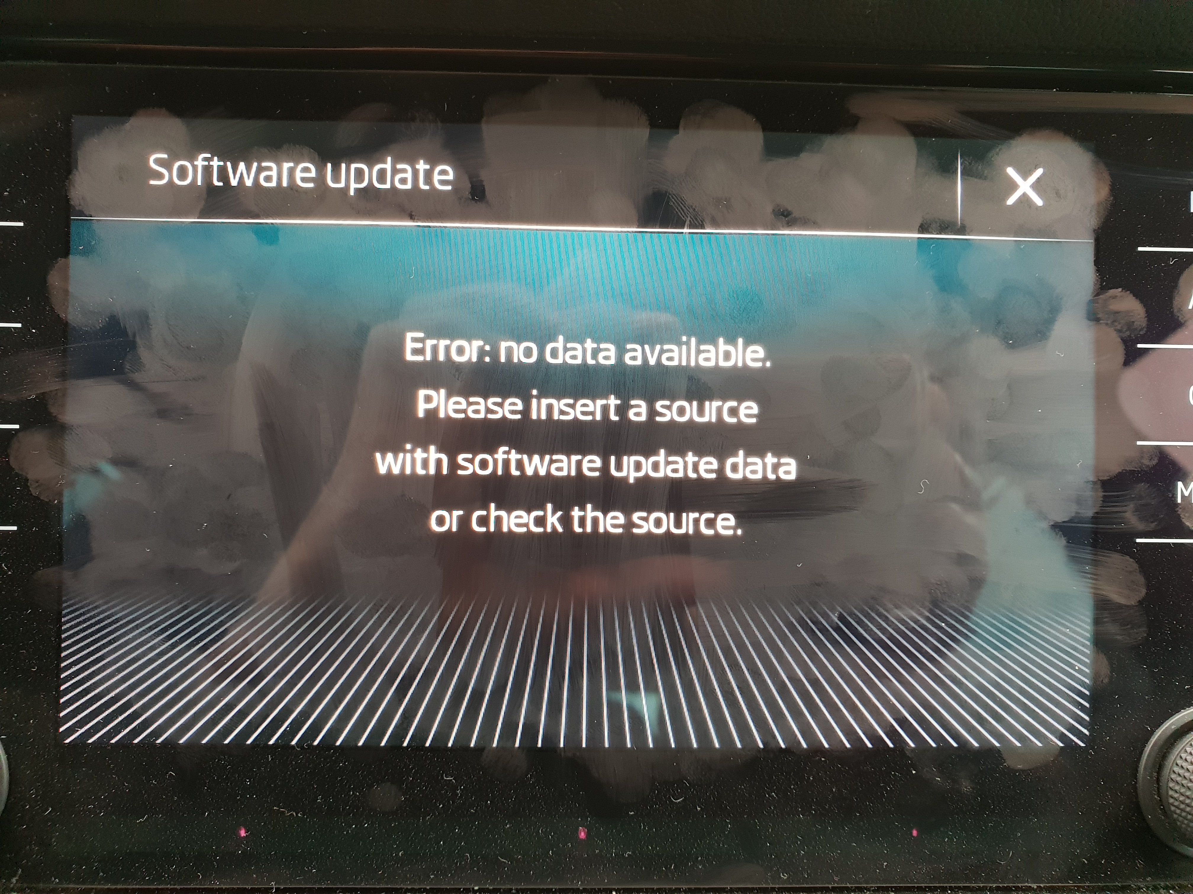

Hi, I can't update!
1. Format a SD card to FAT32.
2. Extract the contents of the file that I have to the SD card.
3. Remove ALLcards from the controller in the glovebox
4. Insert the card containing the firmware update into Slot 1
5. Go to Service menu, find and activate the update function...
What am I doing wrong?! (see attached files)

Do a long press to the menu button.

Thanks, it's okay.

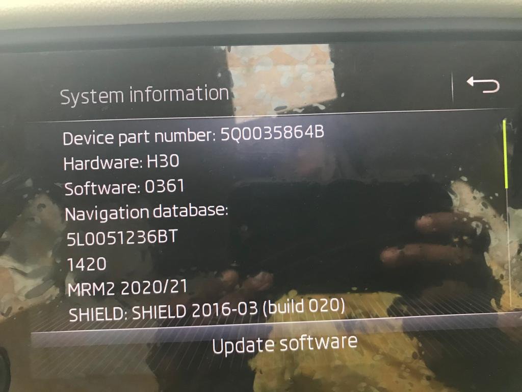

@pab567 I have sent you a PM with HU system information. Please let me know if any update is available.
Warm Regards,
Sreehari
Check your PMs

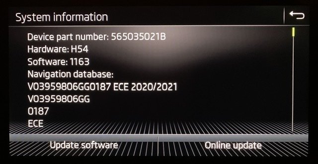

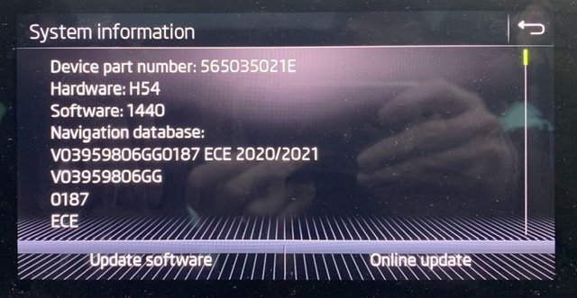

Just to add to this for anyone who is running a Columbus MIB2.5 system like me, I sent screenshots of my software versions to Pab567 last night and he sent me an update link straight away, went from version 1163 to version 1440 successfully this morning in about 20 minutes from a class 10 micro sd card. Hasn’t fixed the issue I had (continuous playback of mp3 files for mix albums etc) but good to know it’s at least up to date so many thanks to him for this. :thumbup:
