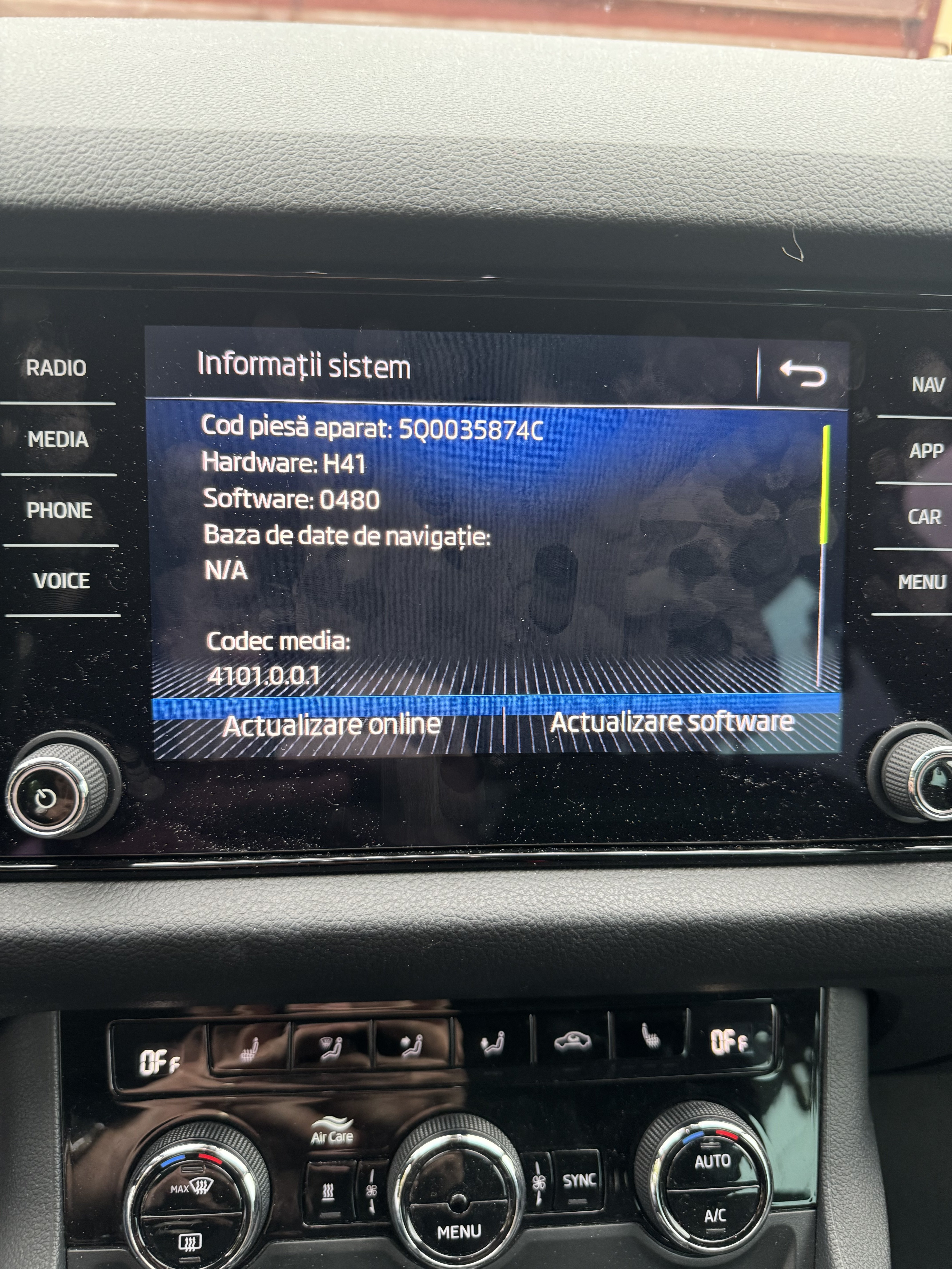

Hello @Joco776, I'm from Ireland and recently purchased a used 2017 Skoda Fabia Monte Carlo. However, I've noticed that Apple CarPlay is disabled in my Skoda Fabia. After reading through various comments and posts, I'm wondering if you could assist me with updating it, if possible. Trying to send you the message but it's not working so.
Additionally, I have an SD card slot. Can I use any SD card, or is it necessary to use a Skoda-specific SD card?
Here are the details of my car's software:
Software Update:
Installed SW Train Version: MST2_EU_SK_ZR_P0359T
Installed SWMu Version: 0359
Part Number: 5Q0035840b
Software Version: H28.133_STDPlus_EU
Logging:
Current Version: MST2_EU_SK_ZR_P0359T (0359)
Update: MST2_EU_SK_ZR_P0359T (0359-2)

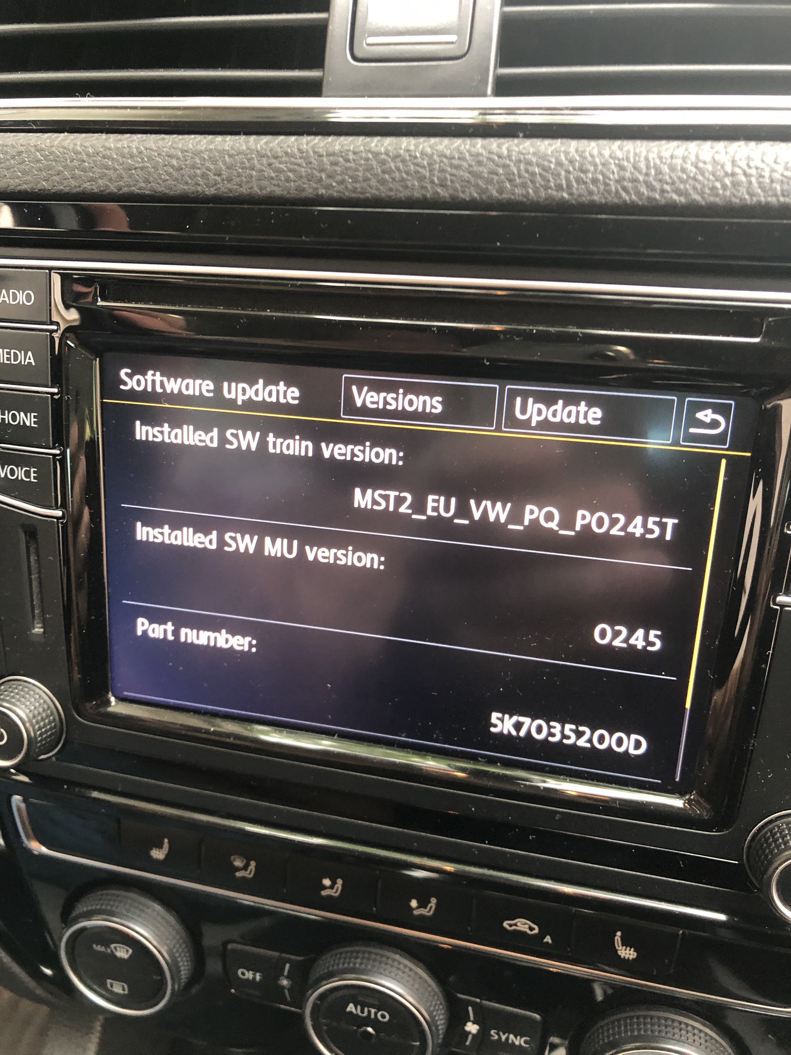

My apple carplay is disabled in my Octavia mklll and it said I had to contact the dealership to get an activation key. I think you can’t solve this with a software update and you need a seperate activation ‘key’
@AmolK Hello, you have to do the activation at the seller. I can only send you an update on 0369T. I would have to have your unit with me to put 0480 there.

Hi, i am searching for the Firmware Update for my skoda superb 3t … Codes Are all legit …
