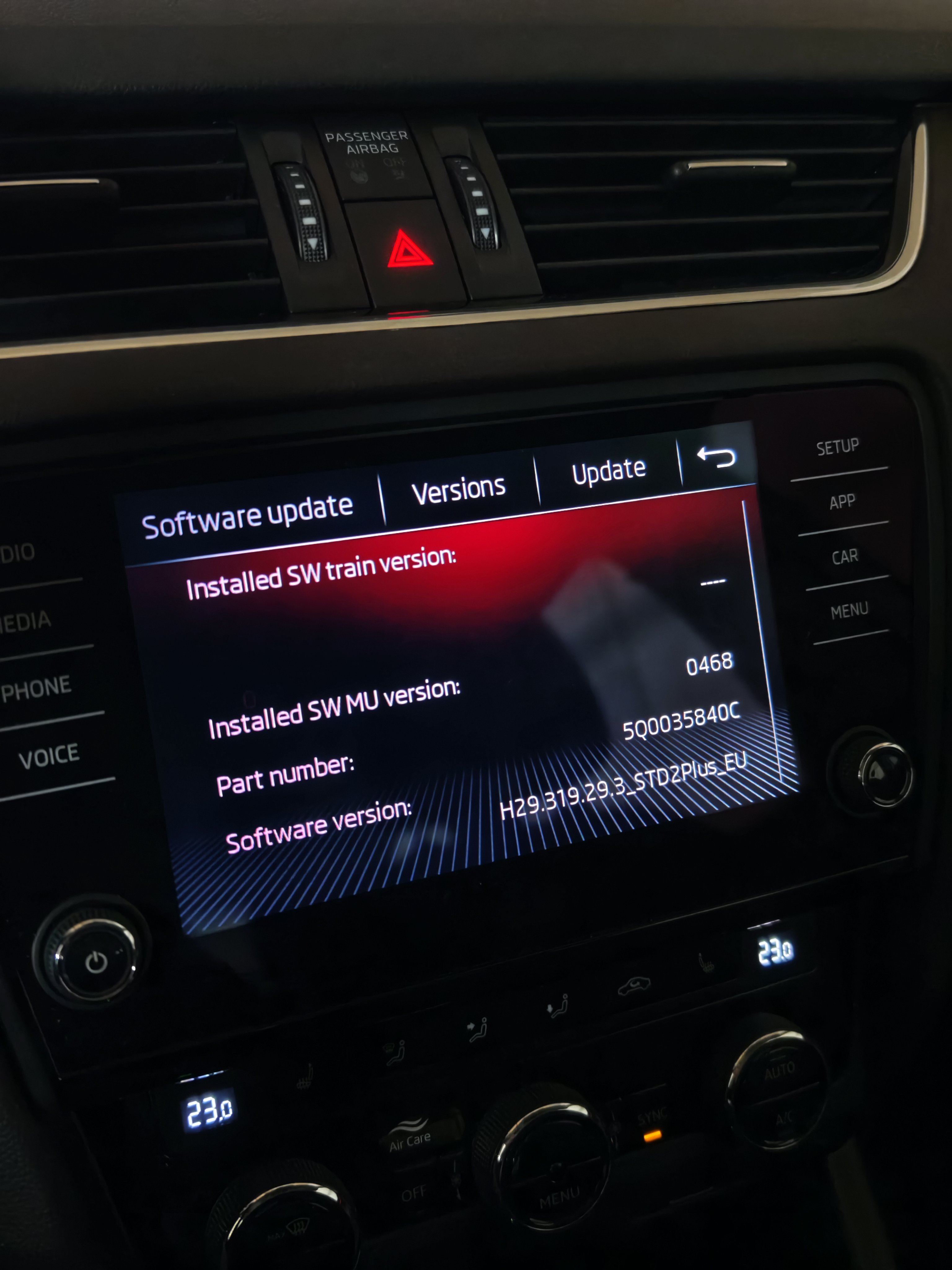

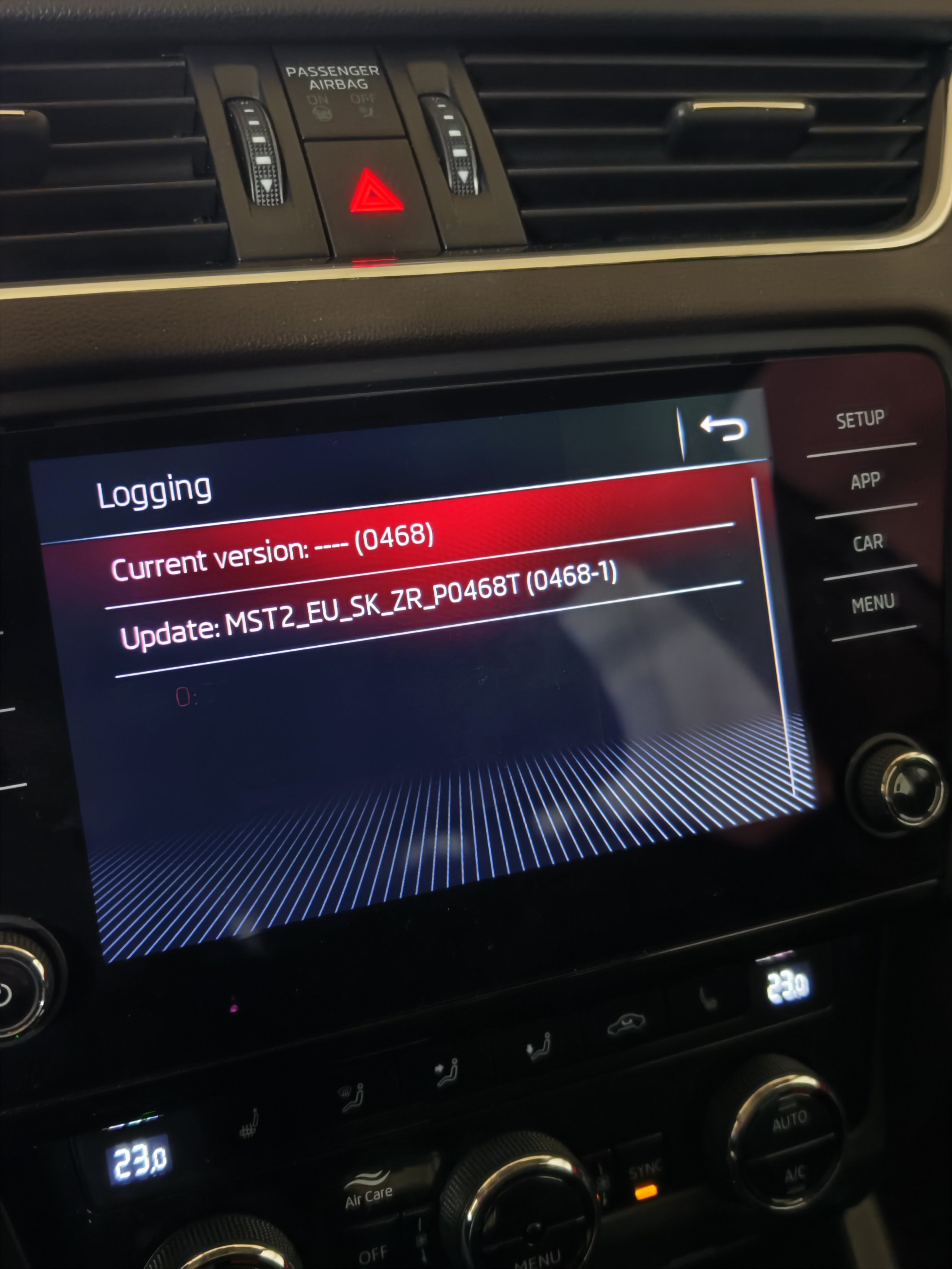

Hello,
I just bought a 2018 Skoda Octavia L&K.
I checked the MIB2 software and it is version 468. From what I read on this topic, my model should have version 480 as the latest update.
The situation is this: Android Auto works since I bought the car. It disconnected twice, but it works. Apple CarPlay does not work (I tested with a friend’s iPhone and the screen shows that the function must be activated at a Skoda dealership) but this does not affect me because I do not use an iPhone. I mention this because, according to the forum, the Installed SW Train Version field is blank. It is possible that the previous owner hacked the unit and activated only Android Auto.
My question is.. If I update the system to version 480, will Android Auto still work?
Thank you in advance!
