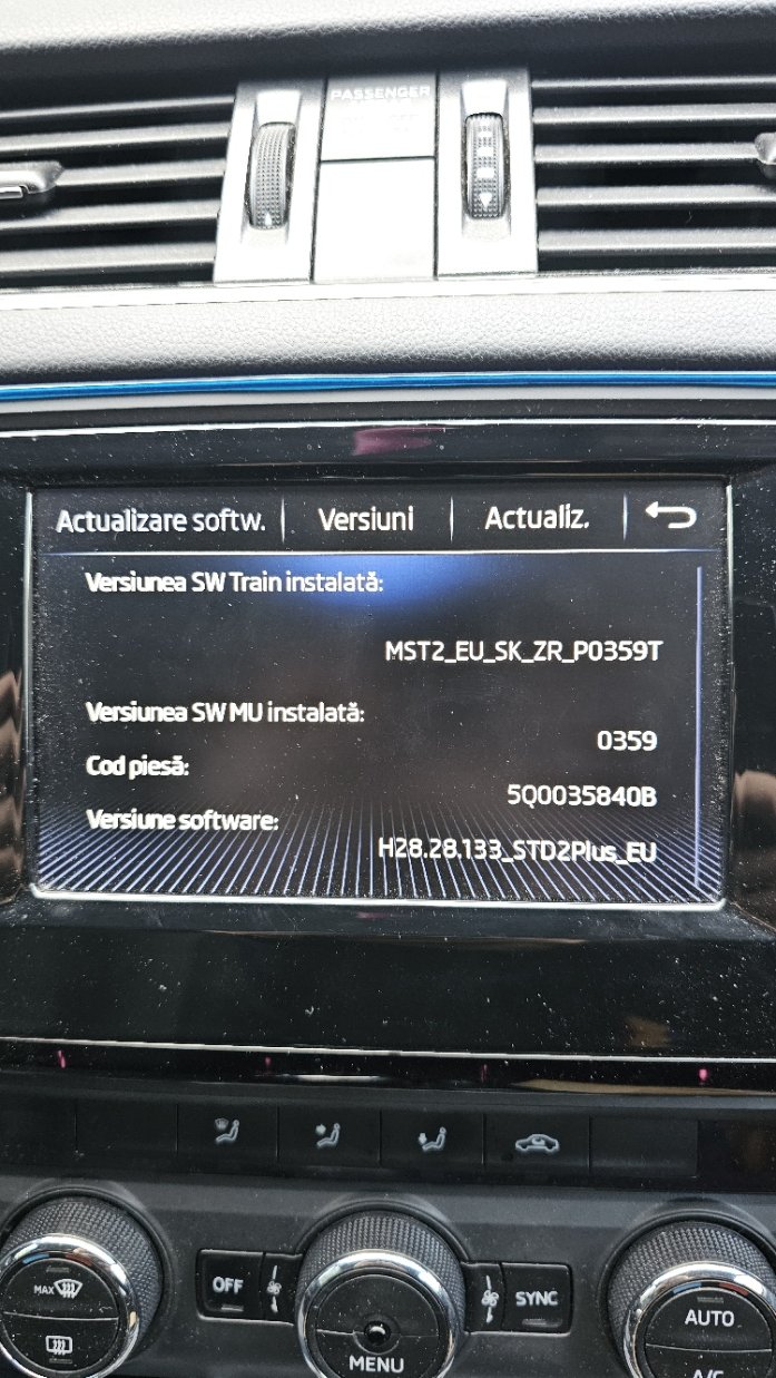

3 hours ago, ulli0824 said:
Hello,
the latest official firmware update for your headunit is: Latest official firmware update: MST2_EU_SK_ZR_P0369T.
You can check this yourself on the website: https://mib-helper.com/index.php?train=MST2_EU_SK_ZR_P0359T.
Unfortunately, I can only help you with the information, as I don't have access to the firmware. The download website https://mibsolution.one/ has been closed.
Perhaps someone else here can help you download the firmware.
Best regards

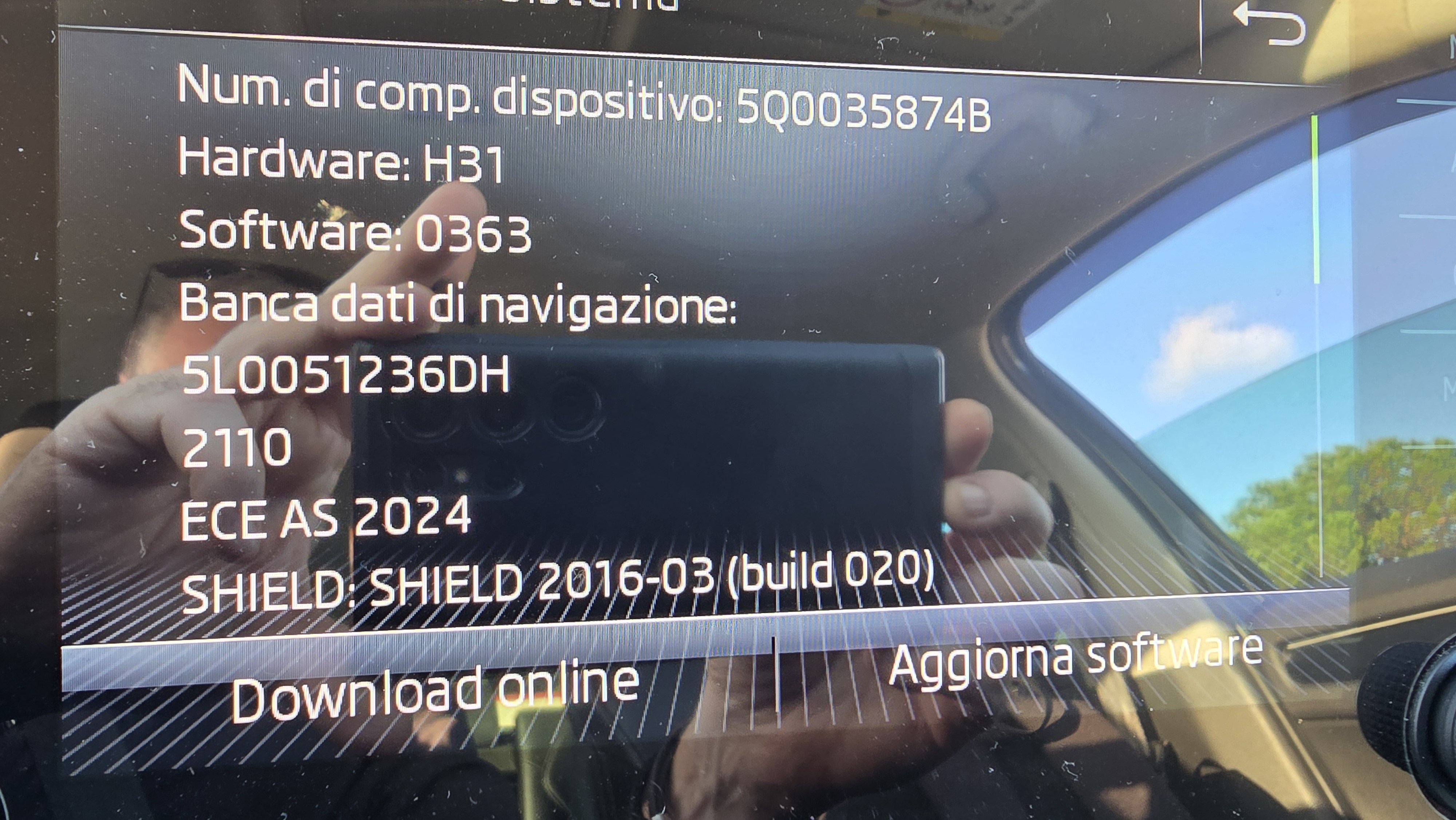

Can You update from Firmware x2xx to Firmware x3xx?
If so can someone share the firmware with me please

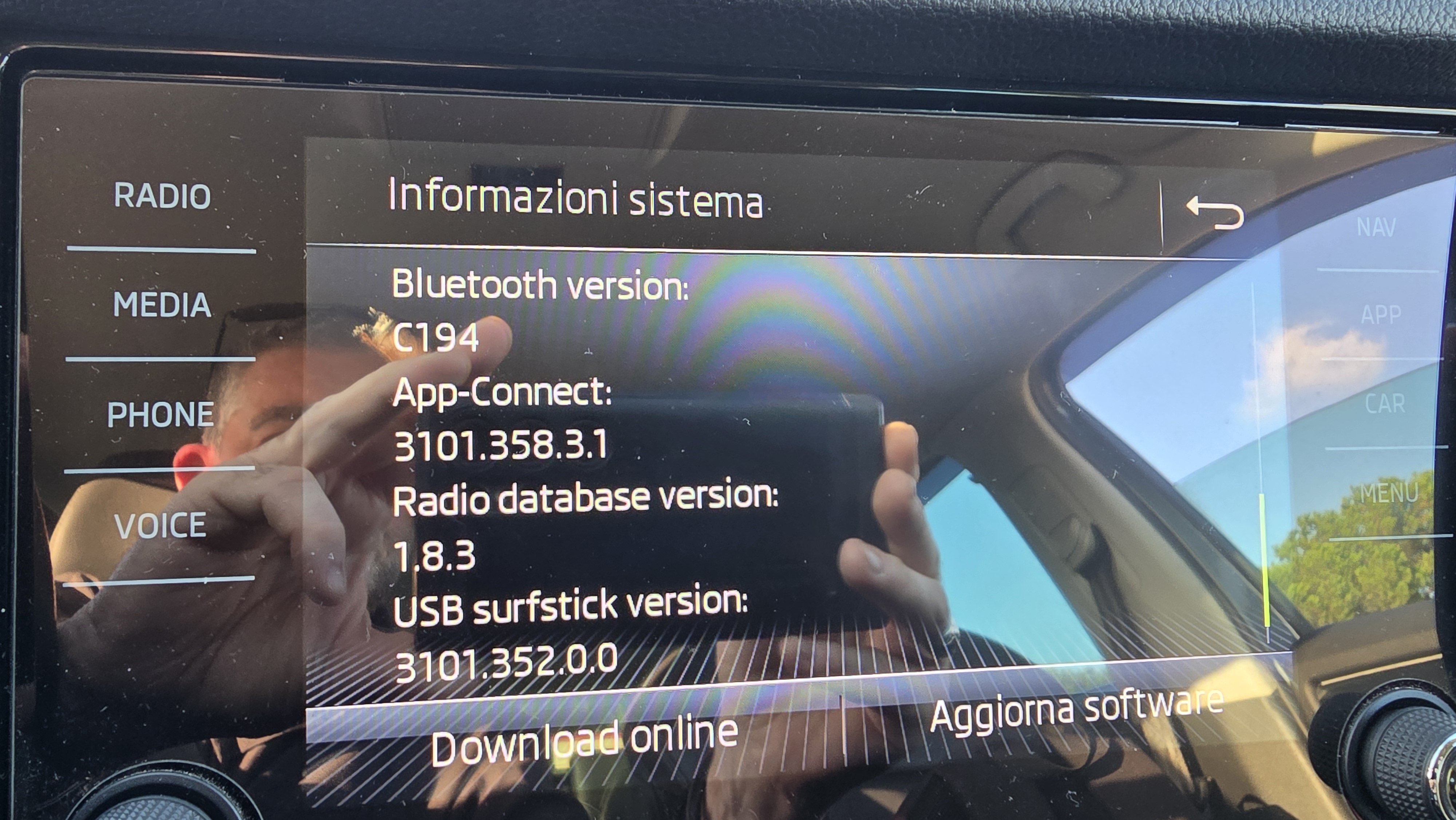

On 14/10/2025 at 11:11, KodiaqBear2017 said:
Hi, I'm writing from Italy.
Thank you for this precious support channel!!
After an app update, I'm having a connection problem between the infotainment system and the "MySkoda" app (I had already renewed all the services 😭 ).
The dealership told me it's definitely an update issue, but they have to keep the car for a whole day, and it's a big problem for my job.
Can you help me, please?
Here are the system screenshots. Thanks!!!!!
Hi everyone! Can anyone help me with this version? 😰

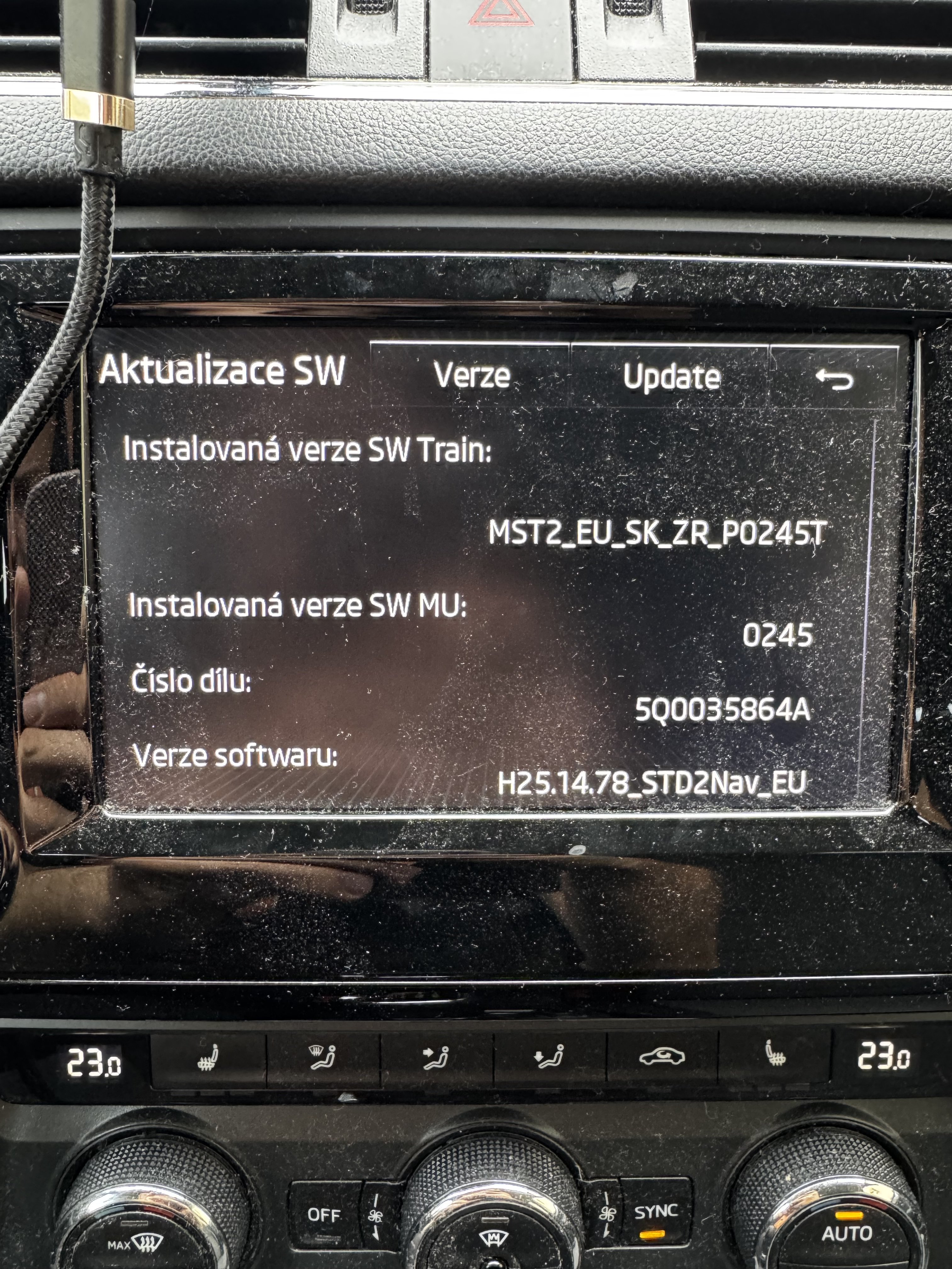

@pab567
Firstly, check your PMs for download links.
Secondly, how many times it must be repeated that:
  1. None official firmware update activates new features, e.g. SmartLink
  2. It's NOT possible to upgrade from 02xx to any other soft than 02xx, from 03xx to any other than 03xx and from 04xx to any other than 04xx without patching unit first.
  3. To patch the unit you can use MIB STD2 Toolbox.
  4. Units with OEM navigation (two SD slots) can be patched from SD.
  5. Units without OEM navigation (single SD slot) can NOT be patched from SD, they must be reworked on bench as some files must be manually replaced in EMMC.
  6. To use MIB STD2 Toolbox you also have to enable developer mode in adaptations.
  7. to upgrade from 02xdx to 03xx or 04xx, or from 03xx to 04xx, you MUST modify metainfo2.txt
And pls, don't ask me how to use MIB STD2 Toolbox or how to modify metainfo2.txt - I give you a fishing rod, not a fish, you have to use your brains (and Google...)

Dear, @pab567 With the new "MySkoda" app update, the system finally connected and reactivated. The update issue still remains, if you could please help.

Thank you so much!!!! @pab567 I'll try it now!

Thank you so much, @pab567 ! Everything was perfect!
