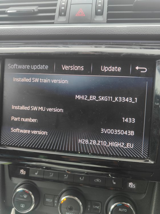

can anyone advice please if any updates are available.
hmi version: H28.28.210_HIGH2_EU
GUIDE MODEL 28.28.82
SOFTWARE BASE: H28.28.210-201809271437.
THANKS
THANKS
@pab567 CAN YOU HELP PLEASE

G11 latest 1447 what i have @caraushv
Edited by Cairus
@Cairus could you please help sharing it . Thanks

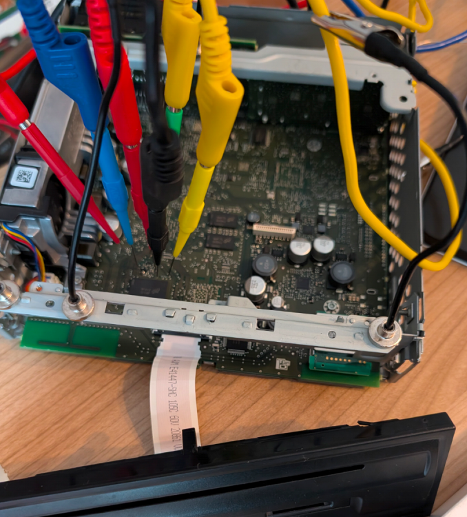

You need a modified meta file. Then run Swdl manually. First, select everything and manually deselect Emergency Main and CPU. Perform the update. That should all work, then reinstall the full firmware. Emergency Main and CPU should then also run. You can also perform a firmware Train JUMP upgrade without Toolbox.
Now you need QNX...

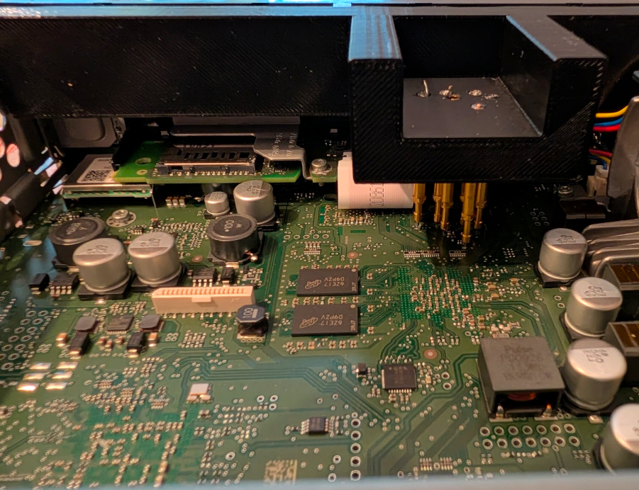

I developed my own contact method,see Picture With black frame.
If the emergency menu appears, you can still try using a pin clamp and PuTTY.
