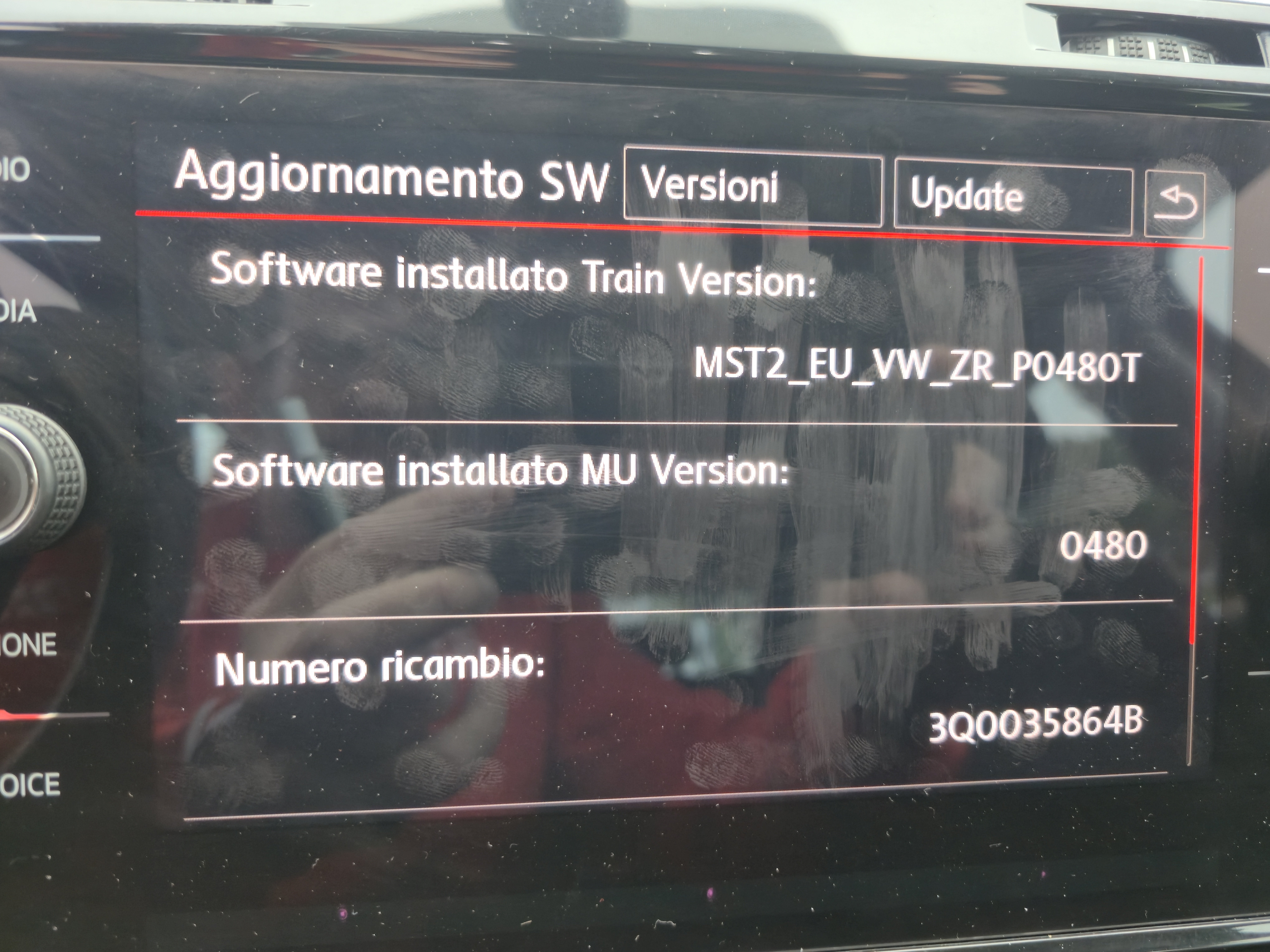

Update to 480t done.
Aside from just saying I have the 0480t software installed, nothing has changed.
Everything is exactly the same as it was with the 363t, and the update took about 2-3 minutes to complete, and I only noticed that it updated two items: Bluetooth and another one I don't remember. The skins haven't changed, as I thought they would with the new graphics. I'm starting to think my 0480t software was a bit dated and incomplete. I don't know what to think, but the update seems to have gone well anyway.

This means you have done something wrong. Use Manual SWDL and select all but emergency in Main and emergency in CPU.
