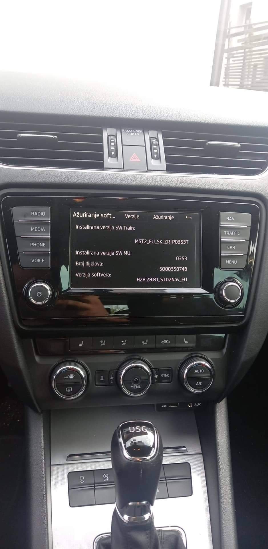

Is there update for my Octavia MK3 2017 Amundsen
Thx in advance
9 minutes ago, SasaBGD said:
Hello All,
Thx in advance
Yes to 0369, I will try to send link soon to you.

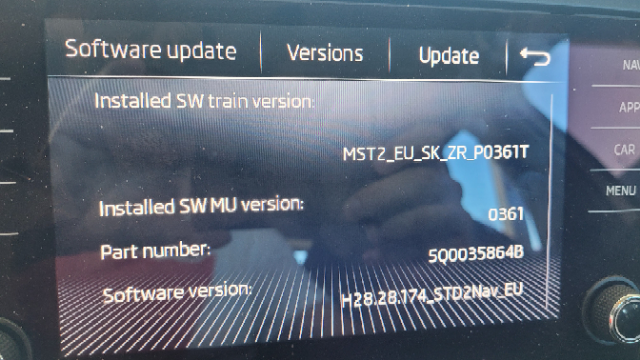

I did upgrade from 361 to 369. I had few open points so maybe someone will need it.
1.unzip in root of SD (if u keep in folder it will not recognize)
2.Format FAT 32 with 4096 cluster size (you need smaller SD card ...e.g. 8Gb)
3.You can keep engine on or drive (start before upgrade)
4. approx. 30min
5.no visible change 361 vs. 369

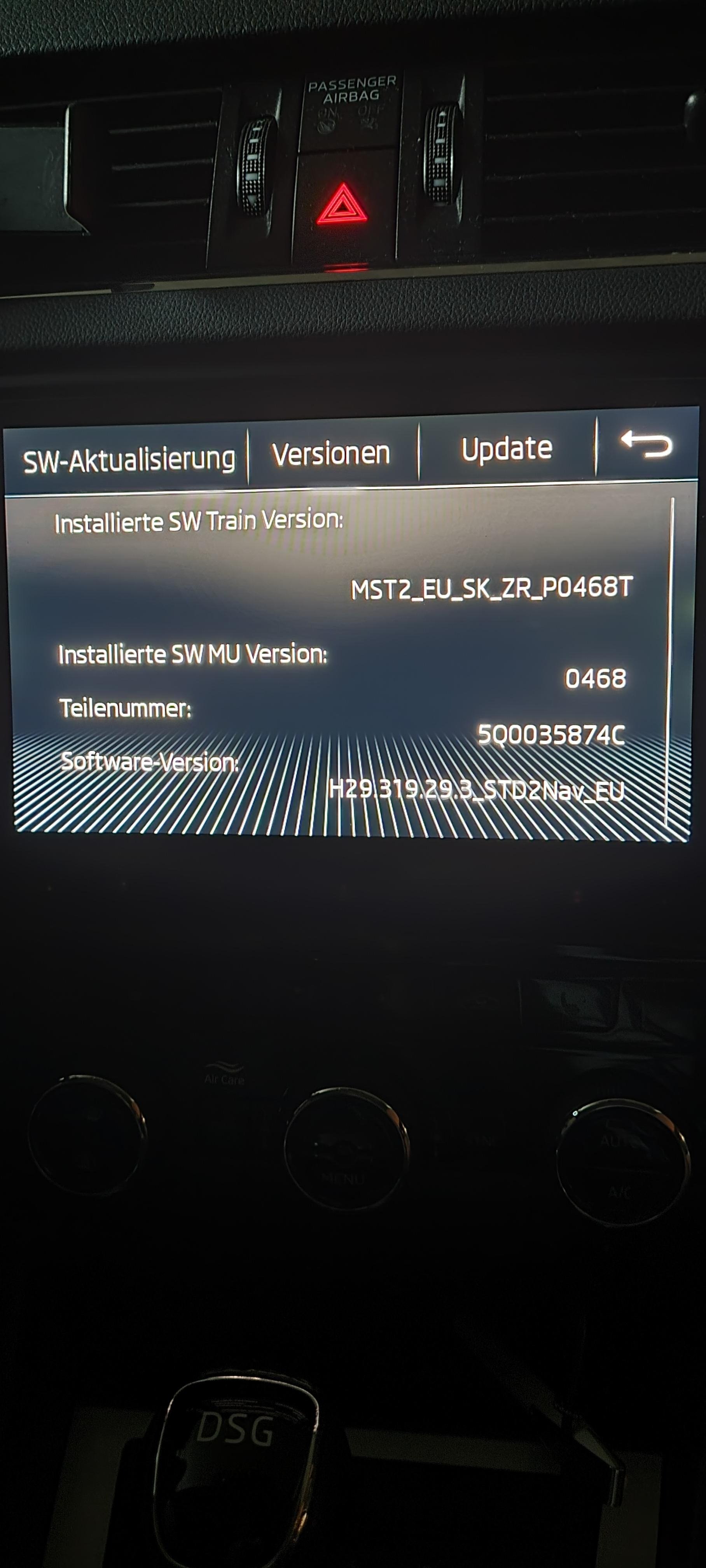

On 16/09/2022 at 18:32, gabileata said:
CAN SOMEONE HELP ME WITH UPDATES TO THIS SOFTWARE, PLEASE
You will need to post image of your Software Train, hold down menu/setup button to enter the hidden menu.
Odds are it's 0480

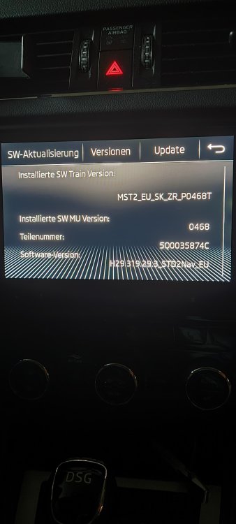

1 hour ago, gabileata said:
THANKS FOR THE ANSWER, I THINK THIS PICTURE IS GOOD.
PM Sent
