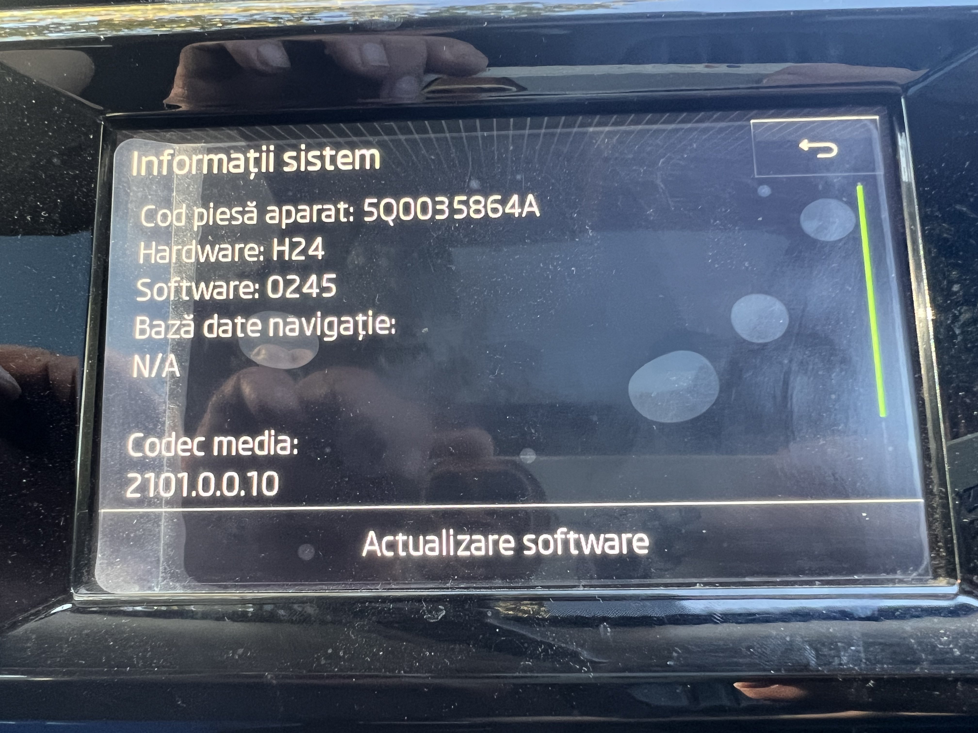

Hi, could anyone tell me if there is an update available for this? And can i install and run maps on my Navigation?

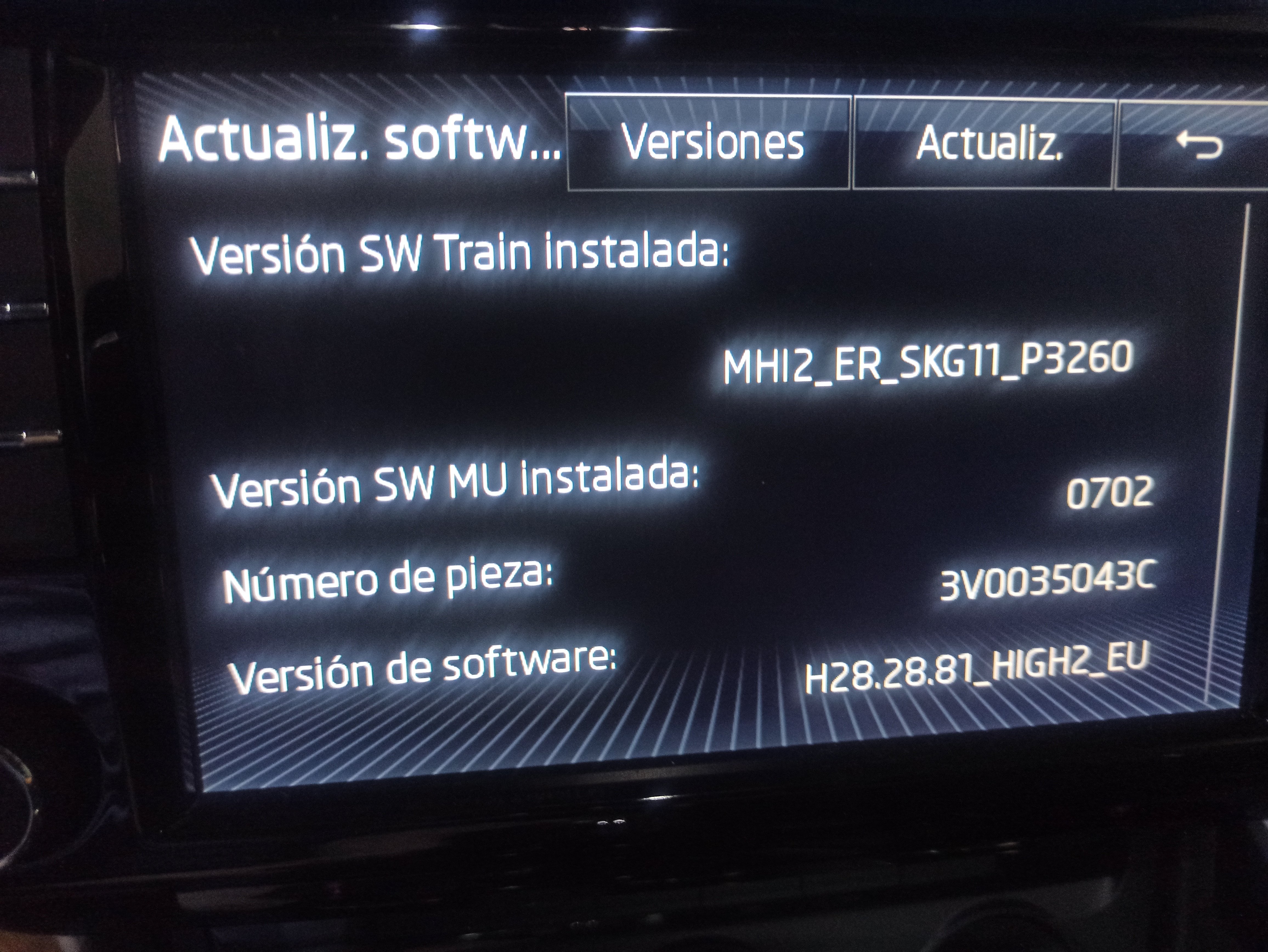

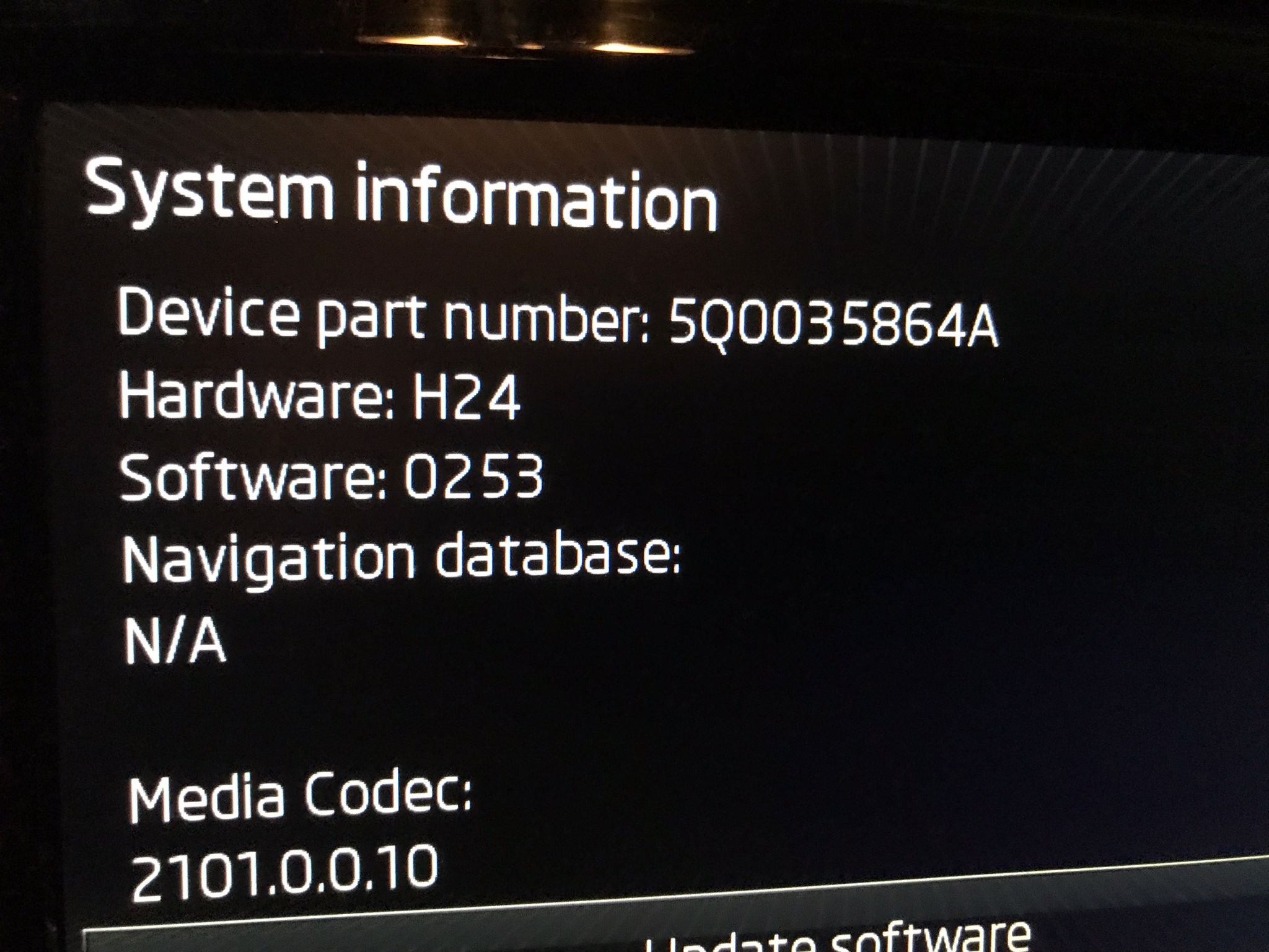

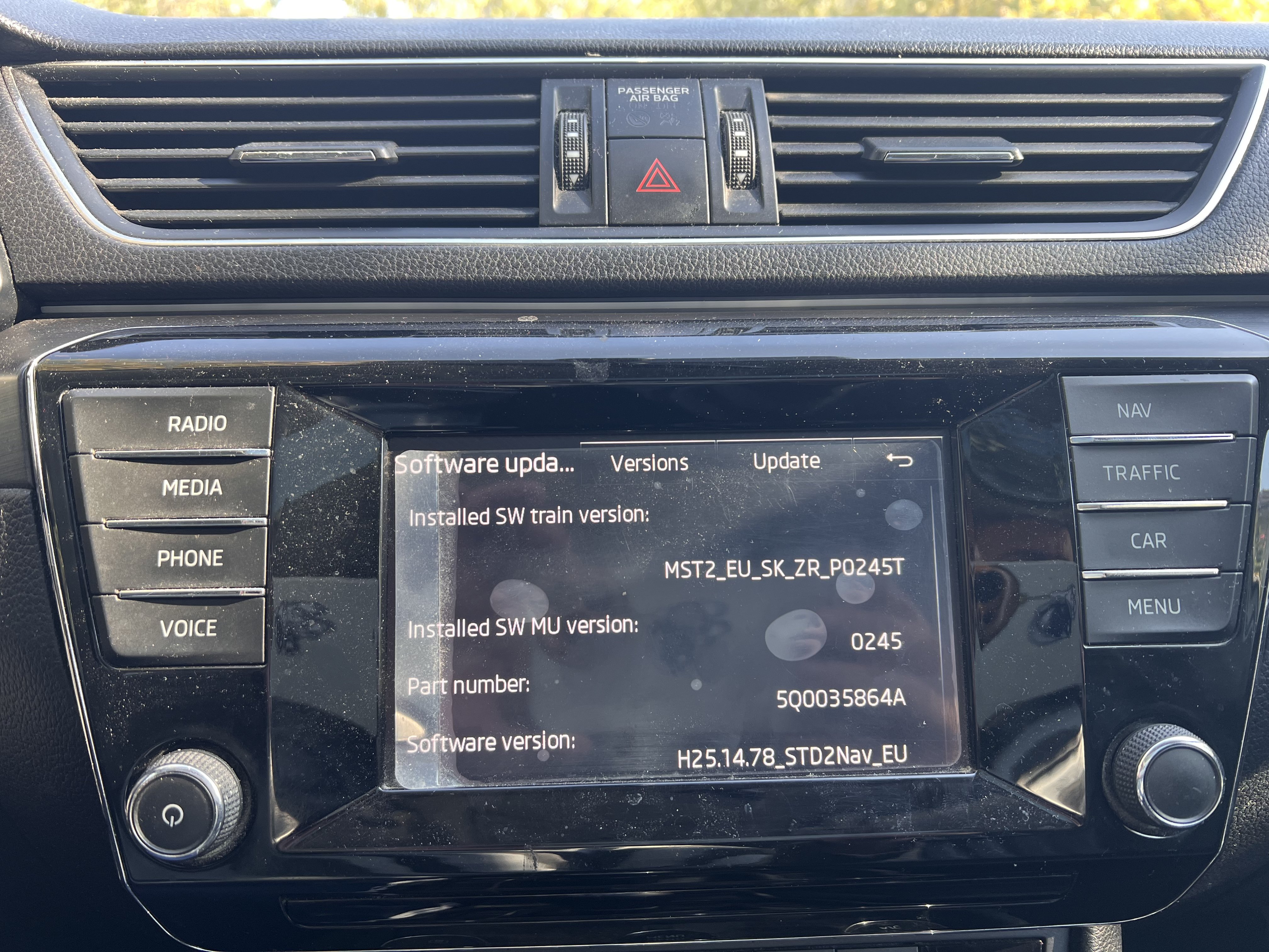

You should press and hold down your menu/setup button for about 10 seconds or less to enter the engineering menu with the Software Train value in.
Also take a picture of the front of the screen with buttons, if you don't have a NAV key, then odds are no you cannot load maps.
I have NAV key
1 minute ago, Pitu said:
I have NAV key
Very good, you can update firmware to 0253
As for maps, you may need it activated, but you will need to get a Skoda map card as they have an ID embedded that the car has to read, or it will not allow maps to load.  You can pickup these cards on market websites for not too much money.

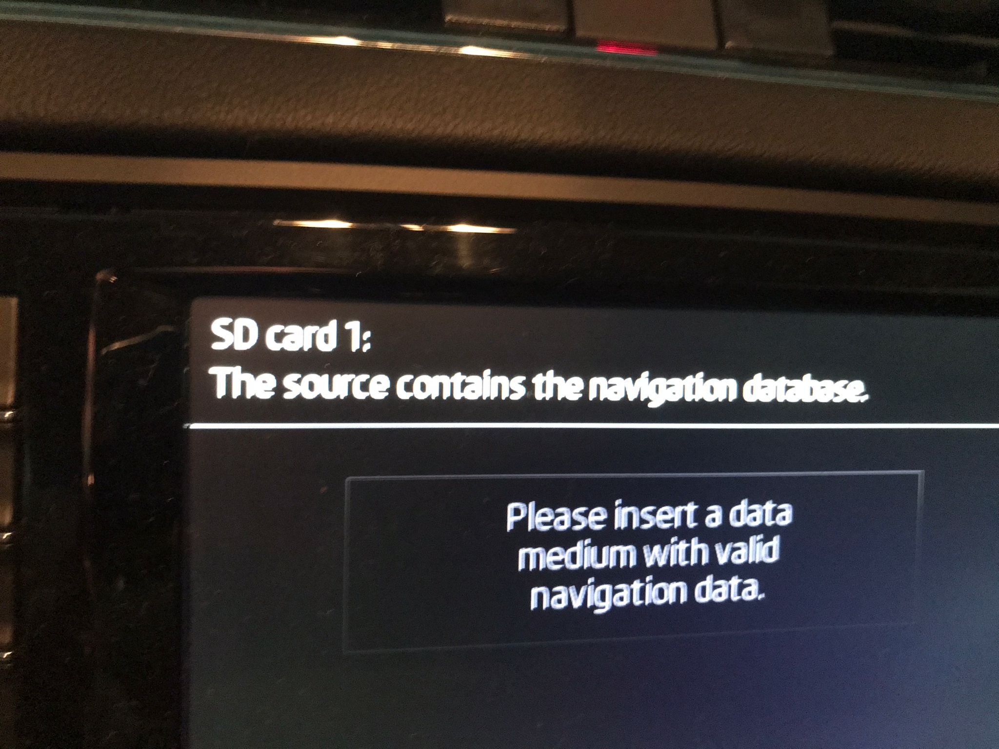

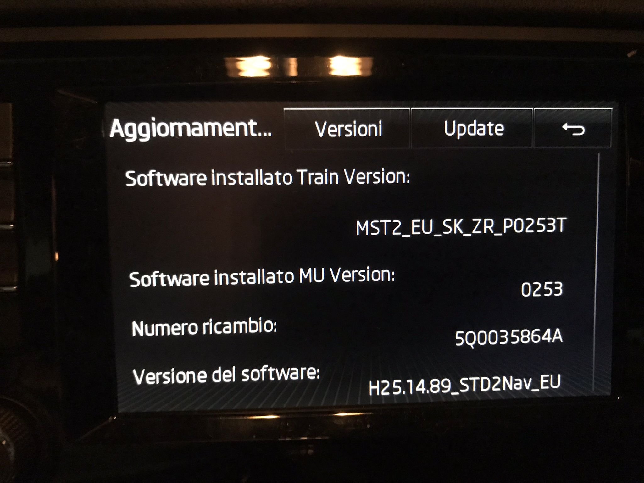

I updated the firmware and now the nav is not working..I have the original sd card but the nav won`t start
I updated from 241 to 253555792987_ImmagineWhatsApp2022-10-20ore14_40_21.thumb.jpg.339bd775a638a1f53a22e5c1e24d9bd4.jpg
You should post or translate exactly what you see on the screen when you try to load navigation.

Might be wise to format and download a copy of the maps again.
Did you update firmware with map card in the car?
no, i used another sd card and i put it on sd1 where usually the maps sd is. ok I will try to format the sd and since i`m there.. i`ll put the newest maps.  hope will work. what is new in this firmware version? or is just faster? Thanks again
Good luck with that.
There's no changelog with a firmware, we can only guess as to what they fix.

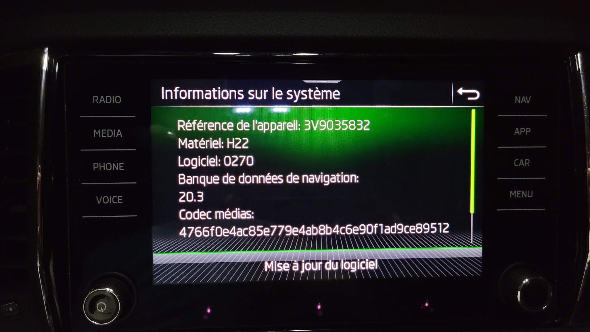

Hello guys,
is there any updates for my car ?
Thanks a lot for the work !

Press and hold Menu button to bring up engineering menu with Software Train information.
it worked now after formating. Thanks again GBU
