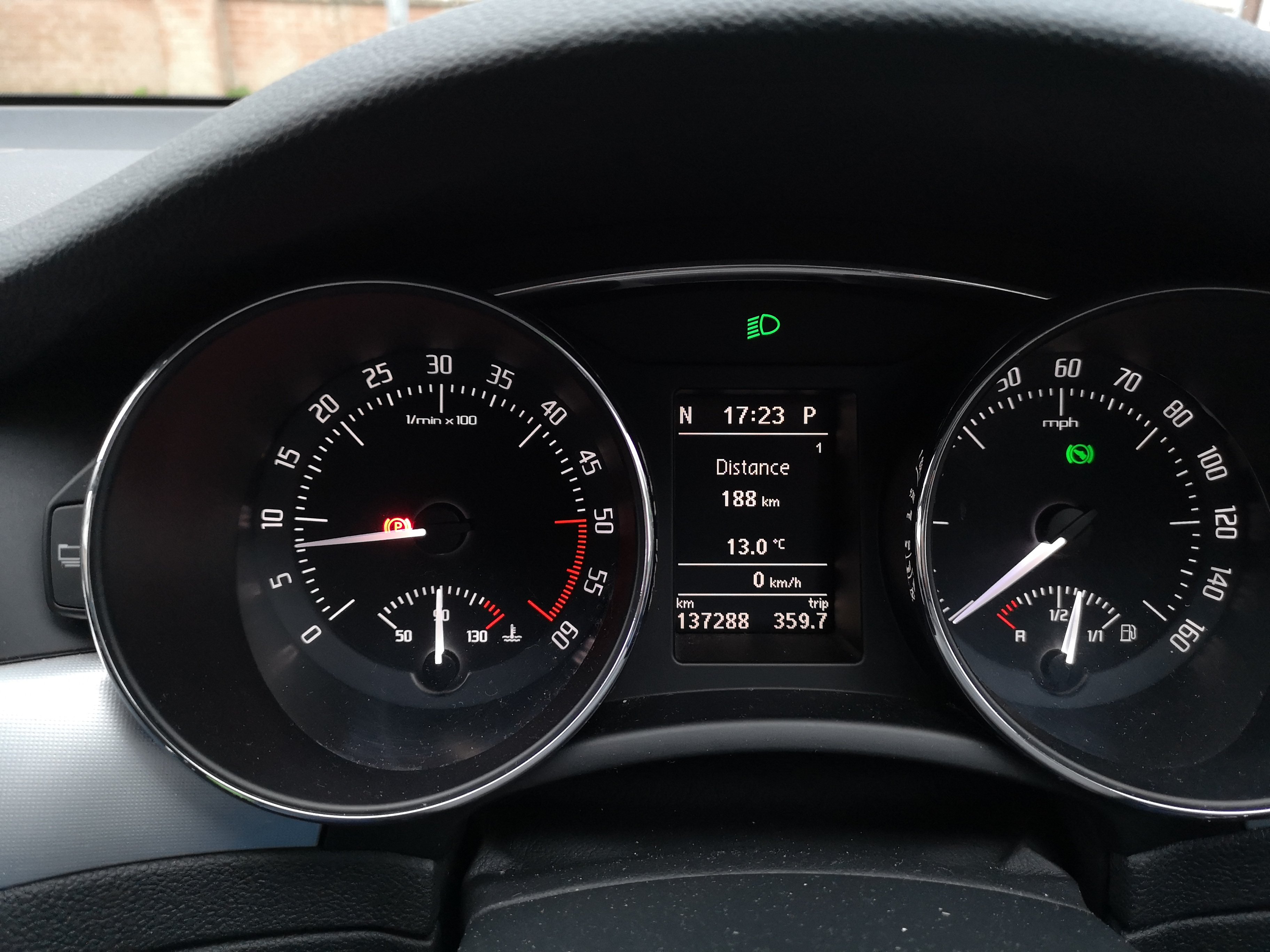

As above, anyway I can get the Maxidot on a 2011 Superb Elegance to display the speed?
Probably just needs the country changing using vcds or similar 🙂

Sorry, I probably didn't make it clear. There is no option to display speed at all at the moment 😞

It should be there all the time, below the MFD display. It'll default to km/h on UK cars.
If you go into settings and check 'Alt. speed dist' it should permanently show the speed in km/h where the temperature normally is.

On the Superb both temperature and speed are permanently displayed.

Ha, it's so small I didn't even notice. Is there anyway to have that in MPH? And bigger like other VAG cars?

Yes. As I said earlier it "Probably just needs the country changing using vcds or similar". ;)

The country is Australia, Km/h will disappear from the display but as it can be displayed when needed it's not a problem.  The car just has the ability to display Km/h
You can change to Australia or World.

Looks like it can be changed to Australia with Carista. Will changing it affect anything else, liek the lights or anything?

No. You still have to change to "tourist lights" for RH traffic.
It might change the odo to km rather than miles plus a few other units. You should be able to go in to the settings in the maxidot and change them all back to UK units easily enough which I think reverts the odo to miles :)
