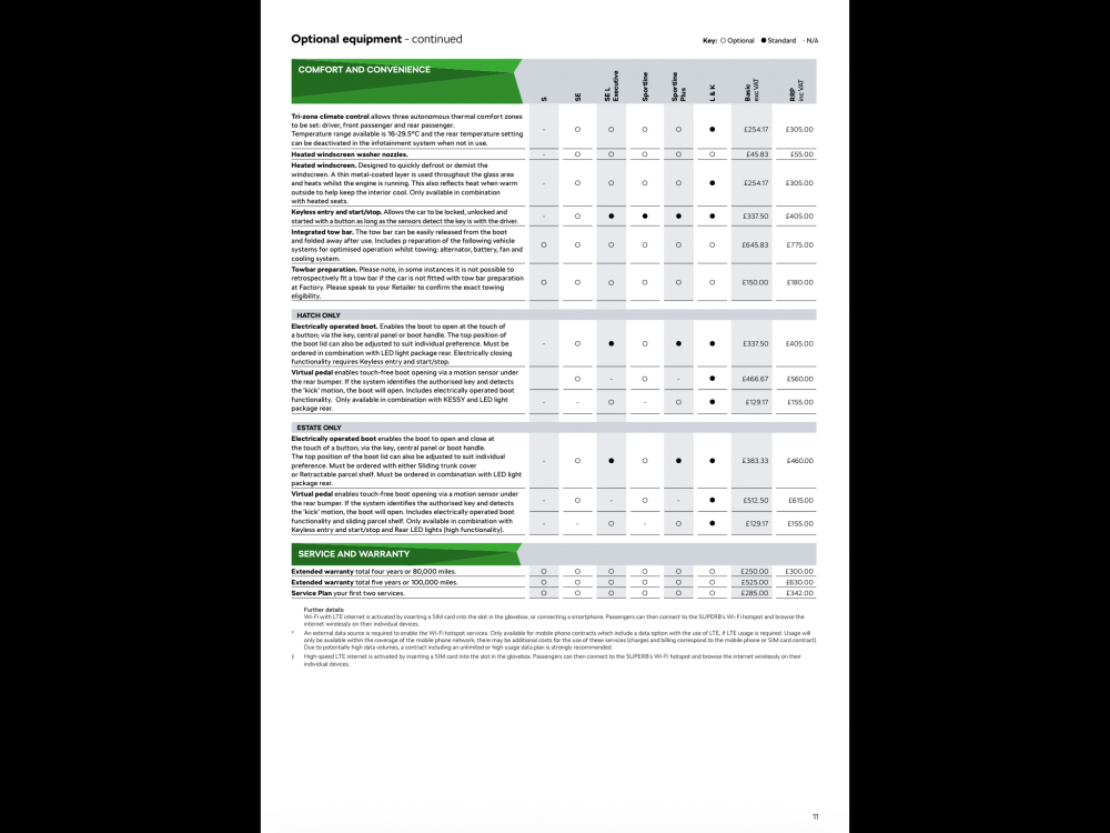

I have an L&K TDI 150bhp DSG and it has a rated nose weight of 90kg, I have also looked at the Estate ratings in the most recent brochure and the iV model is the same.  Also in the brochure the iV models don’t appear to be much heavier than their equivalents.  In fact their Gross vehicle weights are actually lower which is weird considering the extra batteries/hardware.
