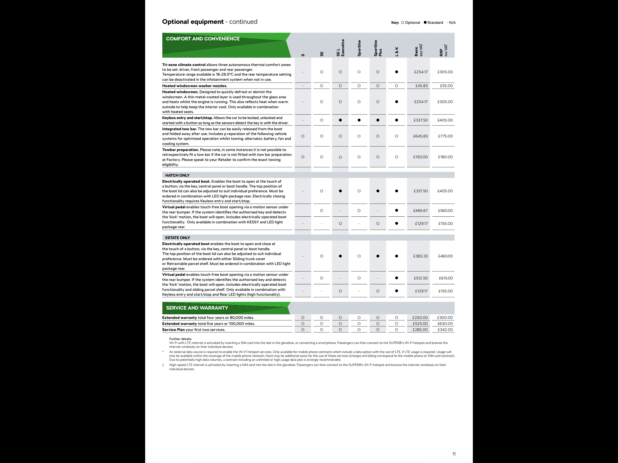

Re “what do you get for factory fitted towbar”, the attached is from the 2019 price and options list, towbar is about a quarter of the way down the page
I didn't pay anything like that amount, and the dealer agreed to pay for the prep. And it's a detachable Witter towbar.
