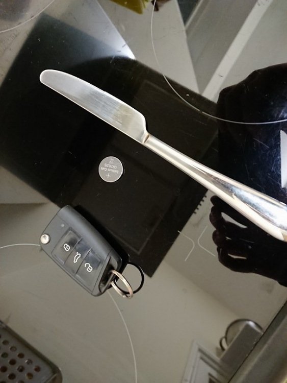

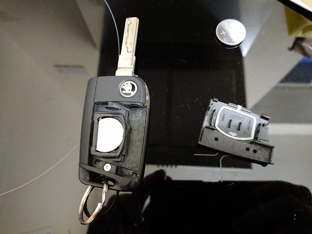

Just get a new 2025 battery and DIY. 2 minute job easily done. Did mine yesterday no problems.
Did my 2 yesterday, very easy 2 minute job. IMG_29022020_180814_(608_x_810_pixel).thumb.jpg.e98204d79e2f613e3b4c256a7964fc9c.jpg
IMG_29022020_180821_(1080_x_810_pixel).thumb.jpg.dcd7c477fca25511e80a244830e84779.jpg
Just make sure you have the old battery out and new one back in within a few seconds, not sure what new vag keys are like but our old passat fob it needed to be within 20 or so seconds.

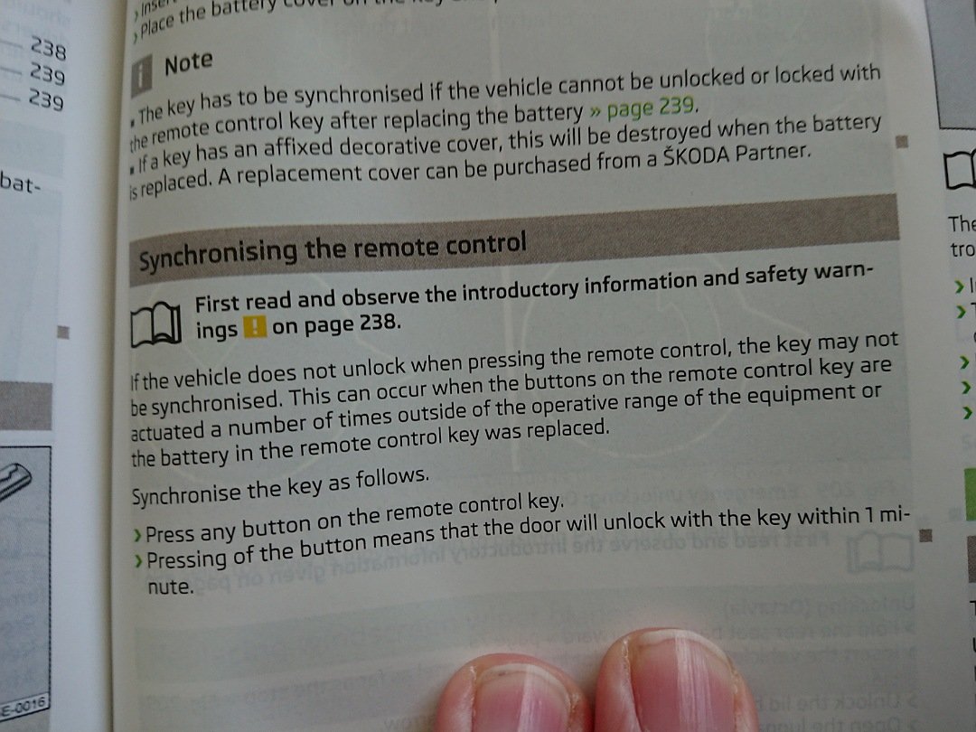

It certainly was the case of older vehicle remote keyfobs, whether its still true of the OP's vehicle or its just recieved wisdom I dont know but the vehicle handbook will certainly confirm.
Taken from my octavia 5e manual.
IMG_01032020_131900_(1080_x_810_pixel).thumb.jpg.631a648416225c4c2c91a7d532ab8b31.jpg
