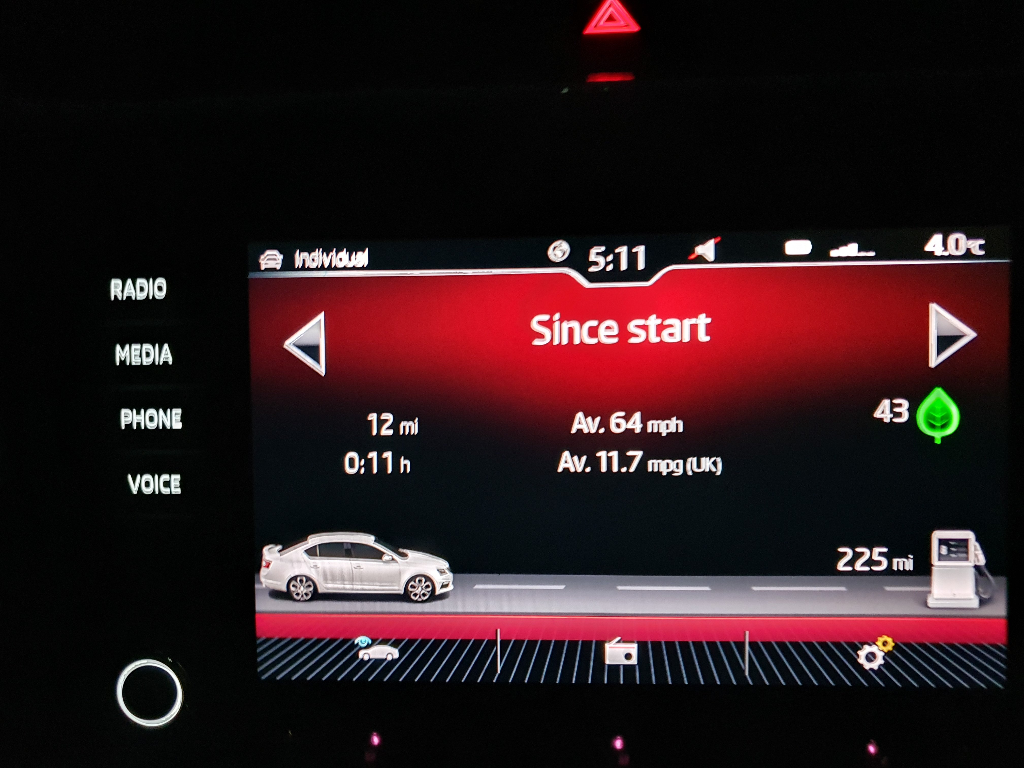

I (key worker status) could take it for my commute once a week if the battery needs conditioning, possibly an Italian lineup at the same time 🤔🤔🤔 just to help you out mind
Here's my normal commute for your consideration
