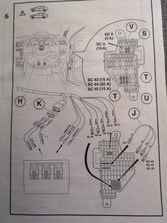

On the OE wiring everything is run from the internal fusebox. It came with a cat-tail whip (can't think of a better way to describe it) harness to fit on the back of the fuse panel to supply power to positions 43 (15 A), 44 (20 A) & 45 (15 A) which as far as I can tell are for the +12 V supplies to the trailer. It additionally uses pins 8 & 9 for power to the control module. One of those will be the power supply for the trailer lights too, I'm just not sure which one.
Wiring colours for the 5 wires are:
  • Fuse 8: Black/Green
  • Fuse 9: Black/Red
  • Fuse 43: Purple/Red
  • Fuse 44: Yellow/Red
  • Fuse 45: White/Red
I have some recollection that one of the three bigger lines bypasses the control unit and runs straight through to the trailer socket but I can't remember which one it is; looking at the wiring diagrams it appears that this is pin 10 (it's the only one missing from the assignment to the 13-pin socket on the diagram).

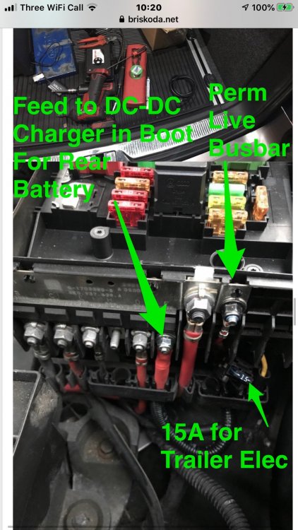

westfalia is similar but different. number 4 on the main loom is fed by an additional kit which is basically a relay, these then feeds pin 10 on the socket. i think i  will tap into the fuse nox for the premanent live. should be fine.

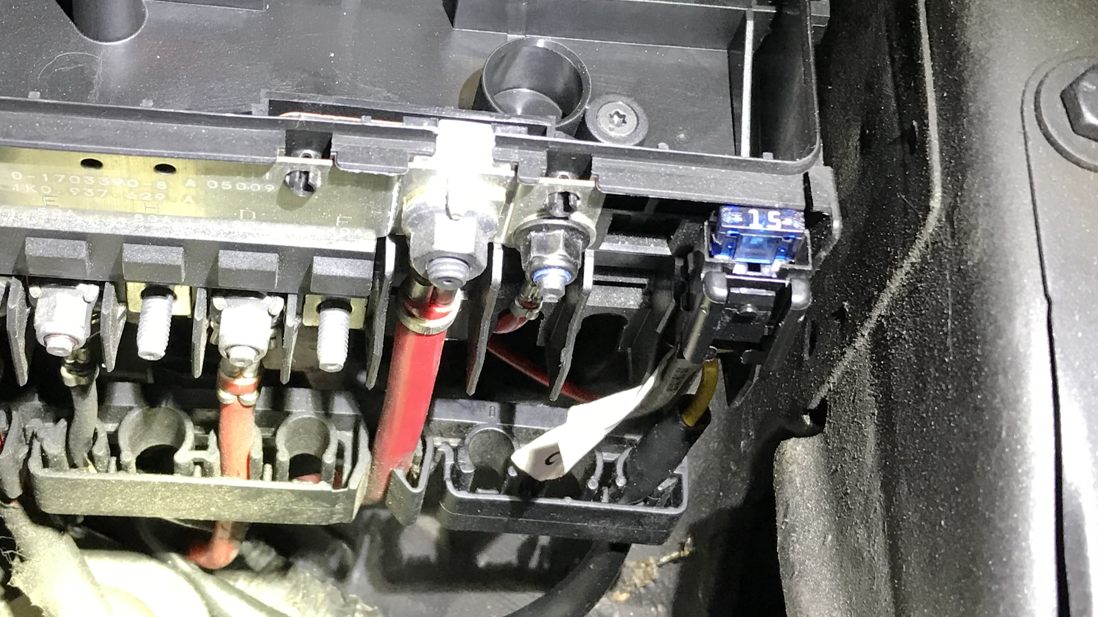

When I got rid of the fixed tow bar fitted to mine for the removable type I ordered the Westfalia electrics to include the additional feed with relay like yours. I took the cable to the SB fuse box by the battery and used the busbar with the 15A fuse tucked in like seen in the photo.

The standard electrics went to the SC fuse box on the side of the dash for the 3x power take offs mentioned within the thread.
the feeds to the SC fuse box is also shown below (to follow as picture is on my laptop) so you can see what the rails do.

Electrics were mostly straightforward but a bit time consuming. Trailer module goes on the left side of the boot, inside the trim panel; wiring harness runs from there across under the boot lip and up the driver's side to the fuse panel. Whether you go OE or Westfalia this bit is the same. If your car has factory towbar prep it's a bit simpler since you don't have to run the cable down the driver's side of the car.

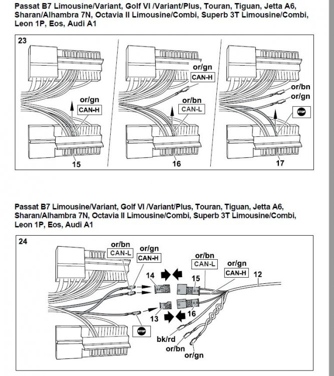

At the fuse panel you have to hook in the 5 pins as outlined above, and there's a bit of swapping around of pins on the brown BCM connector to add the trailer harness to the CANBUS. As you'll have seen in this thread the Westfalia is a little bit different.
Whatever you go for, I'd suggest getting something CANBUS aware: in this case the other modules in the car are aware that a trailer is hooked up (provided you do some coding as per the Ross-Tech link I posted above). You get deactivation of rear parking sensors, activation of ESP towing mode, alarm activation if the trailer is unplugged while the car is locked.

My pin 10 switched live comes from the internal fuse box. It's relay powered. Plan to connect direct to battery at some point as worried that it will overload internal fuse box but will be OK for now.
I wouldn't worry about it provided it's on a bus with sufficient current capacity. As I mentioned earlier, the Skoda OE setup uses the internal fusebox for that supply.
