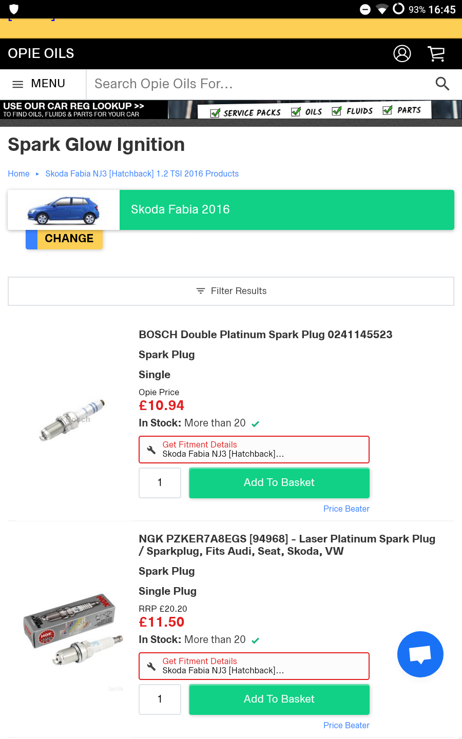

Try Opieoils.co.uk
They have a spark plug finder tool.
Thanks xman
Forgot to mention you can get up to 10% off if you use "Brisk" discount code, they often run other discount codes shown on their home page which might offer more.
Edited by xman
Have used Opieoils before for bike oils plus service parts....the plugs they offer for the fabia some have a different thread length which isnt good, with bikes and the other cars Ive had you get a brand name + a grade no problem....usually this site gives you more information than you need.... so i reckon its been done to death but thats what forums are for, not everyone has the information to hand, but thanks anyway.

While opieoils quote PZKER7A8EGS, that is what is probably fitted but they have been revised to now be PZKER7BEGS which is still stock code 94968 for NGK.

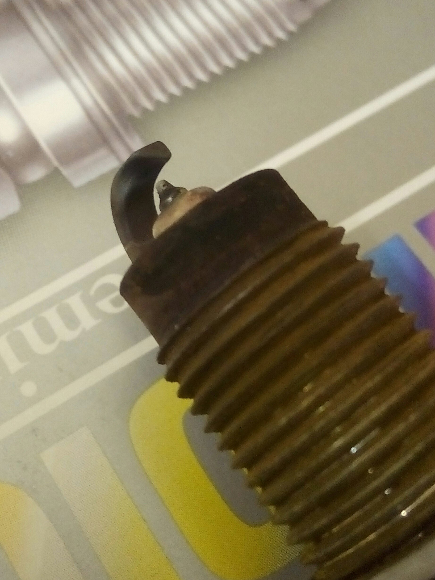

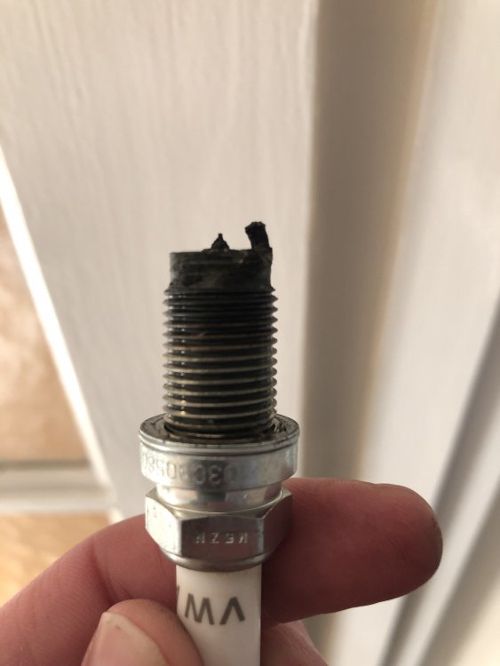

Not after cheap but good and reliable, have seen pictures of NGK burnt electrode.
@socks Have you seen pictures of any NGK burnt electrodes from plugs from a Euro 6 1.2 TSI,
or were these one plug out of 4 from a Euro 5 1.4 TSI 132kW Twincharger engine?
Dont know where they are from but the pics where in relation to Skoda.
@socks  If you look on google images you will see the majority will be from Briskoda and probably mainly posted by me.
Nothing to do with 1.2 TSI plugs.
eg

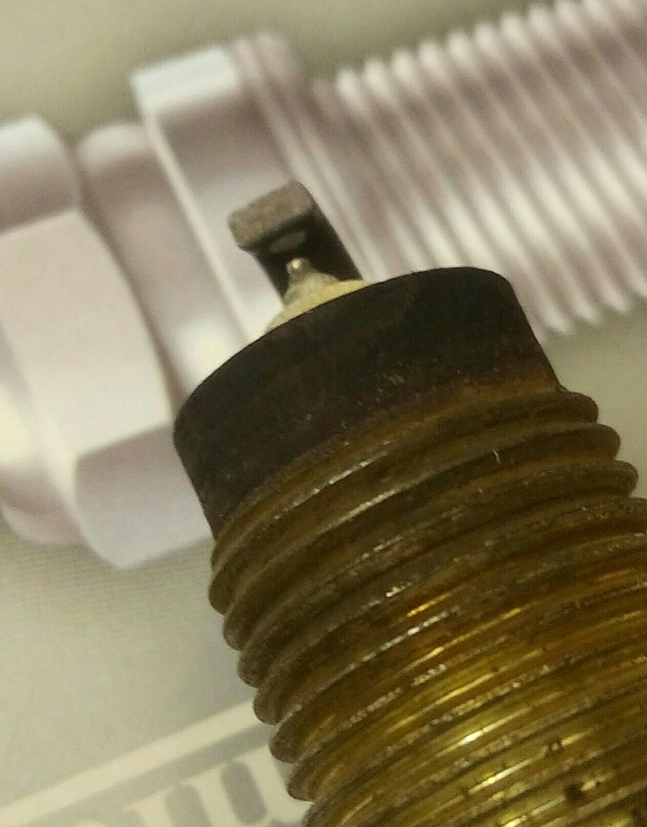

I've had good experience on two 1.2tsi EA111 (camchain) engines of NGK (They were Factory fit, dealer fit and DIY). Taken to 85,000 miles in both cases before changing, but better if had changed at 60,000 miles as Cylinder 1 and 3 in all cases had more significantly more wear than the other two and lost the welded platinum disc on the ground electrode. Tips (iridium alloy) were all fine.
IMO the advantage that the Bosch design of platinum/iridium types have is the ground electrode precious metal bit is inlaid into the ground electrode rather than just welded on top, so should avoid being wiped away.
Have just changed to Bosch double iridium in the Octavia at 140,000 miles. Should last the life of the car.
The other Fabia 1.2 tsi got written off at 120,000 miles by a dozy taxi driver.

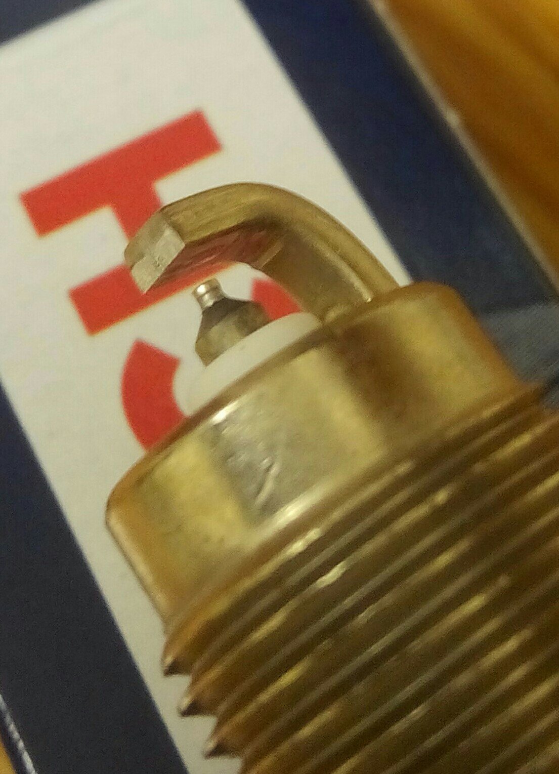

Here's some pics 85,000 miles 1.2tsi Ea111 cylinder 1 and 3 worn, 2 and 4 very good. I suspect due to ignition system employed in EA111 (waste spark ignition type) which electrically pair 1 to 4, and 3 to 2 but with opposite spark polarities.  Also bear in mind because of this, EA111 ignition spark plugs fire every rotation of the crank, on both compression and exhaust strokes. Twice as often as EA211 which has individual coil packs.
Bosch double iridium for comparison

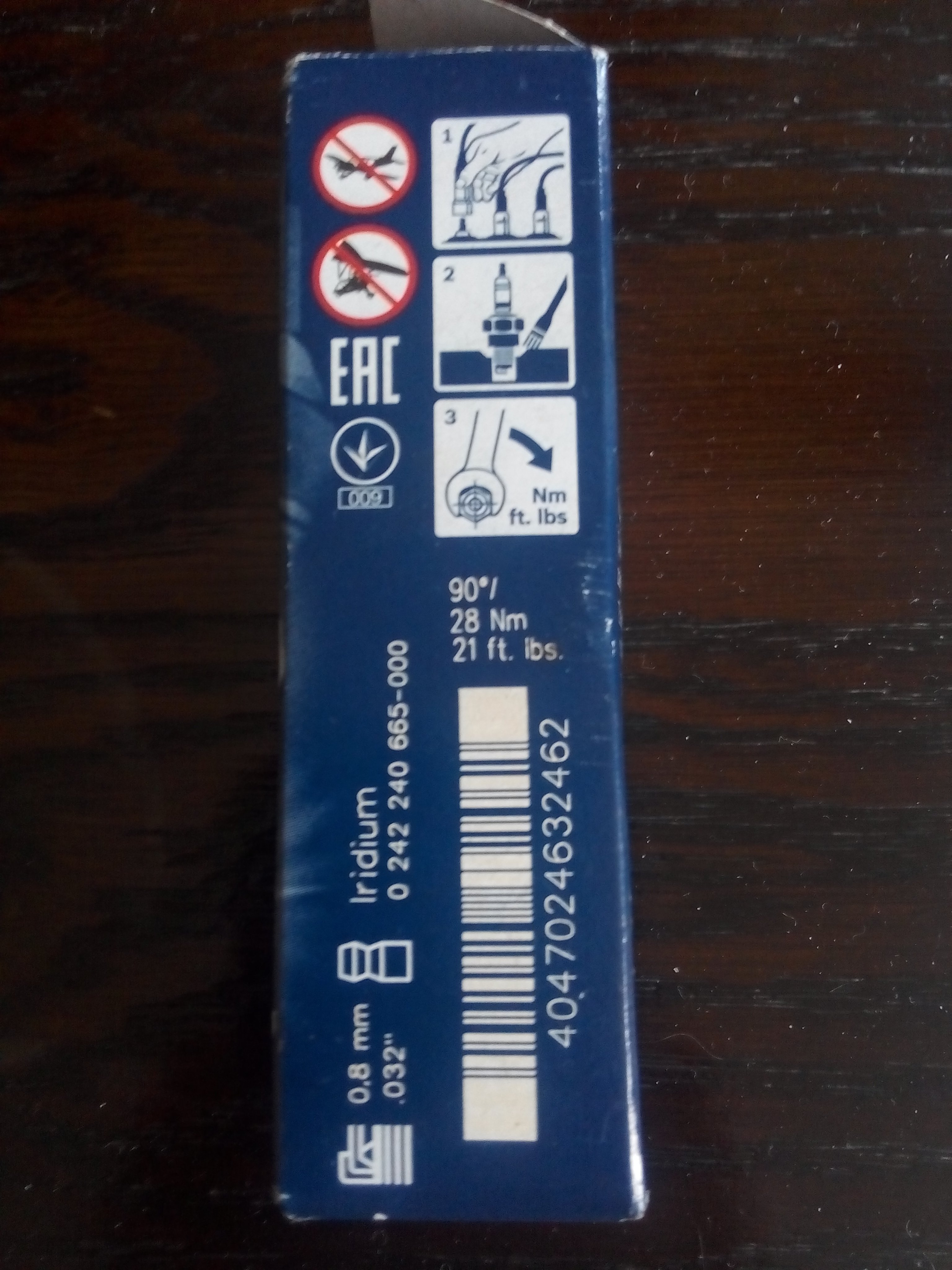

I have just installed new Bosch plugs in my wifes Rapid 1.2 NH3 - Engine code CBZB , but I cant find the correct torque for them anywhere , some say 22, some 25 some even 30 Nm, but what is the correct answer ?
Please help
And thanks in advance.
\Flemming
31 minutes ago, Computex said:
Hi,
Please help
\Flemming
Its on the packet.
This 1.2tsi plug has a crush washer. So the correct procedure for this new plug is
Cold engine
Clean seat on head
Spin in until plug washer mates with seat.
Turn additional 90 deg to crush washer.
Then 28Nm.
Or if fitting a previously fitted plug, skip the 90 deg bit and just 28Nm
Check on spark plug packet for correct instructions and values.
@xman My interpretation of the instructions are that the torque setting is 28Nm or 90 deg on a new plug from finger tight. No torque wrench necessary for anybody without.
Possibly, either method should be fine.
Just remember or be aware that the 1.2TSI EA211 engine's plugs have a thick flat and so "solid" sealing washer, so they just get torqued up as the washer does not get crushed when first fitted.
