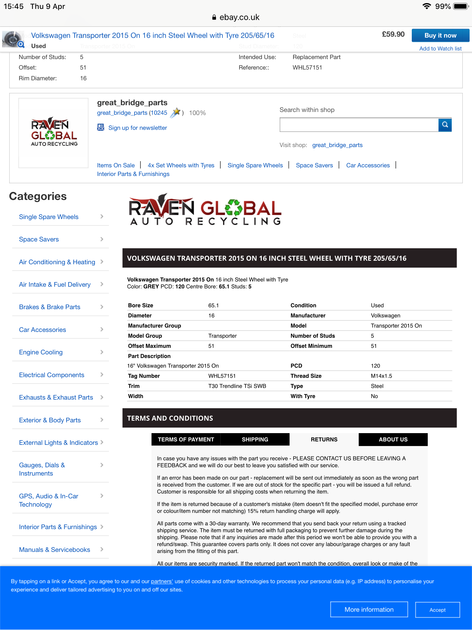

After some advice please. I’m after a spare wheel, preferably full-size but space saver would be OK.
I have 235/40 r19 wheels and wondered if pretty much any VAG group wheels will fit with the same centre hole size?
I’ve found a VW transporter wheel that has a 205/65 r16 tyre on it.
Here. https://www.ebay.co.uk/itm/352942383244
....which I think is only 0.3% difference in diameter to my normal wheels/tyre.... according to:-
https://www.tacomaworld.com/tirecalc?tires=235-40r19-205-65r16
So what do you guys think?  is there anything I haven’t thought of?  Will it fit?  I know it will look crap but I don’t care about that as long as it gets me home!
Thanks!
I don't think that they have the same stud pattern.
Edited by john999boy
Typo
Looking at the add the pcd and centre bore certainly look wrong.

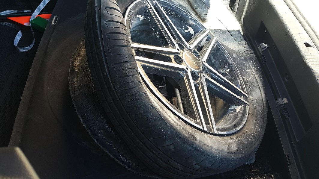

that size fits perfect ->
https://www.briskoda.net/forums/topic/442912-full-size-spare-wheel/page/2/?tab=comments#comment-5040470
during last two years haven't had to test on road,
original size 205/55r16 cancels Cruise Control, that weren't happiest trip -
~80km distance with spare wheels speed limit 80km/h

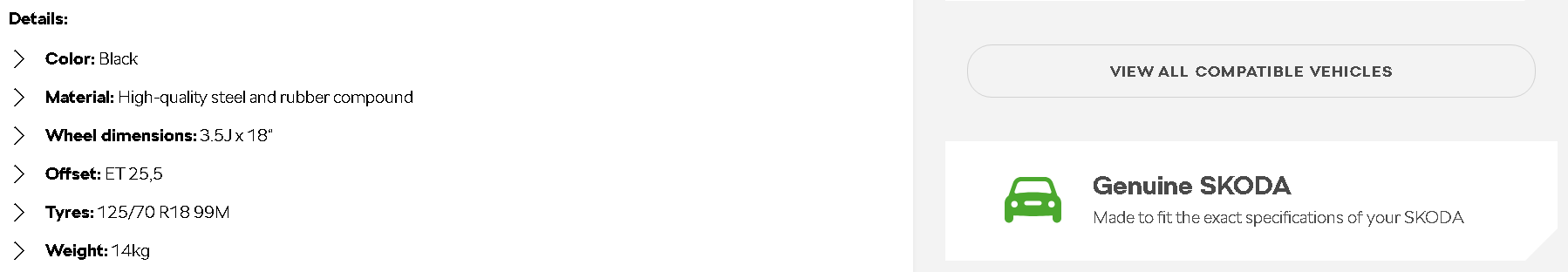

Would appreciate some advice on a space saver wheel for my Mk3 factory fitted with 17 inch wheels.
Has anyone experience with an aftermarket product like this or similar? Would it fit in an emergency situation?
https://www.thewheelshop.co.uk/product/skoda-superb-2008-present-day-17-space-saver-spare-wheel/
The stud pattern seems correct but dimensions aren't provided (I've inquired).
It's all rather confusing as the official space saver from Skoda for the Superb which costs £212 is an 18-incher, 125/70 R18 (my car has factory wheels that are 17 inches).
Don't let the fact that is different rim size worry you, the important thing is the overall diameter compared to the other wheels. Well, it is also important in case of fouling steering/suspension/brake components, but I do not think is the case with the sizes considered.

As you can see in the chart below, 125/70R18 has a much smaller outside diameter than the standard 17" tyre size on the Superb MK3. However, Skoda normally supply a 205/55R16 fitted to a 6.5x16 ET46 5/112 57.1 steel rim (from the Octavia MK3) as a spare wheel for the front wheel drive Superb MK3. Like the 125/70R18, the 205/55R16 tyre has an outside diameter that is much smaller than the standard Superb MK3 tyre sizes.

when i waited for 2023 Mk3.FL i were well informed it will come with unusable 125/70r18
and i decided made swap with my previous 2016 Mk3 full diameter 205/65r16
but one year later i got surprise, 16" don't fit even on rear axle
because 272/280 Superbs have bigger brakes(340/310) instead all rest (310/298) (front/rear)
now i have 205/60r17 on alloy
