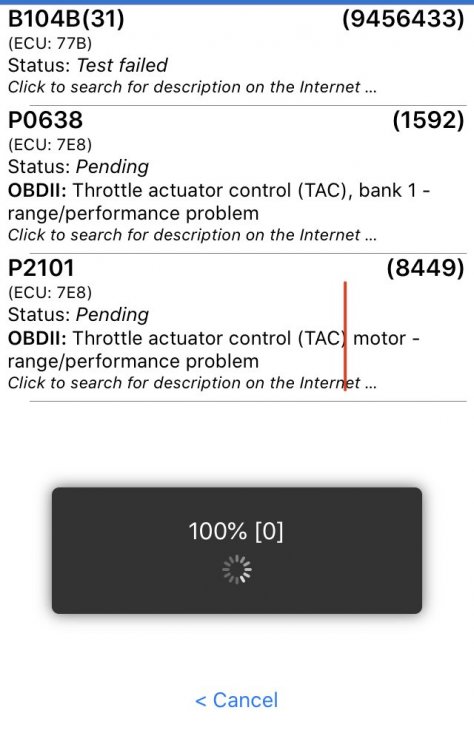

Throttle issues p0638 2101 Help!
My 2012 TSI 1.2 Roomster goes straight into EPC mode and is undrivable.  I’ve removed the throttle body and cleaned it and checked all the solder joints and cogs. All is ok. I’ve tested the double output Hall effect and it seems fine.
it seems that the turbo has been spewing hot oil at it for a while.
I’m willing to replace the unit if I can be sure that will solve the issue. Any ideas?
