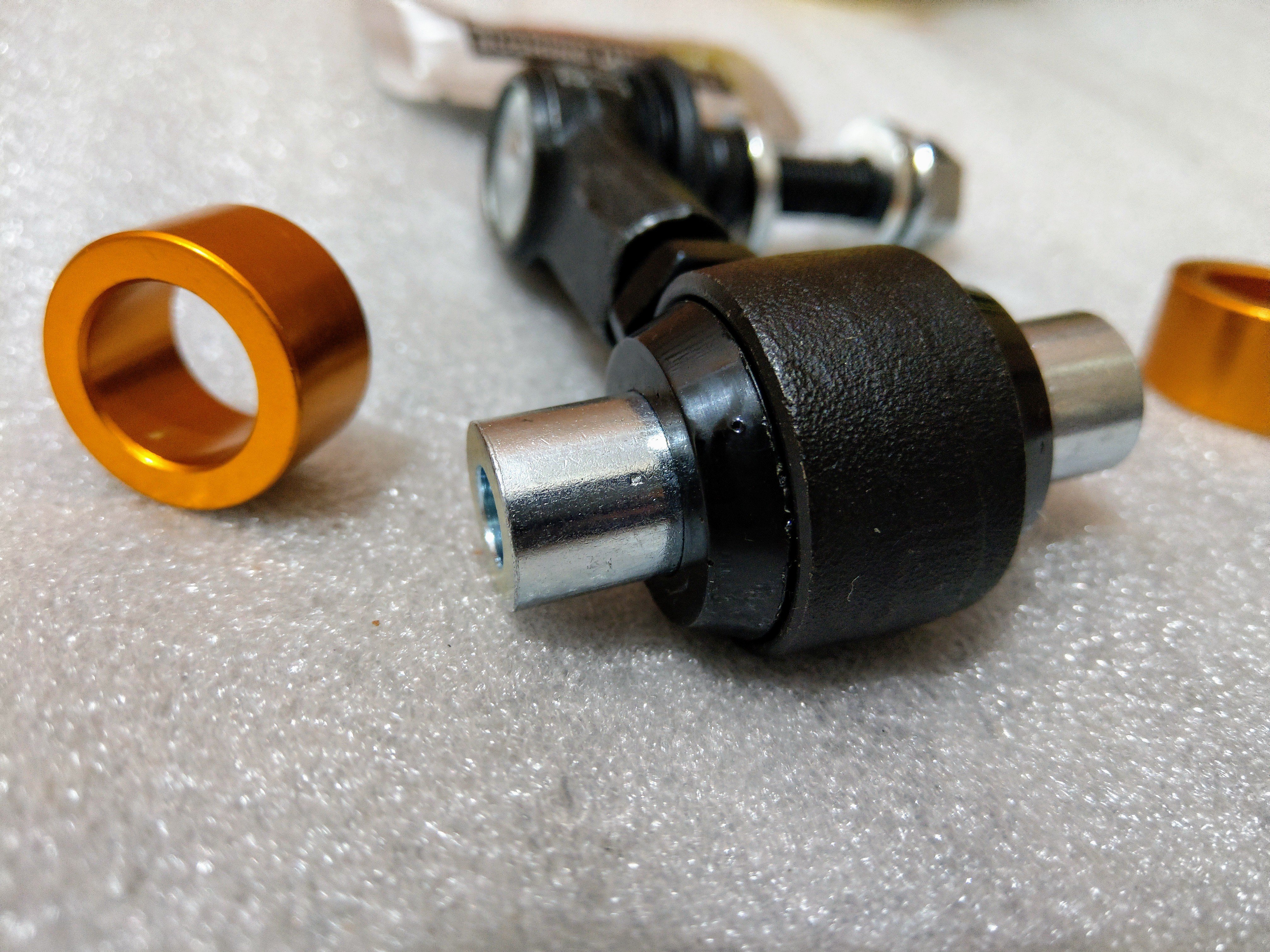

You are obviously using the existing plastic end links?
Would you consider an upgrade to the end links?

I've bought whiteline endlinks, just haven't installed it yet.
Unfortunately with the car lowered, there is pre-load on the sway bar, and it's evident with the "not perpendicular" plastic endlink position.
The whiteline ones r adjustable, perfect for lowered cars.

I think I'll wait to replace my stock ones if/when they're shot. I've read several aftermarket ones are noisy and it would annoy me for sure to hear new noises from the back going up and down the ramps on my garage and our neighborhood on a daily basis. I jacked the rear hubs up to the new, lowered ride height when wheels are on the car and it sits on the ground before tightening the bolts to remove some extra preload due to suspension extension and hopefully they will last longer than I'll keep the car for as was the case in the past, let's see. If they get shot I'll update this thread.
Let us know how yours do after some miles though, if they're quiet I could consider them :thumbup:

Yeap, just as fine as the day it went on the car. Granted I have put barely 2k km since then due to current conditions but nothing unusual has shown up.
If you don't plan on lowering don't bother with the end-links, they might introduce more issues than they solve. I've even lowered mine after the arb and kept the stock end-links and no issues yet (although this doesn't say much with such low miles still). If/when they go, they will be replaced as needed, it's an easy DIY job anyway.
