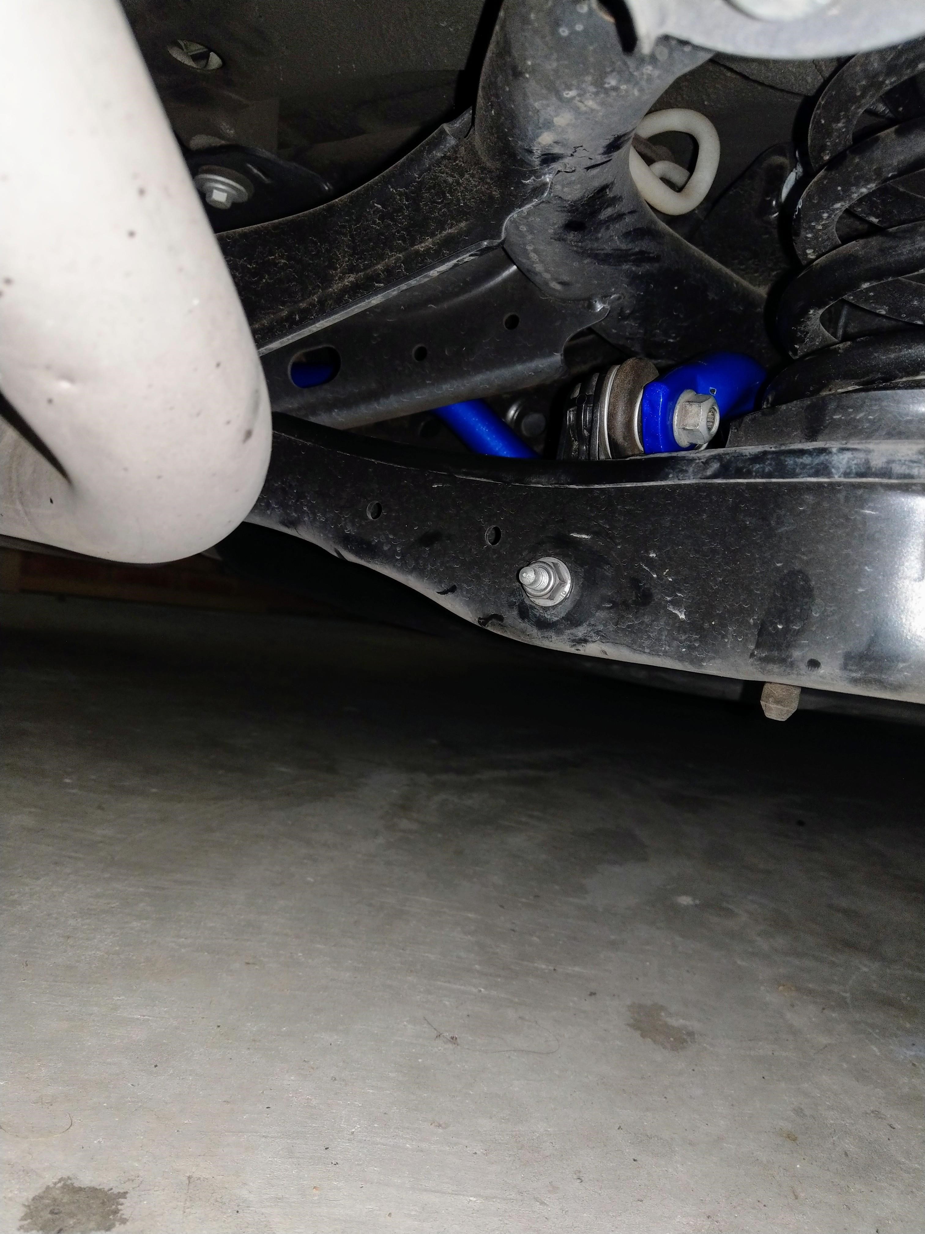

got the Hardrace Rear Sway bar installed today, and as expected - the car feels a lot more tighter, less wallowy, and a lot flatter going around corners 🙂
woOot
although the workshop who installed strongly recommend upgrading the swaybar end links too as the factory plastic ones will eventually fail/break because of the heavier duty sway bar.
i'm looking at getting either the:-
- ECS Adjustable Rear Sway Bar Endlinks
or
- Whiteline Adjustable Rear Sway Bar Endlinks
or
- SuperPro Sway Bar lInks
@newbie69, @Bejam - did either of u upgrade the end links?  if not, planning to?
some pics, but really, there is not much too see........

Another happy driver, we've definitely started something with all this arb-mania!
Your garage guy is not entirely correct though. The stock end-links are fine if you're still on stock suspension (ride height), it's not the stiffer bar that might wear them out quicker but the lowered height (where that applies) as it creates pre-tension which is not there on the stock setup.
I'm on stock suspension so I am keeping the stock end-links. But since you, are on Eibachs it would not hurt to consider upgrading them. Again, I say consider, not must upgrade. So he's kind of right in your case, but for the wrong reason 😛
Keep in mind upgraded end-links require a bit of maintenance from time to time, stock ones are maintenance free (unless you keep the car long enough to wear them out...)

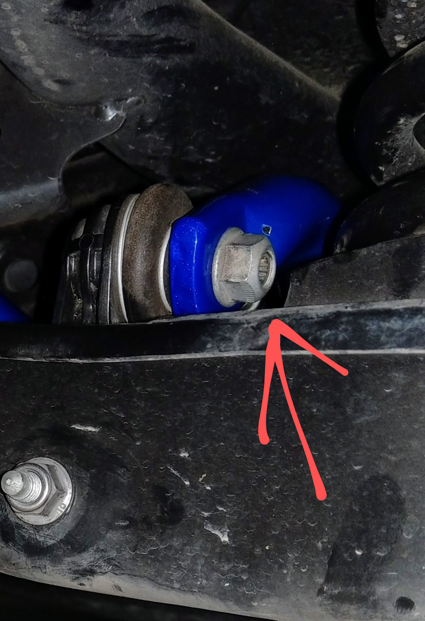

Two main reasons why I'm changing the sway bar end links:-
1. The original bolt is not long enough to cater for the thicker bar.  Which they also told me about.
U can't even see it in the image close up below!!!!
2. The car is lowered on Eibachs.
But mainly for reason no. 1!!!

That looks weird to be honest. I did mine myself and had no trouble tightening it back to where it should be, leaving a good 3-4 threads exposed after the nut, I can get a pic later on probably.
Speaking from an engineering point of view this is wrong and potentially unsafe. I wonder how thick the flat ends on the Hardrace bar are and how they compare to the H&R's flat ends. This is either designed or installed wrong, OR, meant to be used only with aftermarket end-links. Would be worth contacting Hardrace and asking their view on this but I agree it needs some action.
I believe it's designed to b used only with aftermarket endlinks, but I don't believe reading that anywhere on the product.

I was about to say, could it be possibly designed such so that they force you into buying their own end-links? I had no idea they do make them or at what cost, but it seems my hunch was right.
Looking at the 034 end links they seem to be compatible as the connecting bolt is a removable item (as opposed to being integrated on the stock end-link), so even if it's short you can just replace it with a sightly longer one and be fine.
A foul from their side though (Hardrace's I mean) not stating that the stock end-links are too short to use with their sway bar, especially for people paying a garage to do it as it would same labour cost for sure, but also as it effectively doubles the total cost of this modification (if not more).
