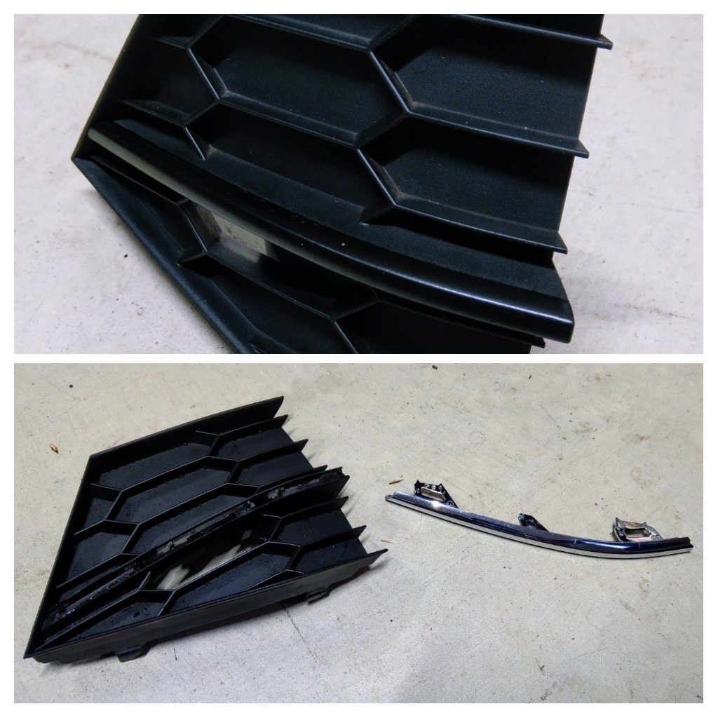

i spray-painted, using Plasti-dip, the chrome trim on my lower grille.
u could buy these bits from superskoda, in black already, if u wanted to, instead of painting it urself.
i removed the actual chrome trim from the grille, so i could spray it properly.
the upper grille would b more involved i'd imagine, and i myself haven't separated it.

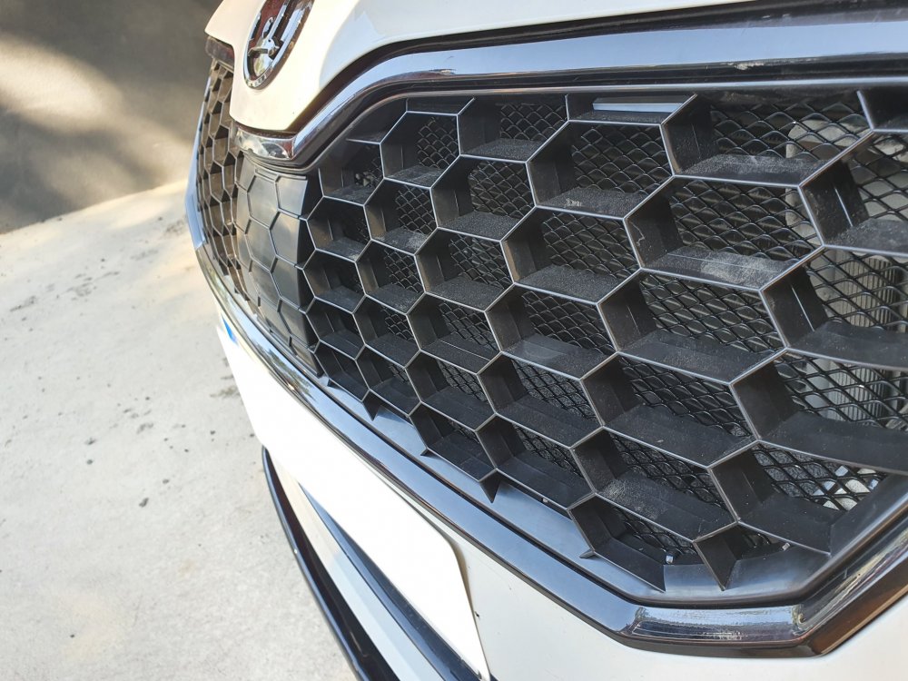

  • Heres another go at it. Got silver mesh from local auto parts store, painted it black and installed it behind the grill and front lip also found its way under the bumper. Much better now !
  • i removed the chrome trim below too, here you can see:   1) stock   2) black front grille and trim   3) black logo

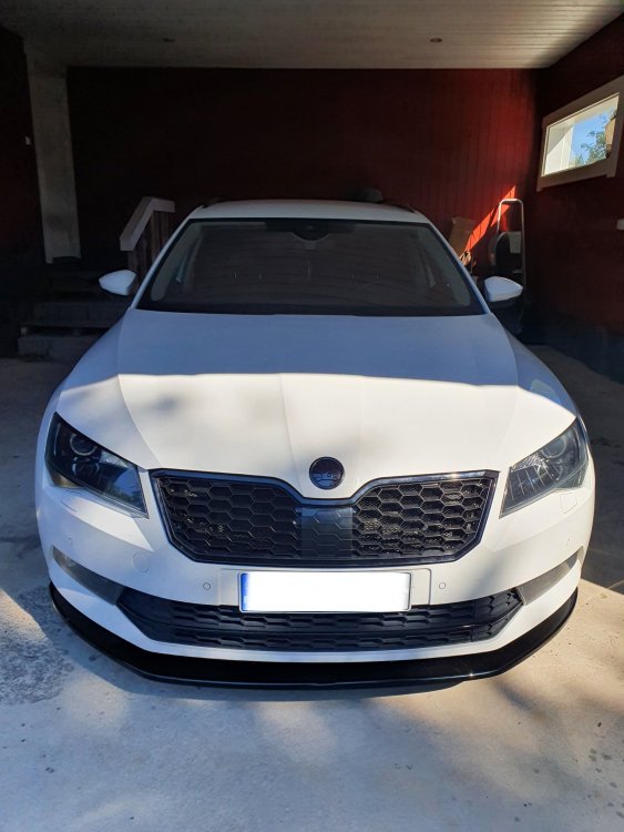

Hi Xiin,
Looking good! Do you remember the make and model of the front splitter you have?

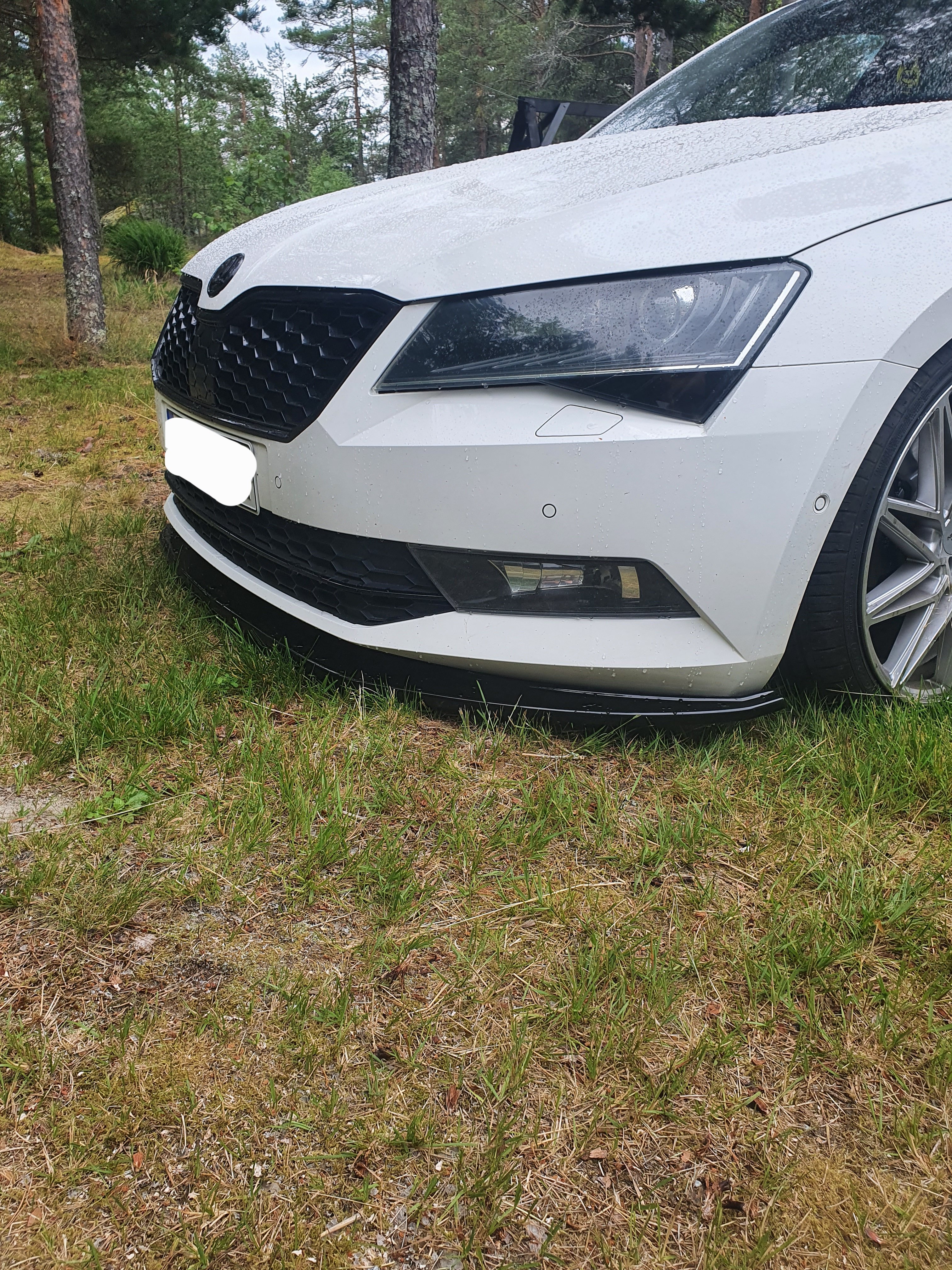

19 minutes ago, Meikkis said:
Thanks for the quick reply!
Could you please take a photo straight from the side, when you have time.
I cant get the idea from the superskoda pictures that how far the splitter protudes.
This is the best I can give you right now.
My splitter actually broke, because car was abit too low for this winter we have here, hehe.
About to order new one when snow is gone.

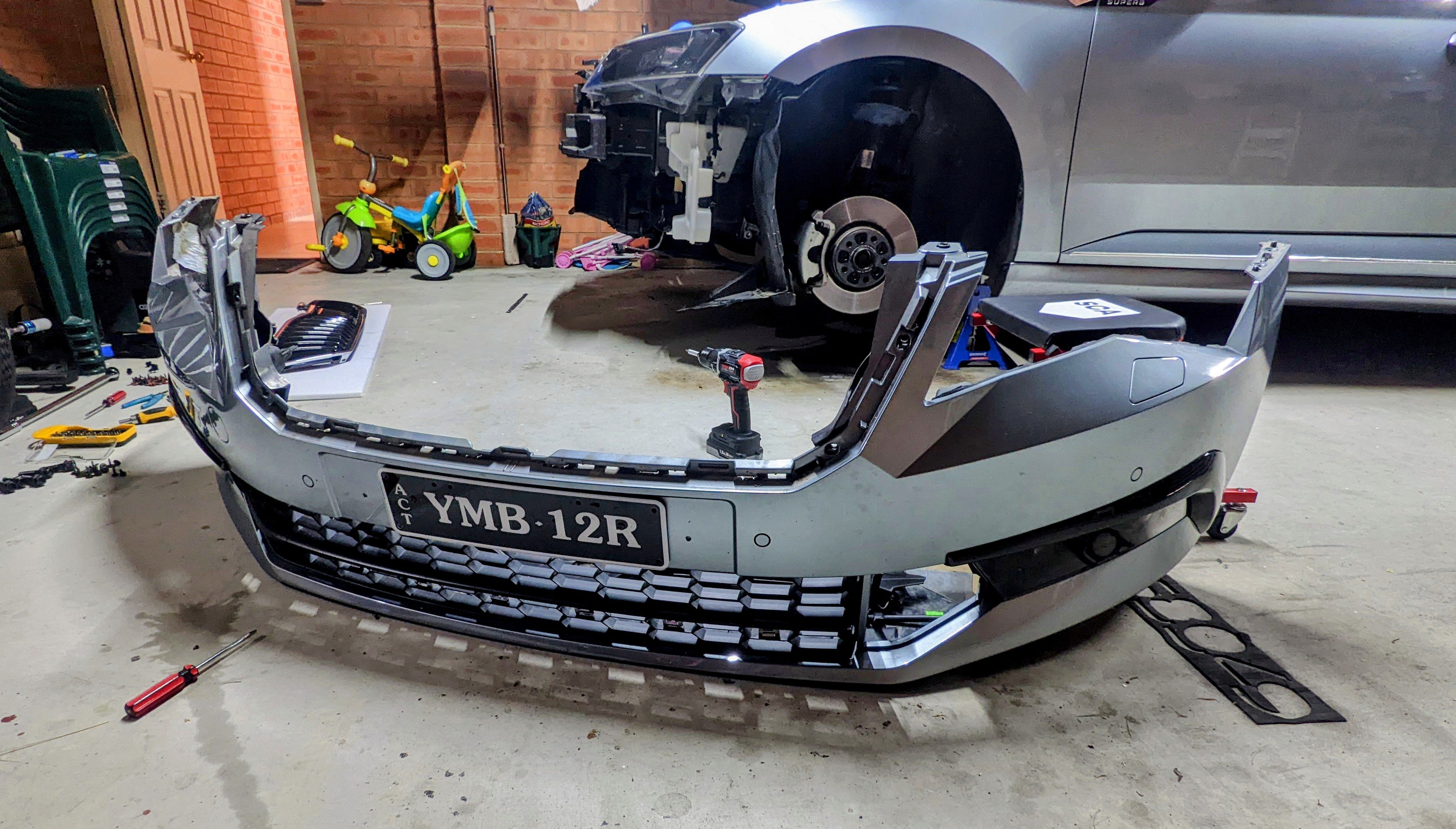

On 30/04/2020 at 18:59, boydeee said:
I changed my grille surround today. It's a bit fiddly in places so it would depend how patient you are and how much time you have.
I did not remove the bumper.
You are/were a magician...
I did take the bumper off and took almost 4 hours the whole procedure. I only did change the grill frame....
So I recommend, do not try without removing the bumper... some of the clips, and screws impossible to reach without that, if the bumper on its place...

I didn't want to remove mine if I could avoid it and managed ok. It was fiddly at times but I enjoy a challenge!
+1
I removed the grille frame surround the other day and there is no way I could've done it with the bumper still on!!
The screws at the bottom and the one above the ACC radar r next to impossible to reach if bumper hasn't been removed - for me at least.
The million clips holding the frame r a pain to separate too!!
@boydeee is a magician!!

On 28/03/2022 at 22:20, JR RS said:
+1
Amazing, by any chance do you have more photos of removing process, I would like to do it but my garage is very small and just wanted to see is it huge thing to do to remove bumoer and what mostly holds it in place
I've attached a PDF on how to remove the front bumper.
Basically:-
1. Put front on jack stands
2. Remove front wheels
3. Remove wheel arch liner
4. Disconnect washer fluid pipe
5. Disconnect electrical plugs
6. Remove screws holding bumper
7. Remove bumper
Removing Front Bumper.pdf

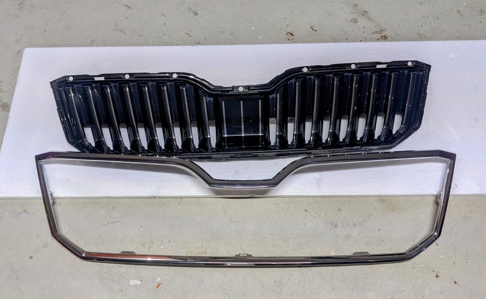

If I had a red Superb - I would've got that.

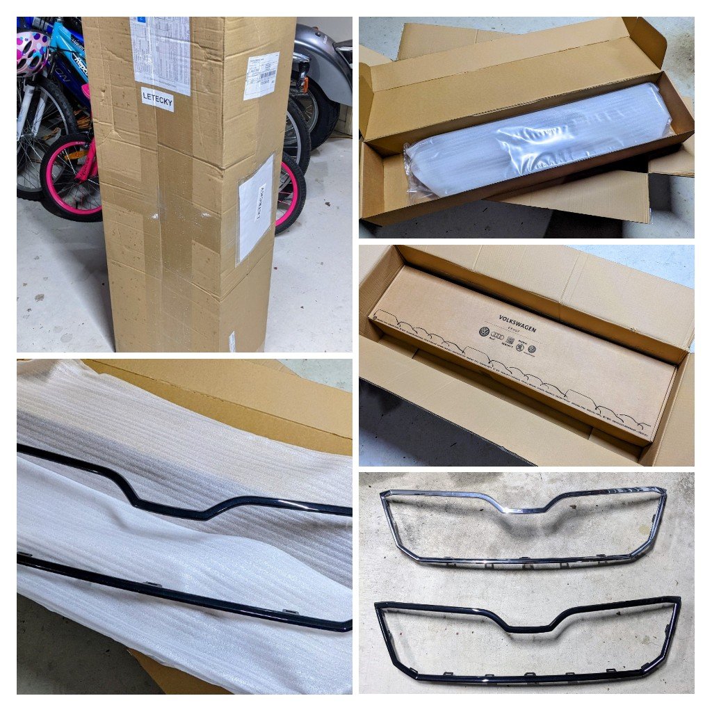

I did however replace my chrome grille surround with a black version though, from Kopacek.

I want to upgrade my skoda with the sportline bodykit. I was looking for a part codes for the oem sportline front grille, grille frame and radar cover. Can anybody confirm that part numbers I found are correct: grille: 3V0853653ZD4, frame: 3V0853761AF9R, radar cover: 3V0853655ZD4.
Also I was looking at kopacek and I saw they sell modified monte carlo grille and radar cover: http://www.kopacek.com/Skoda/SUPERB-III/Superb-III-original-Skoda-Autoas-front-grille-with-radar-MONTE-CARLO-BLACK-metallic-edition and http://www.kopacek.com/Skoda/SUPERB-III/Superb-III-original-Skoda-radar-hole-cover-BLACK-MAGIC-F9R. I assume these are original parts but modified (sprayed), they aren't stock. The grille frame they sell however is stock (oem) and it will be slightly different I suppose. Have anyone tried a combination of front grille and radar cover from kopacek with oem grille frame? They are also a bit more expensive: grille with frame: 215Eur, radar cover: 55Eur. While stock parts are: grille: 86Eur, frame 129Eur, radar cover: 33 Eur. I'm a bit uncertain which option to choose, modified version from kopacek, or original skoda sportline. Thanks!
The stuff from Kopacek r pretty much OEM, so the quality and fitment will b perfect.
I removed the factory chrome grille frame surround and replaced it with the black Sportline frame.
It was perfect fit on the original grille.
The box/packaging is OEM, as per my pics above.
U have nothing to worry about with Kopacek parts.

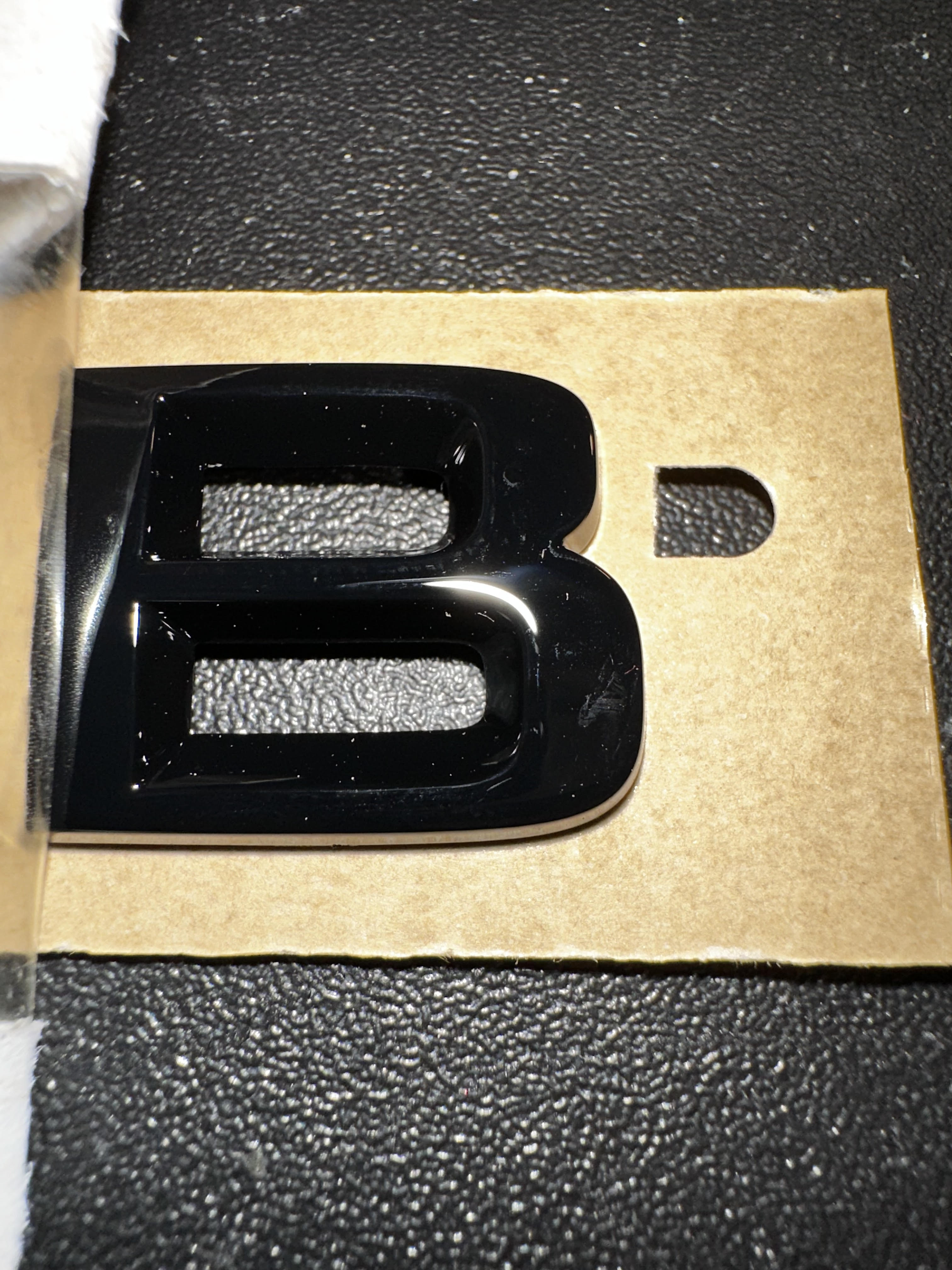

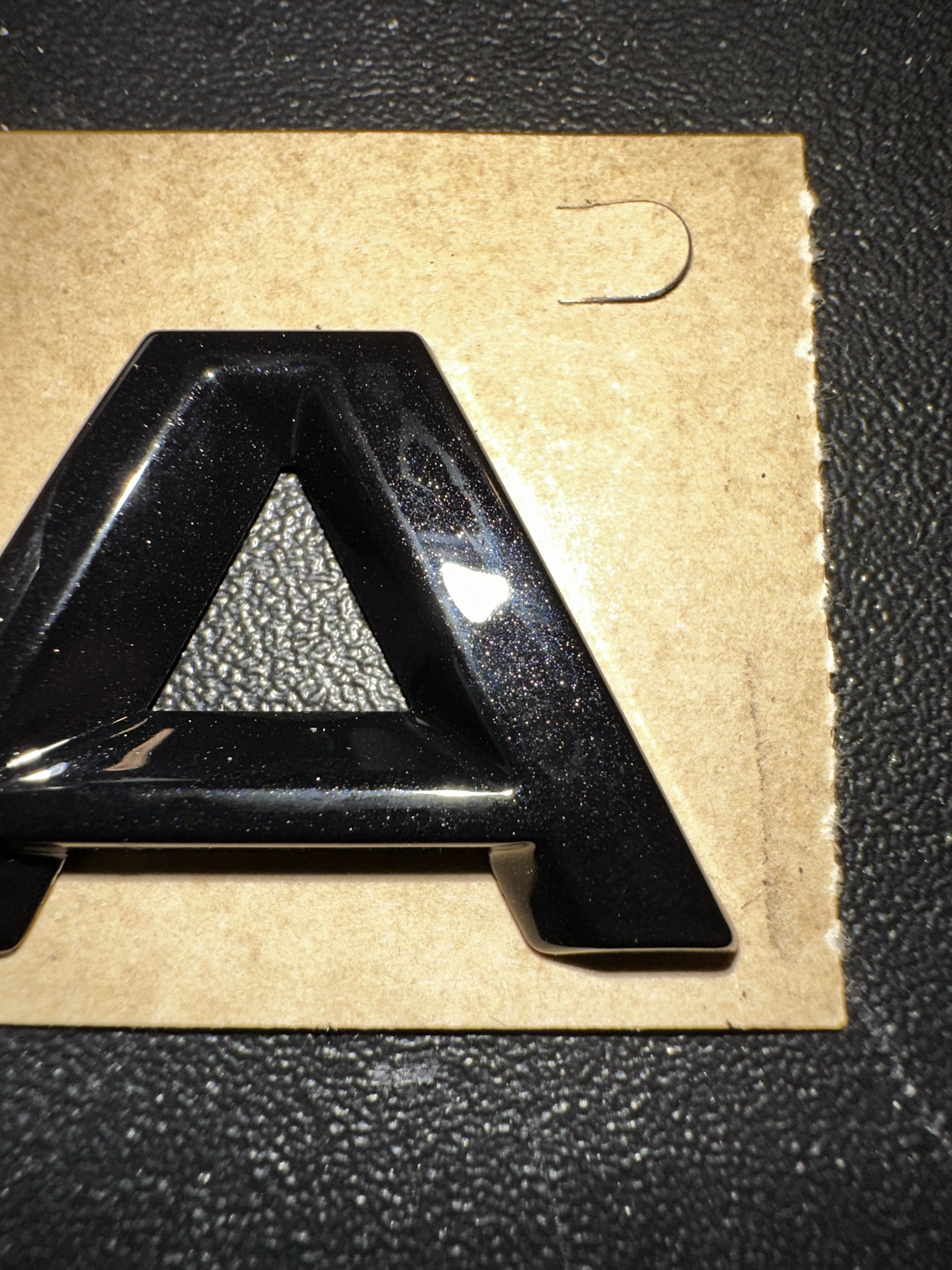

With the modified I meant that they spray some parts. For example: http://www.kopacek.com/Skoda/SUPERB-III/Superb-III-original-Skoda-Autoas-front-grille-with-radar-MONTE-CARLO-BLACK-metallic-edition. I have no doubts about the quality and that the part is oem, but they say: - modified to MONTE CARLO edition (Black Magic metallic F9R version). It means part is sprayed (painted). So this is modified OEM part. My only concern is, how does it look in reality. Because the grille is modified to monte carlo, while frame is unmodified, you can see here: http://www.kopacek.com/Skoda/SUPERB-III/Superb-III-grille-frame-SPORT-LINE-Black-magic-metallic-paint-F9R. So its not clear do they match visually.
As I said, I bought recently "skoda" emblem: http://www.kopacek.com/Skoda/Emblems/Genuine-Skoda-Autoas-rear-emblem-´SKODA´-MONTE-CARLO-black-version which is also OEM but modified to monte carlo edition. If you place it next to oem "superb" emblem: http://www.kopacek.com/Skoda/SUPERB-III/Genuine-Skoda-Autoas-rear-emblem-´SUPERB´-SPORTLINE-black-version which is not modified to monte carlo, you can see that modified version "skoda" emblem has that pearl effect, while stock "superb" item is just glossy black. So this is my only concern, will they match visually or not, because the emblems dont match. An if you use them both on the boot, you may notice the difference. Not even saying that the letter size on both emblems is different.
Here is modified to monte carlo (black with pearl effect "Skoda" emblem):
Here is stock sportline (glossy black "Superb" emblem):
I agree that I maybe overthink a little bit but just wanted an advise before I make my final decision which design to choose - all oem (unmodified sportline), or mixed oem and modified to monte carlo from kopacek. Maybe someone tried one or both variants.
Colourwise they keep quoting Black Magic as a colour. This is what it can look like up close so anything that that colour will look like this. It has what look like Royal Blue. Turquoise and Silver flecks in it. You only really notice those in particular light but it does mean the normal colour is not a deep pure black but almost with a midnight blue hue to it.
