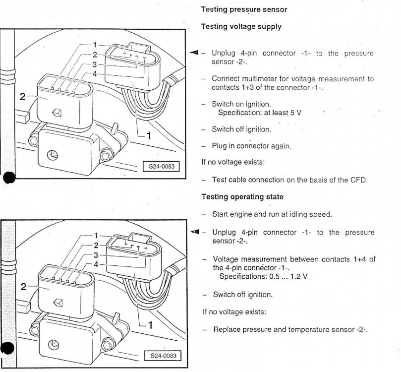

Okay, I did that as you said but the problem is still there, maybe it helped a little (or it didnt and its just in my head). Is there a way to test the map sensor? Or should I replace it and hope that it helps?
Yes it is.
See photo for the MAP sensor part.
For the air temperature part, use VAG-com to monitor the value (Engine/Read values/Group 02, field 4). It should be close to outside temperature.

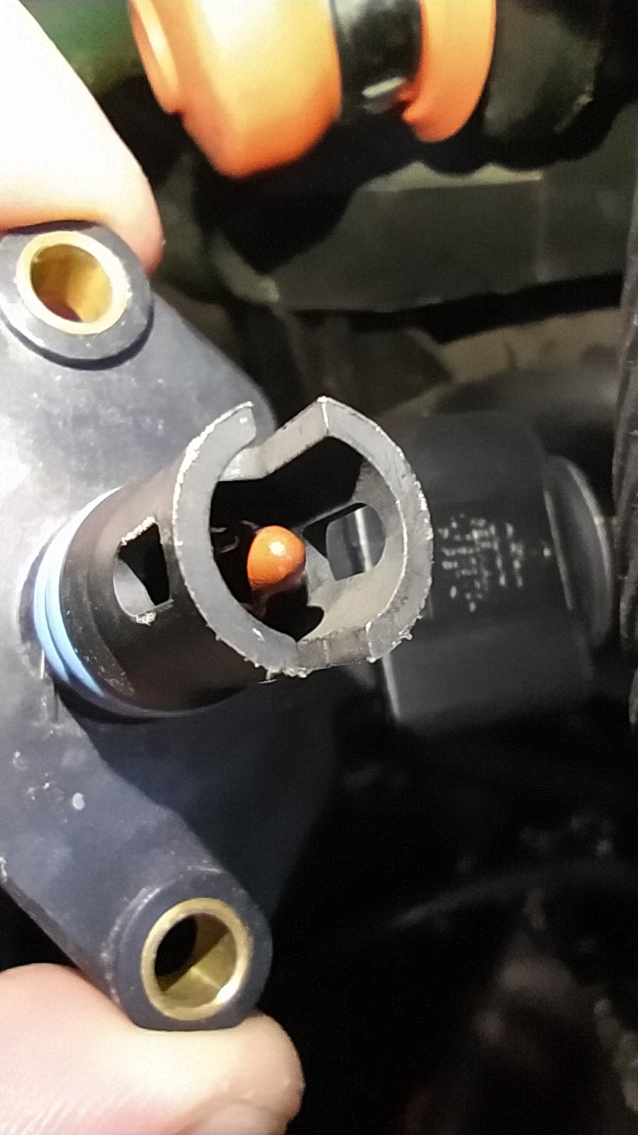

Before testing the MAP sensor i want to know where the oil on the MAP is coming from. I disconnected the breather hose, plugged the hole on the intake, cleaned the intake tube with isopropyl alcohol, cleaned the throttle body so it is not oily, cleaned the MAP, but the MAP sensor still looks shiny after driving for couple kilometres. The air filter is a normal paper one and it isn't oily or wet. Where the heck can the oil come from and "oil" the MAP?
Can you take a clear focused, good lighting, zoomed photo of the "oily" MAP sensor?
Here it is. It looks wet so i assumed it is oily. I don't know if it could come in contact with any other liquid.
I don't see anything to worry about. It is more important that the sensor sends the correct values of vacuum and air temperature.

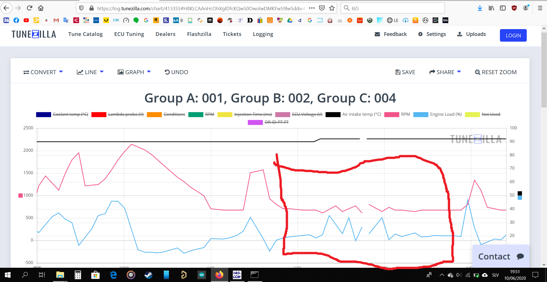

I would record a trip (using VAG-COM - Data Logging of relevant values) from start to engine stall. Then upload it to have a look at it.
Okay, I will try that, hopefully I can figure out how to do it :)
Which values should I log?
Engine/Measuring Blocks
Groups 001, 002, 004
Log
Okay, I tried but I couldnt get the car to stall when logging, however i got it to idle roughly. I put a marker (clicked marker button in vagcom) when it did that. I guess it is in this part (see picture). I attached a log file. Should I try again and get the car to stall?
LOG-01-001-002-004.CSV
I guess you cant read manifold pressure on a felicia. Group 1 has engine speed, coolant temp, lambda probe, conditions; Group 2 has engine speed, injection time, ecu voltage, air intake temp, Group 3 has engine speed, engine load, throttle angle, throttle regl, Group 4 has engine speed, engine load, not used, or-id-pt-ft and Group 5 has engine speed and valve duty. From there on, the groups are empty (they have some random values).
Yeah, I know the coolant temp and air intake temp are switched, that happens if I have more than one group open in vagcom. If I open just one group, it shows correct temp so I guess its a vagcom problem.
