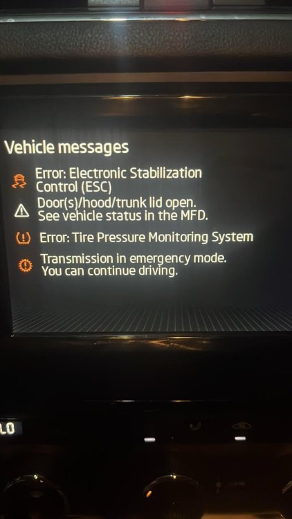

How soon after fitting the battery did it stop starting?
5 hours ago, RoddersUK said:
Is the new battery actually charged? Have you checked it with a multi meter?
No reason fitting a new one would stop it from cranking.
The other errors should clear with a drive, as mentioned above.
Battery died 2 months ago, just change yesterday as I was traveling. Someone told me that battery might not full charge. I’ll get a booster and try tomorrow. Thanks
I’ll keep you updated.
