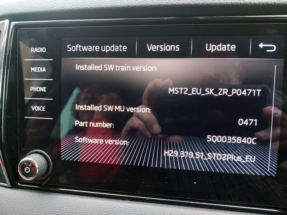

Mine is a MIB2 bolero Installed SW Train Version MST2_EU_SK_ZR_PO471T Installed SW MU Version 0471 Part Number 5Q0035840C Software Version H29.319.51_STD2Plus_EU on a 2018 Skoda Karoq.
Can you please help me with getting update files? I have posted a request on Briskoda but I haven't had any replies. Any help in this direction will be greatly appreciated.
If you speak with @pab567 he will hopefully be able to assist.  I canny send out these.
Thank you. I have put a couple of posts up hoping that @pab567 might see them but I haven't heard anything. Maybe he's on holiday. Thanks again for your reply.

On 28/09/2021 at 12:04, pab567 said:
PM
Thank you @pab567 I update today. Very pleased. Once again many thanks.
