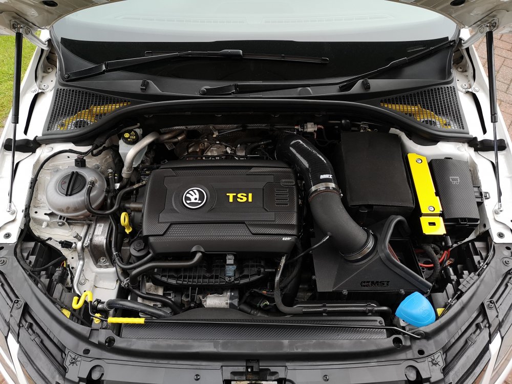

I have an MST (version 1) intake on my VRs 230. The turbo elbow and hose seem to make a slight difference in performance, the filter is just for sound though (and looks). Coupled with the pikey modded OEM airscoop and retaining the OEM bottom half of the box it should still do well. If I want it quiet I can close the box, if I want it louder I can remove 2 more parts of the box depending on how loud.
Personally I'd avoid anything with a foam filter and stick with cotton.
