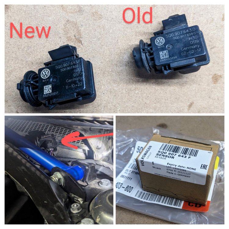

  • OK glad that worked out I used the Hella part. Attached are the photos of replacement - the scuttle panel is split in half and lifts up pretty easily without taking the wipers off (on RHD anyway). The

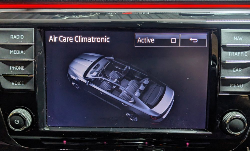

  • That sensor controls the re-circulation in the climate control systems. if it detects external air quality is not sufficient, it will turn off re-circ.    it went in my car last year, and it
  • No visible indication to the driver.  You can go to the climate menu, settings and make sure auto recirculation is selected though.
it went in my car last year, and its a common hella part.
 VAG part 5q0907643b, hella HELLA 6PX 012 684-011
its located under the scuttle panel on the passenger side of an RHD car, and is a 2 minute job.
you can quickly check the part number on yours by removing the scuttle panel.
autodoc have it for 45 pounds (https://www.autodoc.co.uk/hella/7915638) but its commonly available.

It’s just under the passenger side scuttle panel (on a RHD). Undo the clips, remove the rubber seal, and pop the panel out. You’ll see the sensor (you can see the wires fir it through the grille). It’s a 5 minute job to change the sensor, no tools required.
i recently changed mine, 5 mins job. no more exhaust smell in car now
Thanks folks. I'll see how much the part is from Horton Skoda and get it installed. So....I have to remove the 3 clips, assume they pull off, remove the rubber surrounding and then gain access to the sensor on the passenger side. Sounds fairly easy.
The metal clips will just slide off. You can't miss the AQS sensor once you take the grille off. It's mounted just using a clip.
Actually, see those two round tabs underneath the windscreen? You might have to pop them off and undo a screw under each of them too - I can't quite remember now. So maybe there's one tool involved. Even so, it's really easy. I got my Superb in August and the AQS was throwing an error, so it was the first thing I did on the car.
I got my part from skoda-parts.com. I paid €52.81 for the Chinese version. Skoda OEM part is €93.90 there, and there's a German 3rd party part for €69.02 - just to give you an indication of the prices.
https://www.skoda-parts.com/spare-part/5q0907643c-air-quality-sensor-de-40156.html
Edited by GregorSamsa
Client happy and thanks to you guys (and girls) the car is now not reporting a fault (for that module).

The part number for the sensor is:
5Q0907643C
What came out of the car was
5Q0907643B
So a different and earlier revision that seems to effect how the sensor operates. Client is happy. I've got to fix a glow plug now for the same client....
