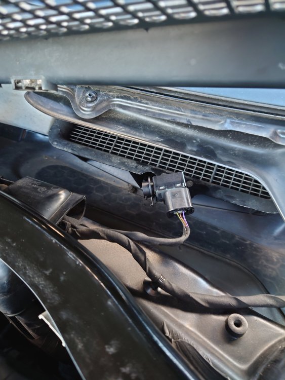

  • OK glad that worked out I used the Hella part. Attached are the photos of replacement - the scuttle panel is split in half and lifts up pretty easily without taking the wipers off (on RHD anyway). The

Hello! I have just tried to replace my sensor but failed :( . I found the sensor under the scuttle panel but couldn't work out how to
1. Disconnect the electrical connector - there seemed to be some sort of hard collar around the plug on the sensor
2. Undo the old sensor from the bracket - its like a barbed design - presume just squeeze from underneath but seems a bit tricky?
Can anyone who has done this diy remember how to do it. Sorry if I'm being thick. Thanks David

Just out of interest how are you getting to the scuttle area? When I looked on mine I’m sure it looks like the wipers need to be removed.
Others had said on here it slides off but can’t see how, could you take a picture of your mesh panel area when it’s off please?
Sure will do next time I'm back under there - it lifts up enough for access without removing the wipers. Best wishes David

Bit of an old thread but the information is still relevant and helped he today to find the sensor. I couldn't get one today so I just cleaned the plug / socket with contact cleaner and put it back in. Ran VCDS again, cleared the fault and it didn't come back (yet).

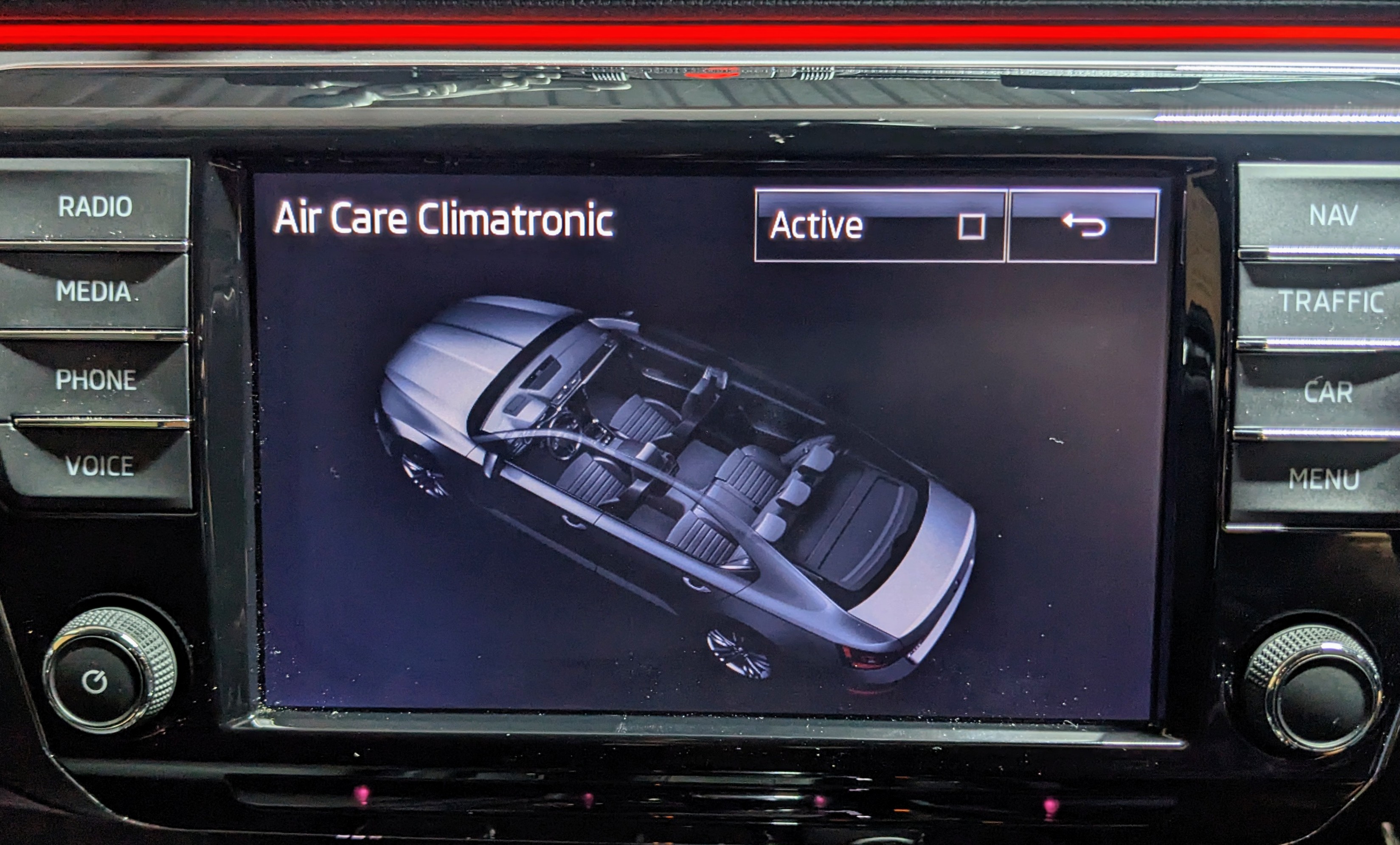

the only thing i don't have is Air Care.  I didn't have it prior - i did try enabling it a while ago, but pressing the "Active" button does nothing.
