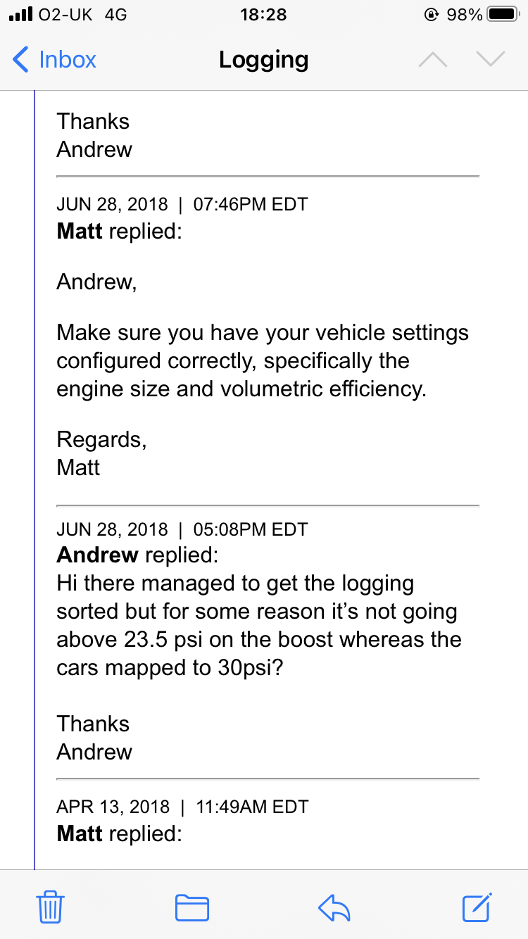

I've just got an app called torque on my phone that I can contect to my odb port using a Bluetooth adapter. Trying to work out which is cause and which is affect. Need to work out which sensors to log. Boost, fuel rail pressure, throttle position (there are a number). Then need to find enough road to run through some kind of test program. My tuner saw stable boost on the rr
That doesn’t take the actual boost from the sensor it’s a calculated measure on the app not actual.

It’s not accurate.
I thought boost was taken from the ecu. Some readings are calculated in the app like bhp and torque I wouldn't rely on them at all. I'm more looking at the throttle, fuel, revs and boost readings.
Nope boost is calculated had this argument with the app developers a couple of years back.
What the hell kind of point is that! What a load of ****e. Do you know how it's calculated?
This is what they said back then they then went on to claim it was coming from the ecu and it went down hill from there till they stopped replying 😂
only thing I’ve found that will give it correctly is vcds.
