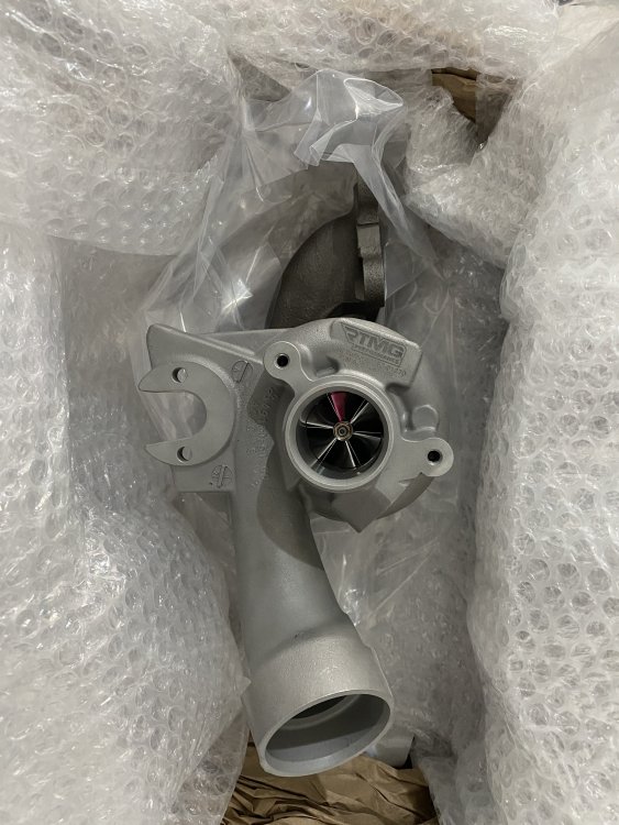

Hey , recently got this rtmg ea211 1.4tsi hybrid turbo for my fabia , it came without a wastegate actuator so i wanted to ask if i could attach the one from the stock turbo or should i get a new none oem one?
Nice! I saw you had the standard 1.4 turbo on your car before. I'd put that actuator on it. Be interested to see how you get on

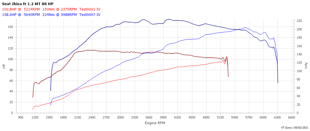

Hey guys, I’ve got a 16 plate Ibiza fr so not a Skoda😂 but I’ve got the same engine as you lot, 1.2tsi 90hp
got the turbo swap done yesterday and tuned, although a conservative tune as we are going to do more power once I have my downpipe and induction kit fitted, atm I’m stock internals other than the turbo....
We never ran into any issues of boost cut and actually had a really smooth graph, so don’t think the map sensor is the issue for you guys.
hope this helps!

I see the main difference between yours and ours with the cut is that ours peak close to 300nm of torque, where yours sits quite happily at that 225nm area as power climbs.
Do you know what peak boost they were running and what was it like toward redline?
And also what gear were they running it in?

I’ve emailed the tuner there and asked him all those questions so will let you know ASAP!
Be great to see how you get on when you up the tune, that is a nice and flat torque curve and nice power curve

*Info for anyone interested in upgrading to a hybrid turbo*
So after getting the 1.4 hybrid turbo i faced a problem with the wastegate physically not fitting the turbo , the 04E 145 713 N turbo that is used as a base for the hybrid turbo comes with a different wastegate than the 04E 145 721 B
the 04E 145 721 B wastegate- 530423E6-1949-4549-A886-EBC9698B3A0B.jpeg.0f19dddae8ed833fc6c13de918ba982e.jpeg
the 04E 145 713 N wastegate-3F136CEB-4B4F-4278-887B-E59C9F564299.jpeg.2915e9f2ee3ba5d476ad5dbfef6dedfb.jpeg
the 04E 145 713 N based hybrid turboB3678C2F-03AD-42F8-A9EA-82240B360AC6.jpeg.ad36aab44a7230bedcfe66e43f87de46.jpeg

Which part of the actuator won't fit, the mounting point or arm onto the wastegate?
Do you have both actuators?
The arm , i currently have the top actuator and trying to get my hands on the bottom one
