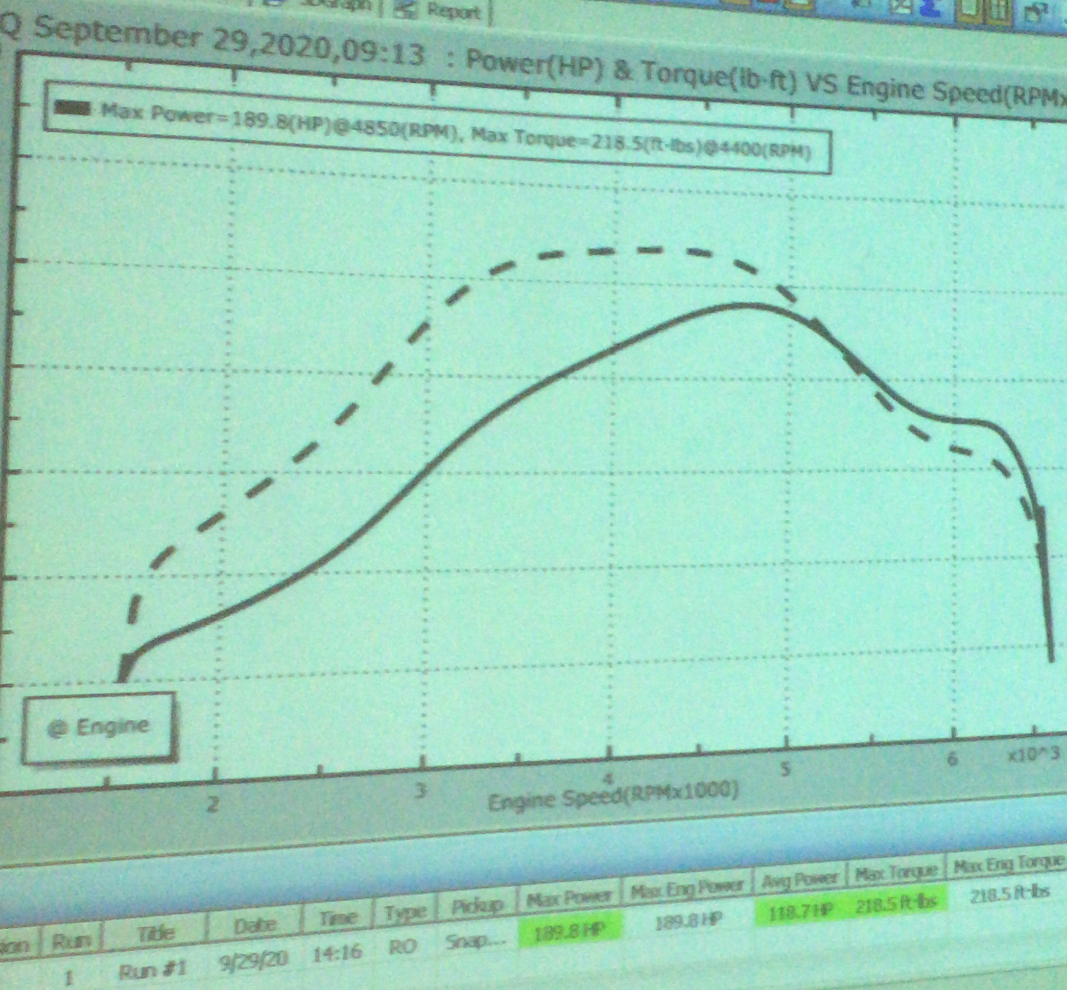

I have this graph of a run whilst trying to eliminate the wierd throttle bug, perhaps yours has it too but the tuner didn't mention it. 190bhp, 218ftlb (295nm).
On a unrecorded unrestricted run we saw 208bhp at ~4750 rpm, and about 240ftlb (325nm) peak torque a little before that, with the throttle practically shutting beyond that pulling power back to around 130bhp.
That was hitting over 1.5bar boost which is the limit for the map sensor too, so it was dialed back to 1.4bar for this run;

I'll be honest that peak does't look super healthy for the turbo, how much boost was that making? And note how your peak power is at only 4300 rpm, and how it drops off significantly after 4500 rpm.
My tuner was logging everything with VCDS monitoring boost and such, and found that it was actually closing off the throttle, no matter how much or how little boost we threw at it at the low end, it wouldn't let it past 130bhp beyond 5000rpm, its like there's some safety limiter it was hitting but we weren't able to figure it out in the time we had available.
When i go back in for my second attempt, we're chopping out the secondary cat too, so we'll see how much of a difference that makes. The 1.8tsi uses a larger diamater exhaust which already ditches the secondary cat, i'm not sure if the o2 sensor holes are compatible though. Plus the brackets would need some adaptation for where it braces to the back of the engine block

Sounds like there's some funny stuff going on, a lot of the graphs I've seen of mapped 1.2 and 1.4 tsi engines are flatter but I hadn't seen any turbo swap or hybrid turbo graphs. I haven't seen any 1.4s running 230bhp let alone on the standard exhaust.
It does seem to get strangled at high revs and I had expected a flatter curve
