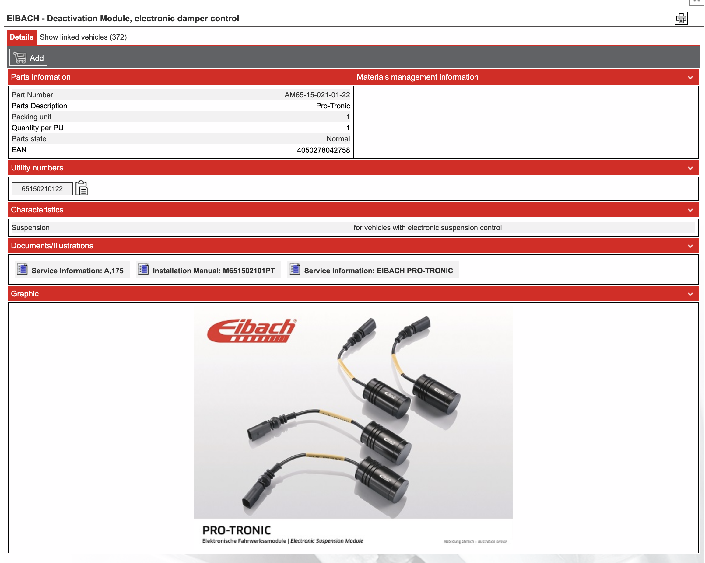

I think that you have to do some coding. But thanks to @newbie69 thread i found this:
634637333_Schermata2020-06-24alle20_46_15.thumb.png.8062825288d81c7e4d5a82755117cc22.png
With this module you shouldn't have to code
imageproxy.php?img=&key=00da0a65627968c1634637333_Schermata2020-06-24alle20_46_15.thumb.png.8062825288d81c7e4d5a82755117cc22.png
These things r used to "trick" the car electronics into thinking that the usual DCC dampers r still there.
The car's drive modes will tell the shocks to go into Comfort/Normal/Sport dampening modes, but it will have no effect as it goes to this "dummy" device, and not to the aftermarket shocks.
These r designed for non-DCC compatible shocks.
Usually not putting this dummy DCC devices will throw errors.
The very very expensive Koni DCC compatible shocks will retain the drive mode dampening changes.

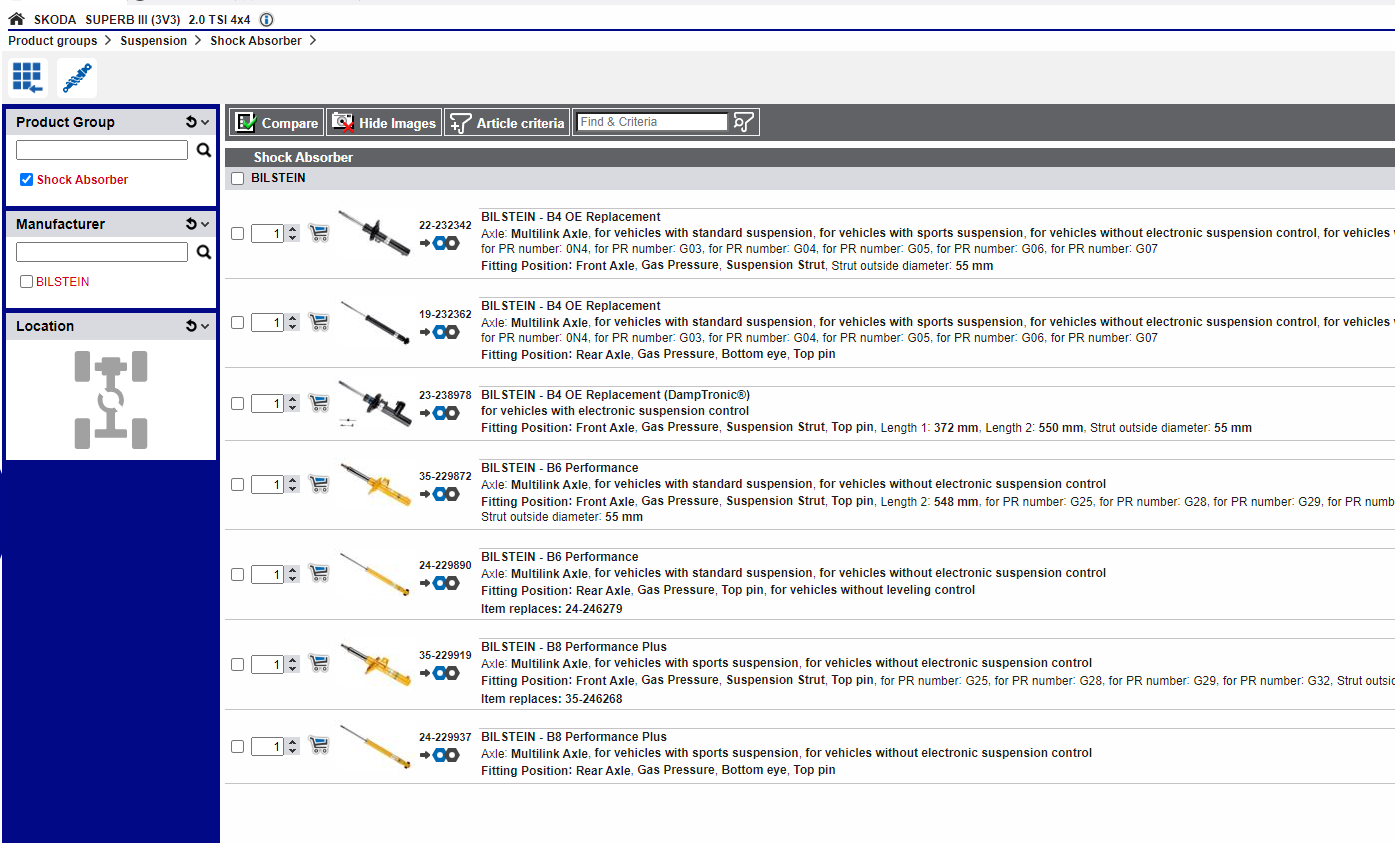

I spoke via chat with a Bilstein technician (on this page), he said that there are no compatible B6 Damptronic for Skoda Superb.
139c451e261236a7838d115cd8e93342745f6390.thumb.png.7d730cf5d2efaeb2b964d698b6232fd2.png
3 hours ago, MarkyG82 said:
As you say they probably didn't bother with the checks as there is little demand.  I would suspect the fitment to be fine as the B4's are ok.  The DCC connection is probably also the same but it would need checking of course.
No wonder they don't care!
Of-course he would say that, he just took 3 seconds to put your car model in the catalog and repeat to you what the page was showing, really helpful of them :dull:
So the Golf R variant shocks are the same for B4 DampTronic and B8 standard , but somehow imageproxy.php?img=&key=00da0a65627968c1not for B6 Damptronic, lol...
That web page is so accurate, or shall I say complete, that it only mentions a front B4 model for the Superb, so you can't have the rears if you go for B4 Damtronic :D
I bet someone has been really lazy with the Skoda/Superb entries. I wouldn't think you can resolve this by a quick chat on their page, you would need to involve either some dealer with access to their technical department
or contact Bilstein yourself and explain why they share shock numbers in all other series but B6 Damptronic, and also why their site does not list a rear B4 Damptronic but only a front...
