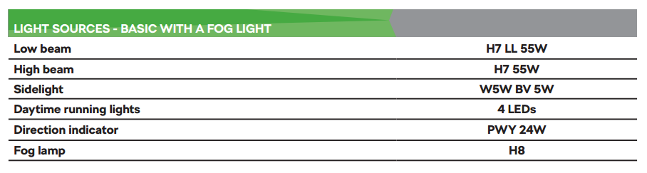

Firstly a question on bulbs.  From what I can figure out, the dipped beam headlamp bulb is H7 type, is the high beam bulb the same?  Im going to get a set of Philips Xtreme bulbs for the low beam position, was wondering if I need to be getting 2 pairs.

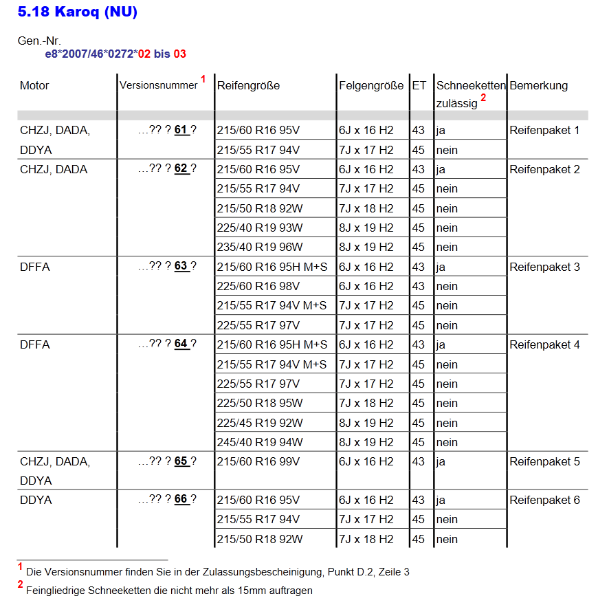

Secondly, I’m looking to get a second set of rims to put proper winter tyres on.  I spend a lot of time in the Highlands in winter and have learned of the value of proper winter tyres in extreme conditions.  I have a fair choice of rims to go from from Audi, VW & SEAT, Skoda rims that suit the Karoq seem to be a bit like hens’ teeth.  Most are offset are ET43 but my rims (Ratikon 17”ers) are ET45, my understanding of how it works is that puts the hub 2mm further out and shouldn’t be a problem.  Sound right and ET43s are OK?  Obviously have to make sure all the other numbers are correct, 5x112 7j 17 and 57.1mm etc.

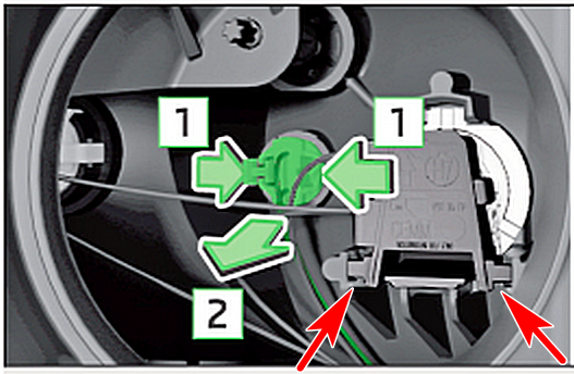

I did install the Philips Xtreme bulbs, but I might have not bothered, as to me the difference is slight. Mind that you must engage the bulb holder guides (red arrows below - ignore all the green) when still far out from the final bulb position - I struggled with that.
Factory approved ET is 43 for 6J rim width and 45 for 7J and 8J.
https://www.skoda-auto.de/service/serienbereifung
The only tyre and rim size Skoda list for use with snow chains on the Karoq is a 215/60R16 tyre on a 6Jx16 ET43 rim. However, that doesn't mean that some other sizes wouldn't work. It's just that you would have to work out what size doesn't cause bodywork or suspension damage.
215/65R16 is a cheaper and more common size to 215/60R16 so might be worth considering.

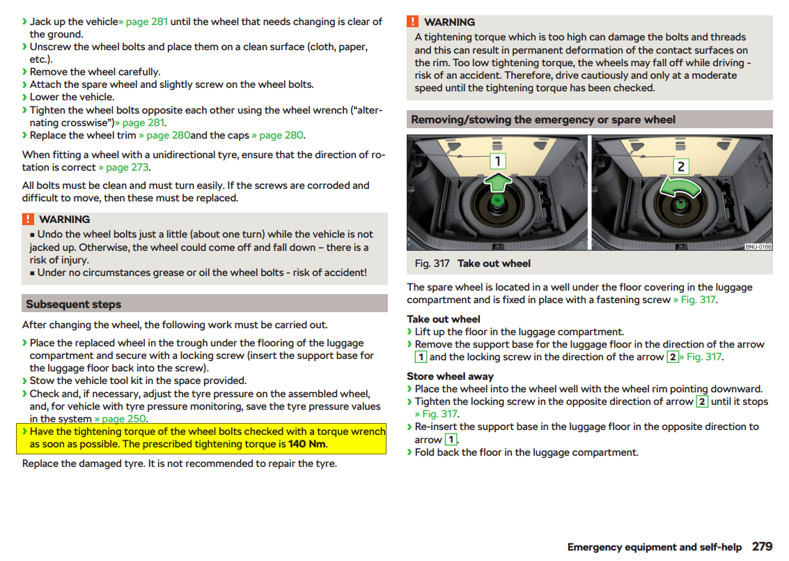

Another couple of questions.  When using a trolley jack do I use the same point as the “normal” emergency use jack?  Never jacked a car up using the wishbone, no wish to start now.  Plus what’s the torque figure for the wheel nuts?

The prescribed tightening torque of the wheel bolts is 140 Nm.
Many thanks, I missed that in the manual.   I have been used to wheel nuts, wheel bolts takes me back a decade or 4, will have a play. 👍

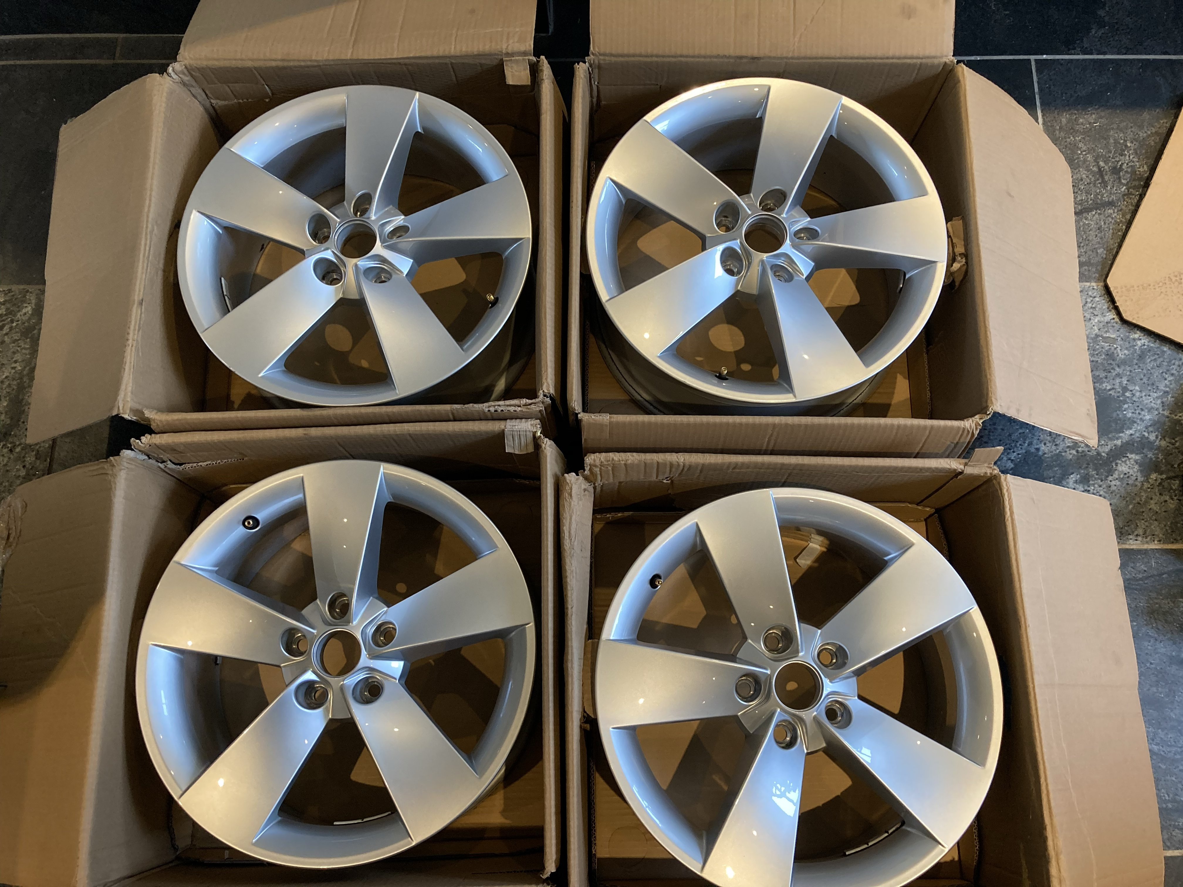

PS Pic of the Alloy.  Just unloaded them and very happy.👍
Plus the seller had boxed them up which was brill as I had a pretty full boot, they just sat on the folded rear seats.  If he’s on here many thanks and good to meet you yesterday.
