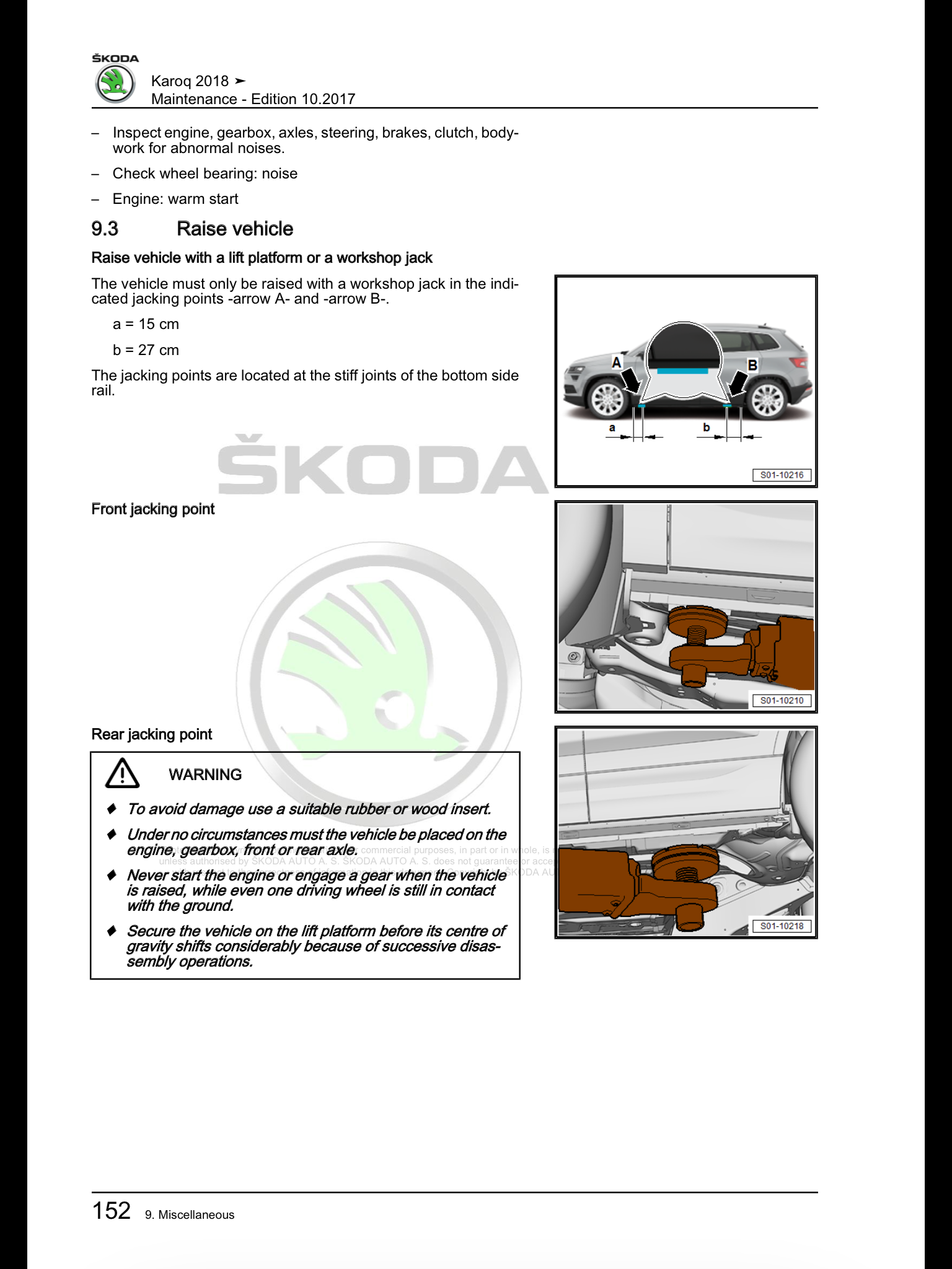

Using an ice hockey puck has the advantage that you can cut a slot in it for the sill seam.  You would need to secure the puck to the jack safely.

Re jacking up the car, looks like it should be no problem with a standard jack.
Much good info in the manuals section.  👍

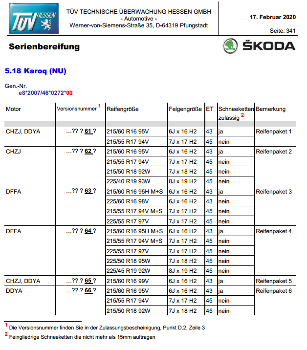

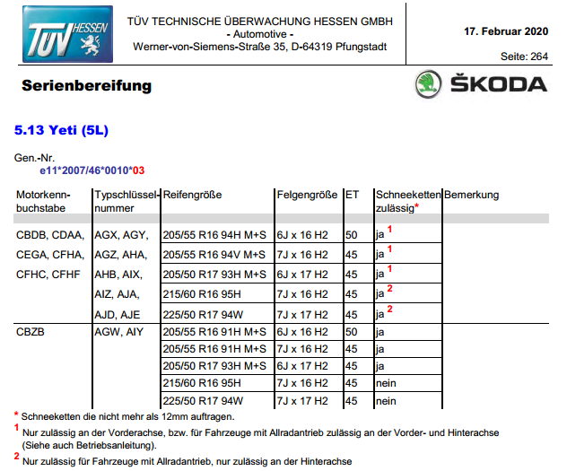

2 hours ago, kenfowler3966 said:
i have a set from my Yeti on 16" steel hubs which are the recommended witner tyre size and hub offset also for the Karoq
The approved 16" wheels for Yeti seem different from that for Karoq. Suggest you check further in the DPF from the bottom of this page:
https://www.skoda-auto.de/service/serienbereifung
Edited by agedbriar
I have been told this before, so I will check again but the wheels, as far as I could tell were the correct Karoq spec. Perhaps I was sold the wrong ones for the Yeti
If not there will be set of winter wheels with loads of tread left for sale here shortly!
I wouldn't worry, despite what the 'barrack room lawyers' might have to say - if they look right and fit without catching on full lock then where's the problem?
Depends how pedantic an insurance assessor might be when you really need that insurance cover?
I haven’t done a trial fit yet. My car has 19” wheels as standard but does list 16” 6j wheels as the winter option. However that is also the only size which can have snow chains so perhaps narrower than could be fitted without chains.
I have had another look at my own current winter set.
6j x 16 steel wheels with et43 offset.
Tyres are 215/60 99H.
Looks like the wheels were a bit narrower than they should have been on the Yeti.
I did review the rolling radius which is slightly less than my summer tyres fitted but legal as speedo will be slightly more optimistic. I always use a true speed app though to determine exact speeds. Eg current tyres are reading 74 at an exact 70.
This wheel and tyre combination is one of those listed above though.
Why does it change with different motors though? What is the 190ps diesel code?
