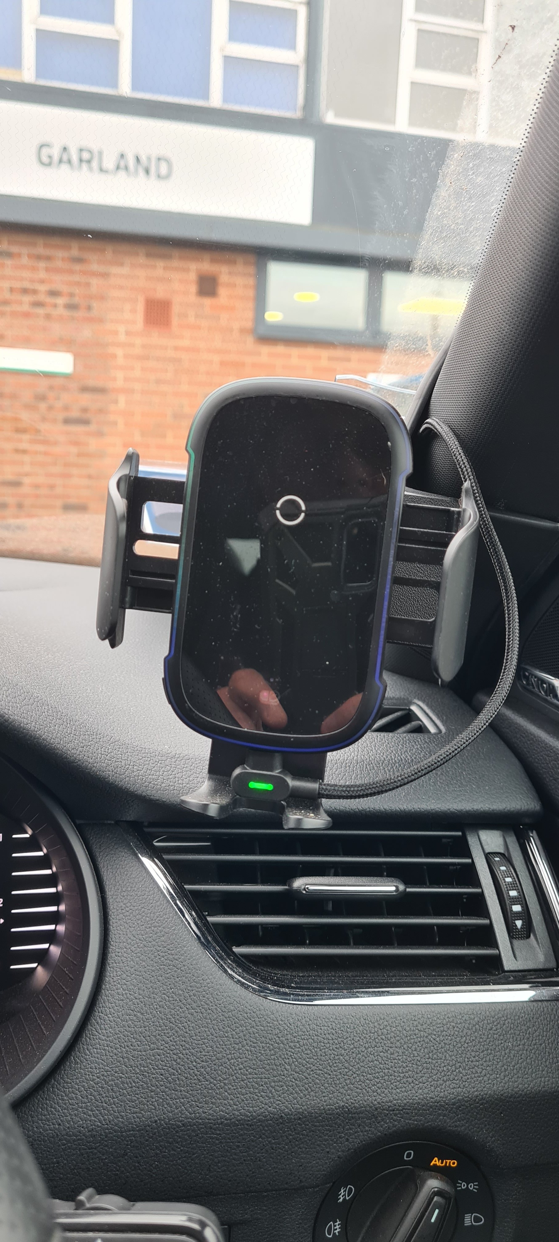

Do u want something like this?
Although I have just noticed that Brodit have for some reason stopped producing the A pillar mount, so what I have here is now impossible to achieve, nor do they do a vent mount for it either.
So a suction mount maybe the only solution unless Arkon do something like it.
Actually I think that it comes with a vent holder, so it's doable but not like mine.

It seems only for the centre, which I would hate. Must be for the right hand vent, but that's at a push, as I hate thing's blocking vents.
Also it will be low down, so a fat lot of use if you want to use either Google Maps or Waze as that needs to be more eye level not low down, as you will need to give it an occasional glance as you're driving, especially with the new tighter rules in regard to the use of phones in cars and touching them.
The last thing you want to do is be looking down towards the centre console as you're driving and end up in the rear of another vehicle.
Anyway in such a case then the vent adaptor that (I can confirm comes with the Baseus wireless charger) would be a better proposition, by a long way, as it can be attached to the right hand vent at a better height which is more towards eye level.
