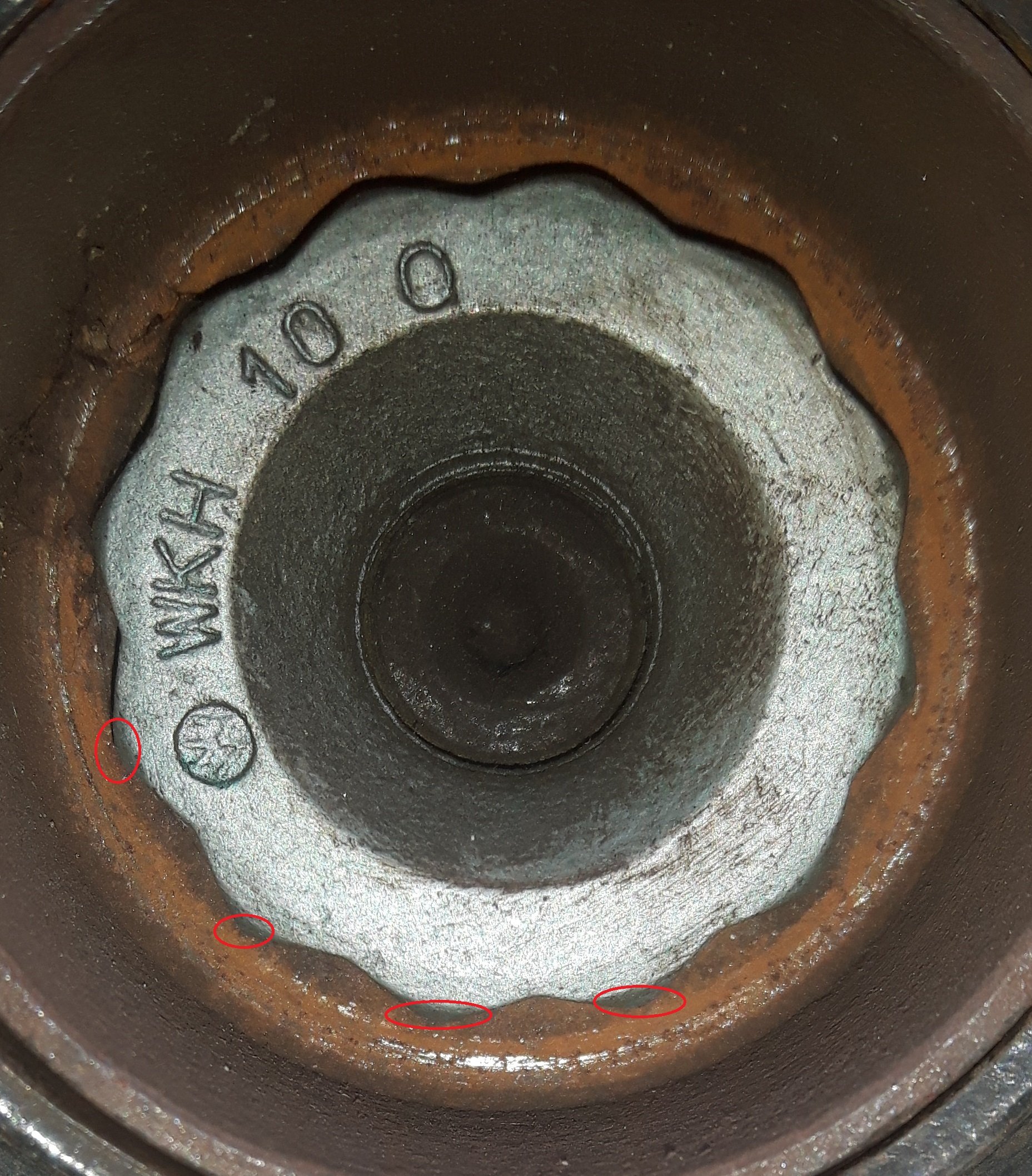

Went to take the hub nut off with a 12 point socket 36mm and it doesn't even look to turn the nut plus a 34mm if far to small for the nut. Is it a 35mm? See pics

It's hard to see from your photo, but is there any chance that nut has been rounded off? Comparing the image here, the points look pointier?

Here's a photo of my right front hubnut enhanced a bit with red rings around some of the darker pointy bits.  May just be a photographic thing, but your pointy bits seem less obvious?

They're just small chamfers to aid in the socket over the nut. As far as I can see looks same as mine
Problem solved, the nut was loose. I must of cracked it yesterday and didn't realize 🤣

With the benefit of hidnsight that can be seen by comparing the two photos.
  • Sponsor
So it can! A few threads of 'unscrewedness' visible in his pic.
