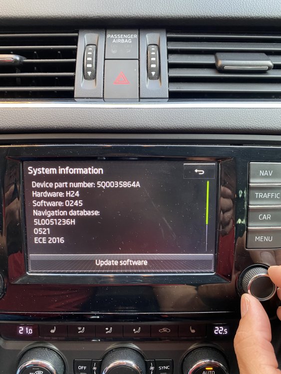

I recently bought a 2016 Octavia Combi Business Edition. I think I have an Amundsen. Not sure how to check that. See attached System Information.

How do I know from System Information which unit I have and if it is compatible with CarPlay?
Your part number begins 5Q and your navigation database begins 5L - so you have a MIB2 Amundsen (running with 4 year old map data which you can update free online from the Skoda portal).

5Q0035864A unit is Amundsen MIB2 without DAB, MY16. It is capable of SmartLink (MirrorLink, Android Auta and Apple CarPlay). it requires activation of FEC/SWaP code by dealer or hacking :)

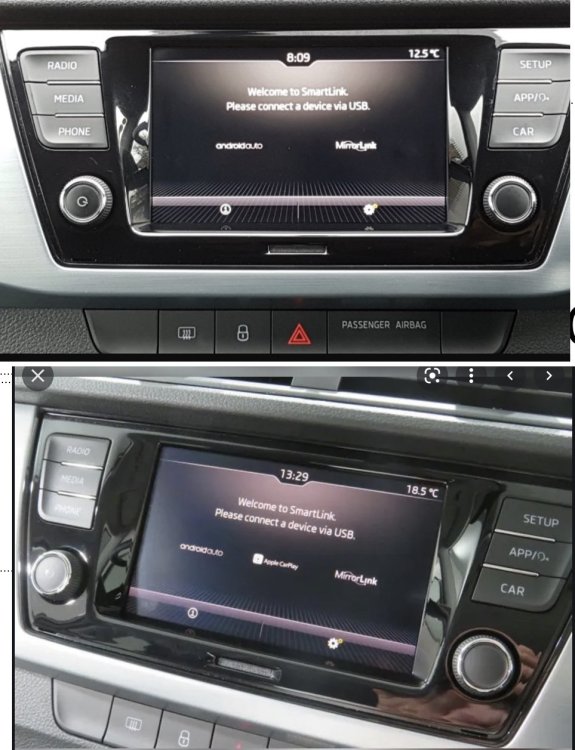

Family member is buying a 2018 (68 plates)A7C59CE1-295B-4BF2-9D11-9ECEF8067945.thumb.jpeg.9b80da98fd61ec94824e913305f4e16b.jpeg Fabia. From images of the car on the webpage Smartlink shows Android Auto and mirror link but not Apple CarPlay. (Top image). I found the bottom image on Google of system showing all 3 options. Will they need to go to a dealer to get Apple CarPlay enabled or will it work with an iPhone.
  • 2 months later...
I'm new to Skodas, but I've spent a lot of time fiddling with this stuff in setting up my Fabia. The second photo is simply showing all the Smartlink technologies available and you will see this screen BEFORE a phone has been connected- you can't actually select anything from this screen. The first photo is what you see AFTER you connect an android device, and it is here that you can select the connection technology you want to use. As it is an android device that has been connected, you don't have the option of selecting CarPlay. However Carplay is a feature of Smartlink so if you were to connect an Apple iphone you would be able to select Carplay.
Short answer- you don't need to get anything enabled at the dealer; Carplay is already available, you just need to connect an iphone before you can use it.

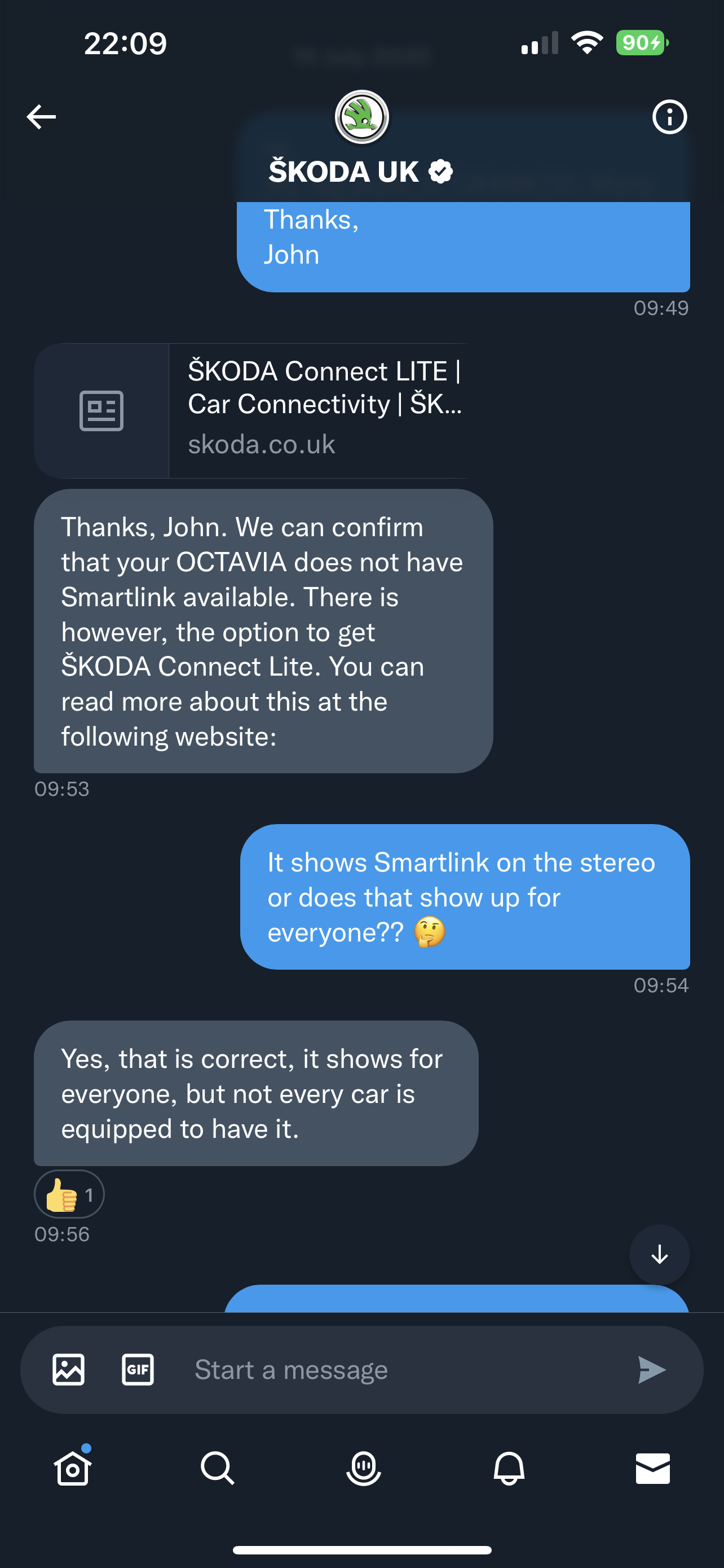

This is what Skoda UK on Twitter told me when i enquired about Smartlink. I’m guessing i could actually have it actived then based on what i’ve read.
Yeah the SUK response on twitter is wrong. If it shows then you can have it.
