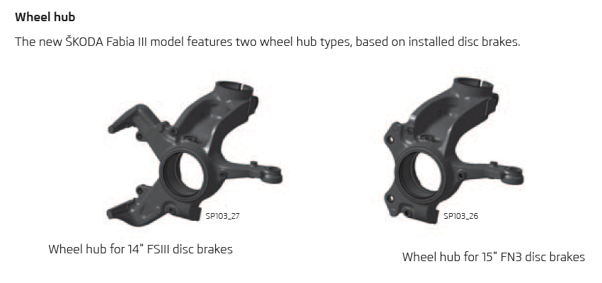

The main thing I’m stuck with at the moment are; As the carriers are moulded into the steering hub housing on my car (and this also going by the name of wheel hub, steering knuckle and stub axle really didn’t help trying to understand the parts), I believe I need to try and find the steering hub housing and wheel bearing from the 110hp variant?
Whenever I search by the version of the car for compatible parts, I seem to be getting all different results. For example with the Wheel bearing kits listed as compatible, they have all different outer and inner diameters. Does anyone have any advice on this? Or does anyone know the OEM numbers for both these parts please?

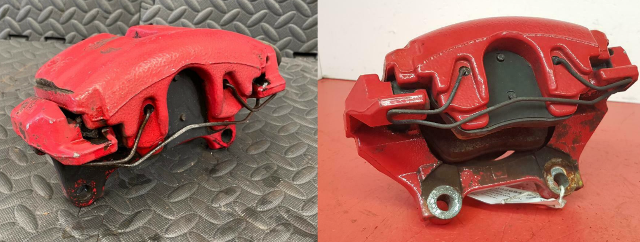

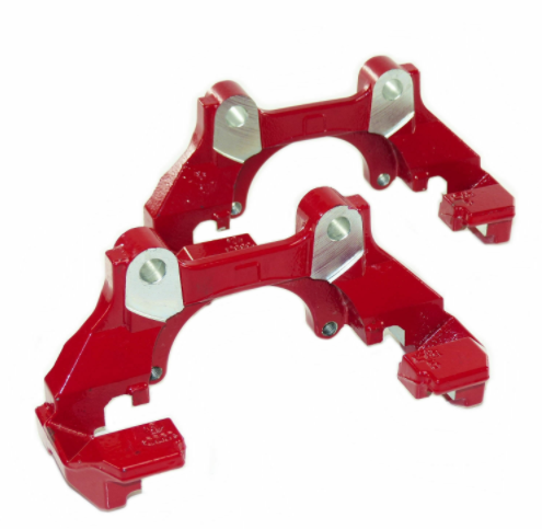

Calliper and carriers
These will be from a 2009 Golf GTI for 312mm discs. In appearance, these look identical to the 2016 Polo GTI calliper. I found the Golf GTI had a bolt hole circle of 112mm while our Fabia’s and polo gti has 100mm. Hopefully that won’t affect the calliper and carriers as they don’t connect to them.
Brake pads - These are the for the Polo GTI calliper - Brake pads marked for the old Golf GTI have wear sensors or are much more expensive which is strange considering I think it’s the same calliper and the same pads?

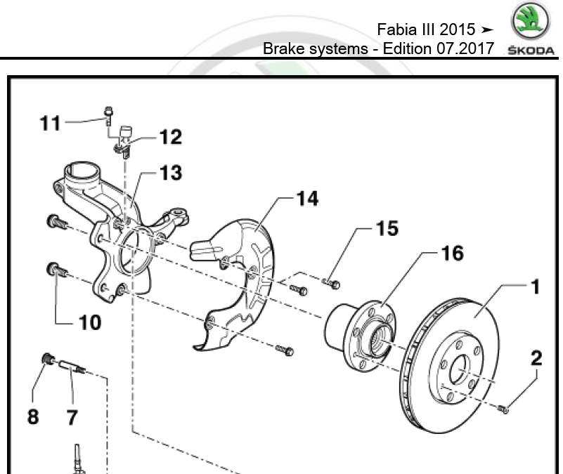

Dust shields – A few things I’d like to check with these! The website says these Polo gti dust shields are compatible with the Fabia Mk2 and they look identical to the dust shields in the brake systems manual for the Mk3 [pictured 14]. The website says these are for discs in diameter of 256, 288 and 312mm. I know the current ones on my car have a lip on them so any bigger brake discs wouldn’t fit. I couldn’t see any dust shields specifically for 312mm.
Left - https://www.autodoc.co.uk/topran/8878076
Right - https://www.autodoc.co.uk/topran/8878077

Stub axle - On the website, the right comes up saying doesn’t fit. The part number is 1 different and lists most of the other cars the left one supports so I suspect it's a website error saying it doesn't fit?
Left https://www.onlinecarparts.co.uk/ridex-13633968.html
Right https://www.onlinecarparts.co.uk/ridex-13633967.html
They won't fit, spacing is different on the carrier.
