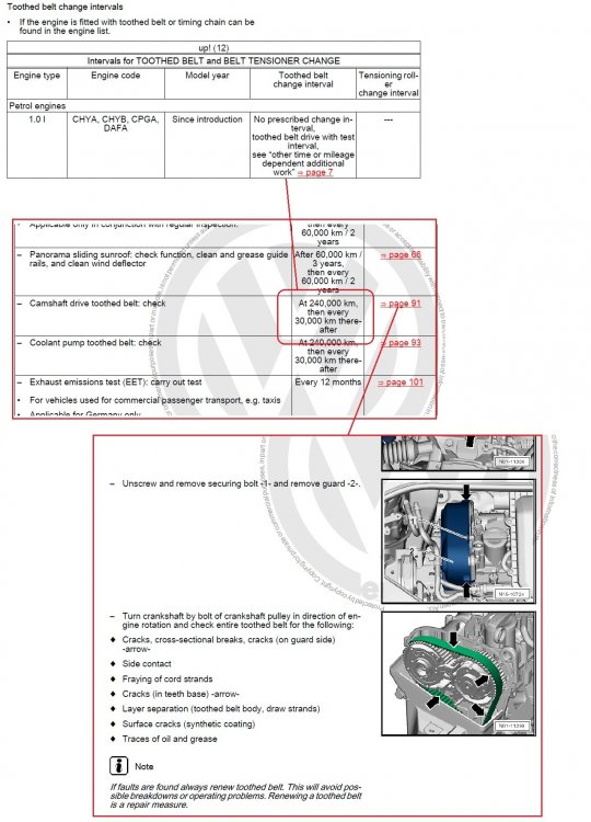

> unsure about cam belt ? When it would need changing ?
VW (designers and manufacturers of the CHYA/B engines) recommend inspection of the cambelt at 240 000km (160k miles) and to replace if worn. Water pump is belt driven off the gearbox end of the exhaust camshaft.  Cambelt is PTFE reinforced and the cam gears are tri-oval, so wear isn't the problem that it was on previous engines.
Clutch wear is pretty much relevant to previous use and whether the driver has been kind to the transmission.
Cheers...Snaefell
As per Up! Forum, personally I'd check condition every couple of years....
