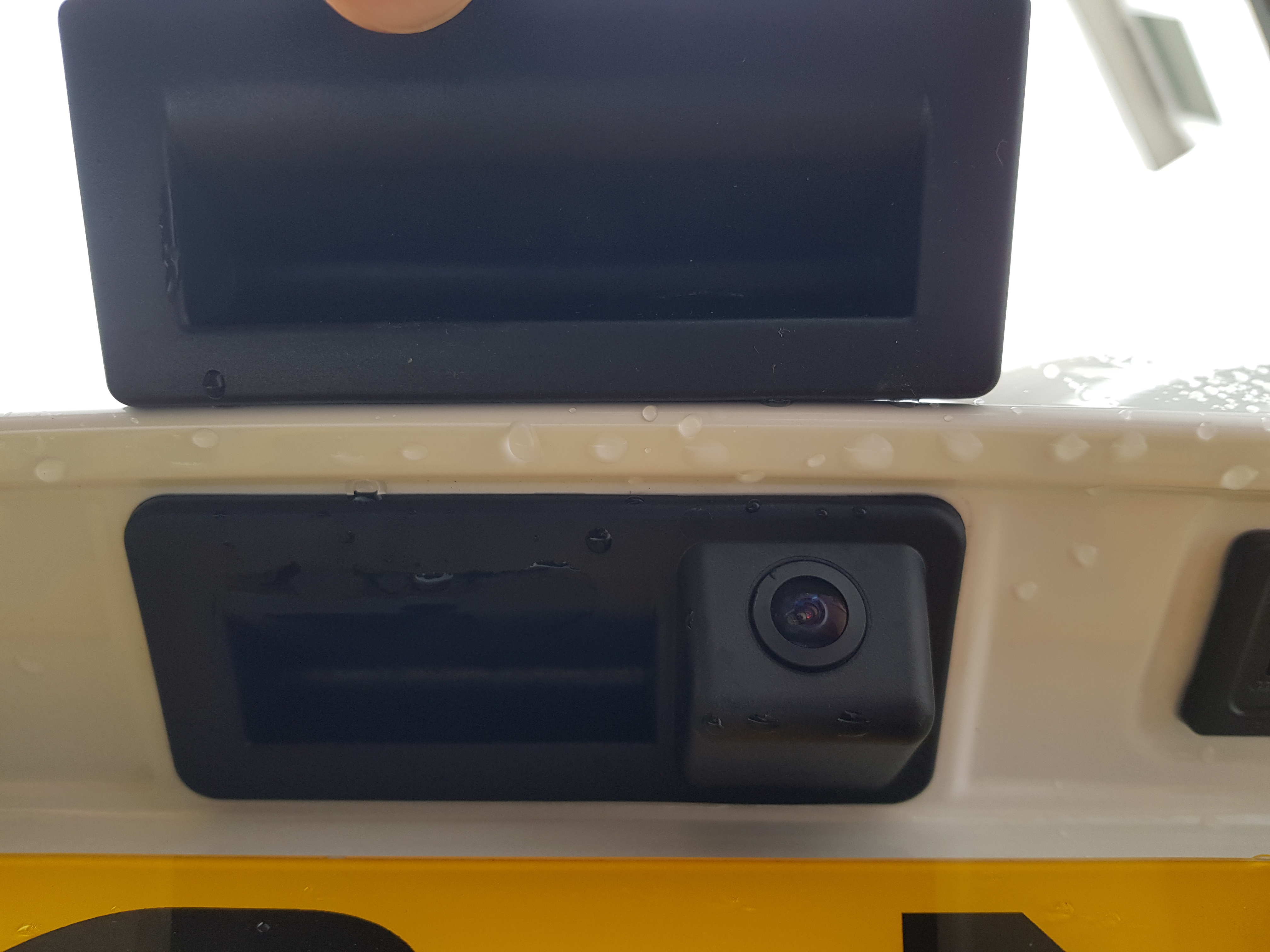

If your boot handle is 90cm, that's not tiny, that's the best part of 3 feet! :D
Seriously though, you shouldn't need to cut anything, just make sure you buy the right camera.
That said, I've just measured my handle and it's 110mm wide, so 90mm does sound quite small.
I guess a fellow combi-owner might be able to help.
As you can see from my pic, you lose a fair bit of handle to the camera.
Haha ah yes, well spotted :D
Yep I’m certain it’s 90mm x 35mm, give or take a few mm, so no chance of the cameras listed fitting.

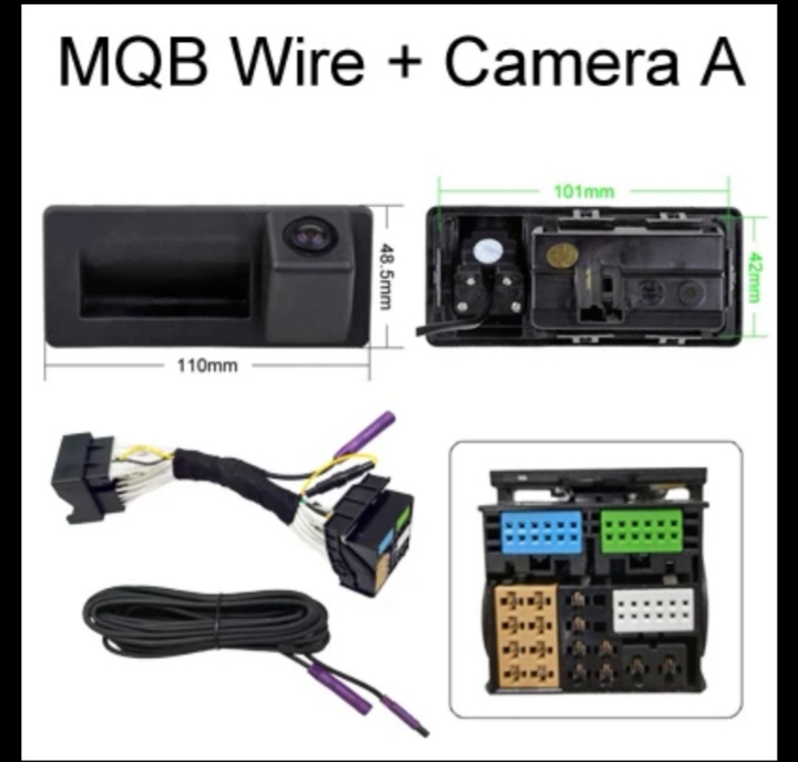

To address your problem though, what about this one? It seems to tie up with your handle size.
https://www.aliexpress.com/item/4000230897829.html?spm=a2g0s.9042311.0.0.40694c4dTEPT93

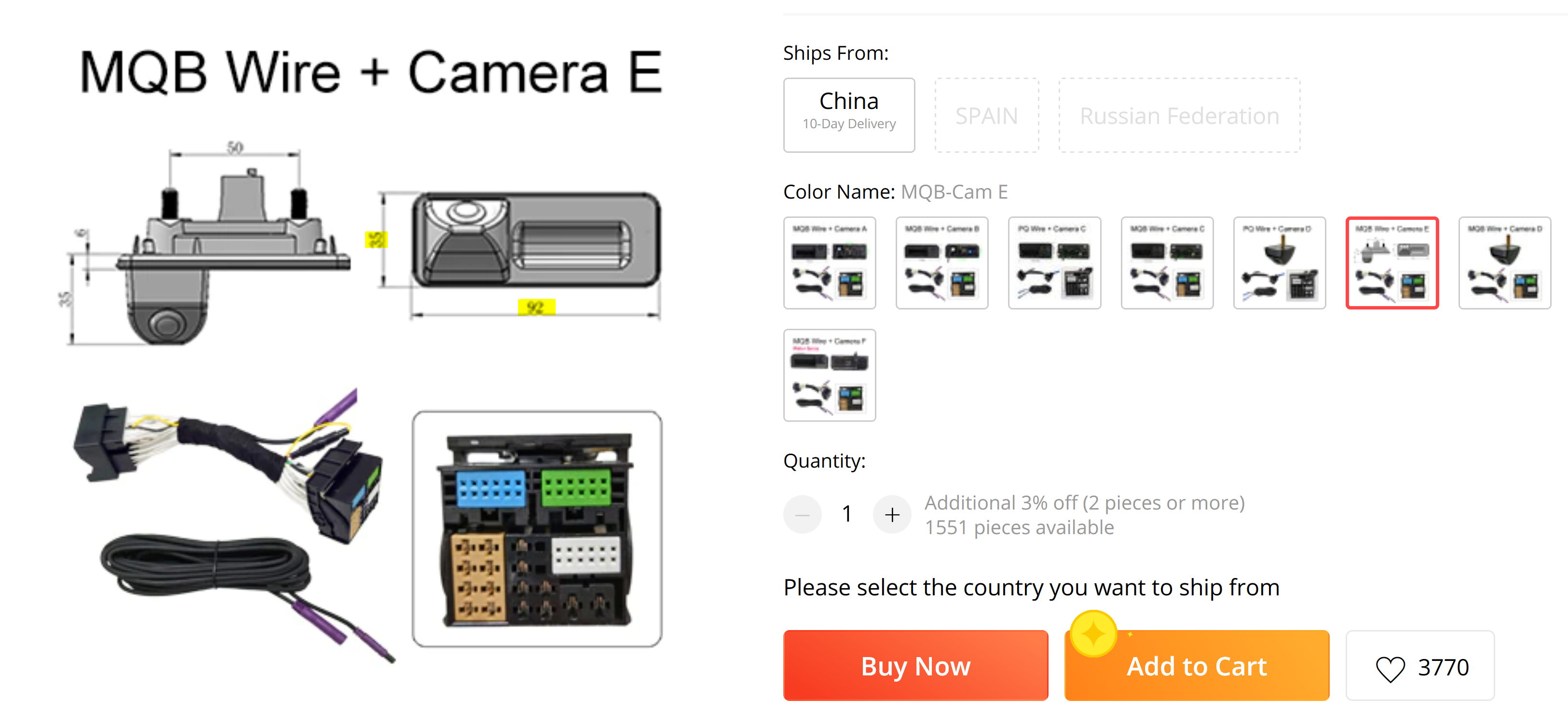

No need to cut anything. Mine was 90x35 and I got the below one and it fits and works greatly:
Good work all - there should be a camera for each size handle so it's just a case of measuring and finding the right one
Amazing lads, thanks very much for your help 👍🏻 Saves me bodging a perfectly good boot handle, even if it will just be a one finger opening operation with the camera in there as well :o
@vahid The camera E option is the correct size for me, but do you know if the MQB connector supplied is compatible with a MIB2 Amundsen head unit? My car is a late 2014, but I have upgraded to a newer unit so I just didn’t want any complications if they can be avoided.
thanks again.

@RobMac1 I have also upgraded to MIB2 and the MQB connector which comes with the camera perfectly matches the unit. Also, I don't have any issue regarding the handle side with the camera on the side.
