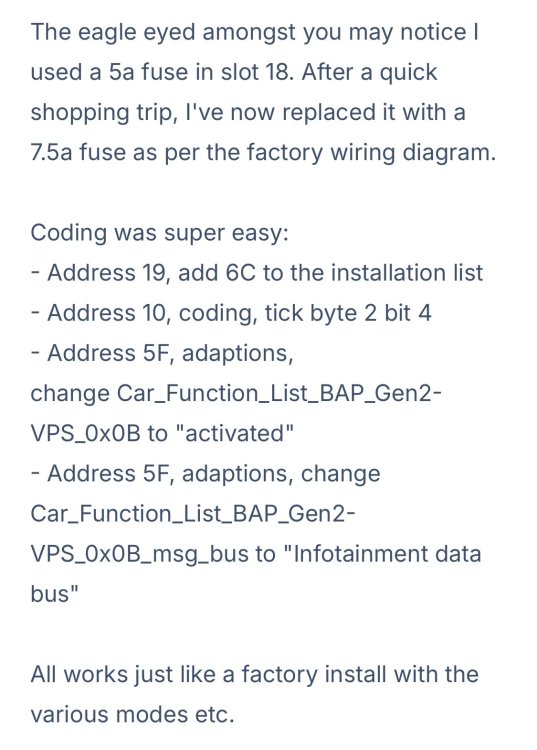

As per advice earlier in the thread, I've pulled fuse 12 with no success. Also removed harness and reconnected. Grateful for any ideas on what else to try?
As a follow-up in case someone else encounters the same issue, resolution found:

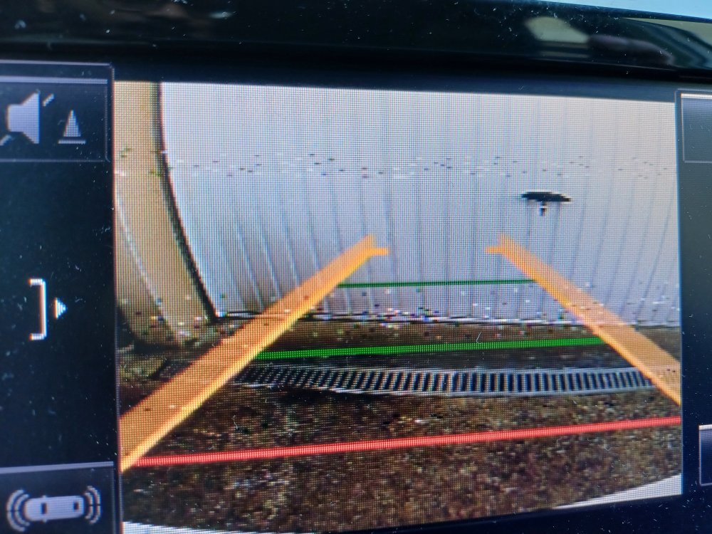

As there seems to be a lot of people asking questions about this lately, I thought I'd put together a quick guide showing how I fitted my reverse camera to a facelift VRS hatchback. They way that i've fitted this will apply to most models, with the key differences being the size of handle (based upon car model year) and whether hatch or estate (but this is just inside trim differences), there may also be wiring loom differences for earlier cars or none VRS models. I've benefited from info from these forums so hopefully this will be useful to others. I am by no means an expert & I won't be able to answer all of your questions, hopefully others will chip in and can add other info as well.

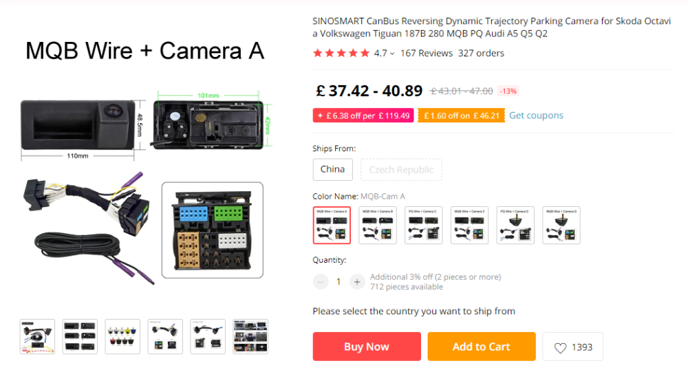

First of all, this is the camera that I ordered for my MY 2017 VRS (Camera A/Handle A):
https://www.aliexpress.com/item/4000230897829.html?spm=a2g0s.9042311.0.0.40694c4dTEPT93
 (link may no longer be valid when you read this so screenshot below)
No programming is required for this camera and it supports dynamic reverse  guidelines
Tools:
Trim removal tools would be useful, but otherwise plastic tool that won't mark your car, or screwdrivers or similar with masking tape over the end.
A T20 torx head tool is required if you have a hatchback to remove the pulldown boot strap
Cable rods are very useful, I couldn't have fitted through the roof lining without.
Stereo removal tools unless they come with your camera kit
Cable route - I went with an OEM route for my cabling, following existing cables through the roofliner and out to the back as show by the red line below.
The camera:
The first thing that I did was to check that the boot release switch was working on the new unit - there's no way you want to wire this in and find it is faulty.
You'll need to start removing the boot trim to access it. Remove the plastic clips from the lower boot trim-  this consists of a few plastic clips which easily pop out with trim remover/screwdriver. There are 8 of these on the hatchback.
After that  start removing the upper plastic trim, this simply requires forces to release the metal clips. You don't need to remove all of this for now, but it will all need to come off later
Remove the lower upholstered trim covering the tailgate. More metal clips - work your way around. You'll also need to remove the pull down strap with the T20 torx head. When this is down you should be able to drop the boot liner which will give access to the boot release handle.
This can be awkward to remove, but can be done by pushing in the clip on one on the ends whilst also pushing down on the handle from the inside (ignore the clips along its length) - it should then pop out. Repeat for the other side.
Unplug the harness and plug the new handle in - check the release switch works. You can either now push the new handle in until it clips, or leave it out to test the video connection later before fitting.
To wire it in
Remove the glovebox (open, rock left to right whilst pulling up & you'll hear the bottom clips release. Raise the glovebox lid up and inside the housing and reach in and remove the dampening on the left hand side)
Use the stereo release keys to release the multimedia unit.
The kit used here comes with a replacement harness that sits between the original one and the media unit & includes the video feed cable. Some people have removed the upper glovebox section to provide more access, be careful not to unplug the airbag connector if you do this. This can be fiddly, but I found the best way was to lie on my back with my head in footwell looking up at the unit from underneath. With the media unit slid fowards this gives access to the harness. It's the large one at the bottom and there is a locking connecting that needs to be pushed backwards to release. Check how it works on your replacement harness. Unplug old harness and plug it in to one end of the new one, push the harness in to the void and plug the new connector block in to the media unit. This took me a while to get it all to fit in. When done you can now test the video feed to the rear camera before your start wiring it in permanently.
I took the camera cable  over the top of the fusebox cage &  out through the side panel
I then ran the cable up the A Pillar to the roof lining and all the way to the end. Cable rods were really useful at this point, especially to get around the B pillar , and to go from the end of the roof liner through the cable exit point behind the rubber trunking where the original boot cables are. You can also run the cable in the trim above the sill and work your way back up to the roof lining on the C pillar. When you get to the end of the roof lining you'll need to unclip the rubber gator at the top of the boot so you can get the cable out of the roof liner and in to the boot via this gator. If you install the same way as me you only need to peel the roof liner down a few cm, being careful not to deform or damage it and you'll see the OEM cables behind.
Once you've got the cable this far it's a case of feeding it through the rubber gator, up the side of the boot and over to the handle; connect the video cable and tidying up any spare cable.
Everything should now be up and running. Retrace your steps to refit your trim. You now have a fully working reverse camera, activated when reverse is selected and with dynamic guidelines. The parking sensor guide now shifts to the left of the screen the same as an OEM reverse camera.

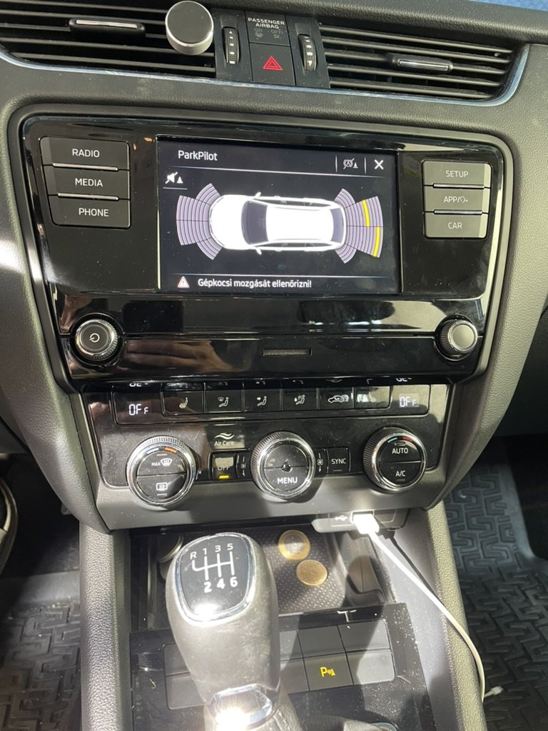

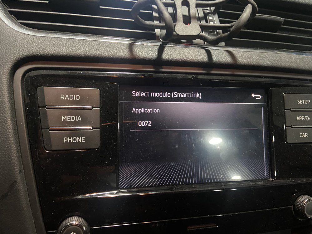

Hi,
I have found this topic recently, when I was trying to find solution for my problem. I hope, I found the right place. 🙂 I have read through the whole topic, but unfortunately, I did not come any closer to my solution.
So, my case: I have a 2020 Octavia 3 Combi model (just before the facelift), and I have bought a 3rd party rear camera. I have installed it, and the camera itself seems to work properly, at least there is video signal at the radio head. On a 3rd party monitor there is the image, but I would like to use the original screen. Still, I cannot see any image on the radio screen. The camera is enabled in the system, that is for sure. But I just do not know, what the problem could be. I do not have any control unit in the glove box, (I don't know why) so I could connect the camera to the back of the radio unit directly. On other forums I have read that it is OK anyway. I have radar in the car, which activates automatically when I switch the reverse gear. Is it possible that in order to have the camera image on the radio, I would need to disable some other feature in the system? E.g. radar? I totally ran out of ideas, so anything is welcome.
I also tried to connect an old VHS camera through RCA to the radio unit, but there is no image at all on the main screen. Only radar.
I hope I could write my problem clearly. English is not my first language. 😕
Thank you in advance for any help.

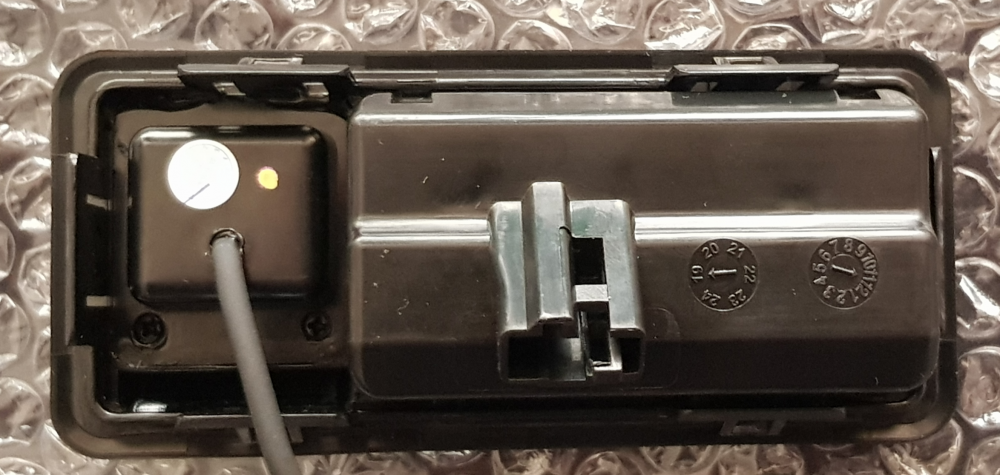

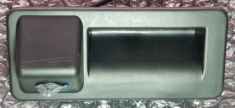

On 22/10/2020 at 11:48, EnterName said:
Hi @weyland
Just by chance, have you a clear image of the rear of the camera you fitted?
I ordered one from the link you provided, however the camera I received is not quite the same as the camera in their description.
I think it's just a slight product modification, but I'm wondering if your camera is the same as mine, or subtly different.
Here's what I mean.
The three cameras possible to be ordered are A/B/C taken from the AliExpress link. (I've ignored camera C as it's clearly completely different.)
image.thumb.png.5f5036fee03f8289b5c523530bbcabd3.pngimage.thumb.png.5cb67831aeb269edefdcc05487526abe.png
And here's what they sent.
image.thumb.png.1c1d32fd0447adadb84f6b3c384570ed.pngimage.thumb.png.a7960bd71cf0af1f96734940156b9b02.png
The profile and dimensions of the camera (the important stuff) match Camera A. However the back wiring image seems to match Camera B.
It's not an issue, but it did cause a minor "Awwww Hell!" moment when I first looked at the camera. :D
I'm wondering if there are a few different suppliers of this camera, and they just send what they have, so long as it works and fits.
From the other side, my camera appears to be the same as yours, so I guess it's just a slight difference between their product image and what they actually send.

Sorry !!! How do you open your trunk ?
Where is the button in the new camera part ?😅😅😅
On 07/07/2024 at 13:26, Ravast said:
Hi,
Ravast
I haven't seen this kind of head unit before and the fact you don't have the media unit suggest this is a more basic head unit that may not be able to accept video signals
As the new camera & boot release occupies the same size hole, the recessed boot release handle is smaller but still has a rubber micro switch in a similar place to open it.
Thank you so much !
It's built into the handle, as per the regular Octavia boot-switch handle.
Okey thanks !

Hey, I have recently bought the camera from AiDu on AliExpress and installed it successfully on my Octavia 2019 estate. There is a thing that i want to say, the picture quality is ok but original is probably better.
I have got a question, the camera view goes away as soon as I switch into D from R, is that normal behavior? On Audi it turns off after some speed threshold...
