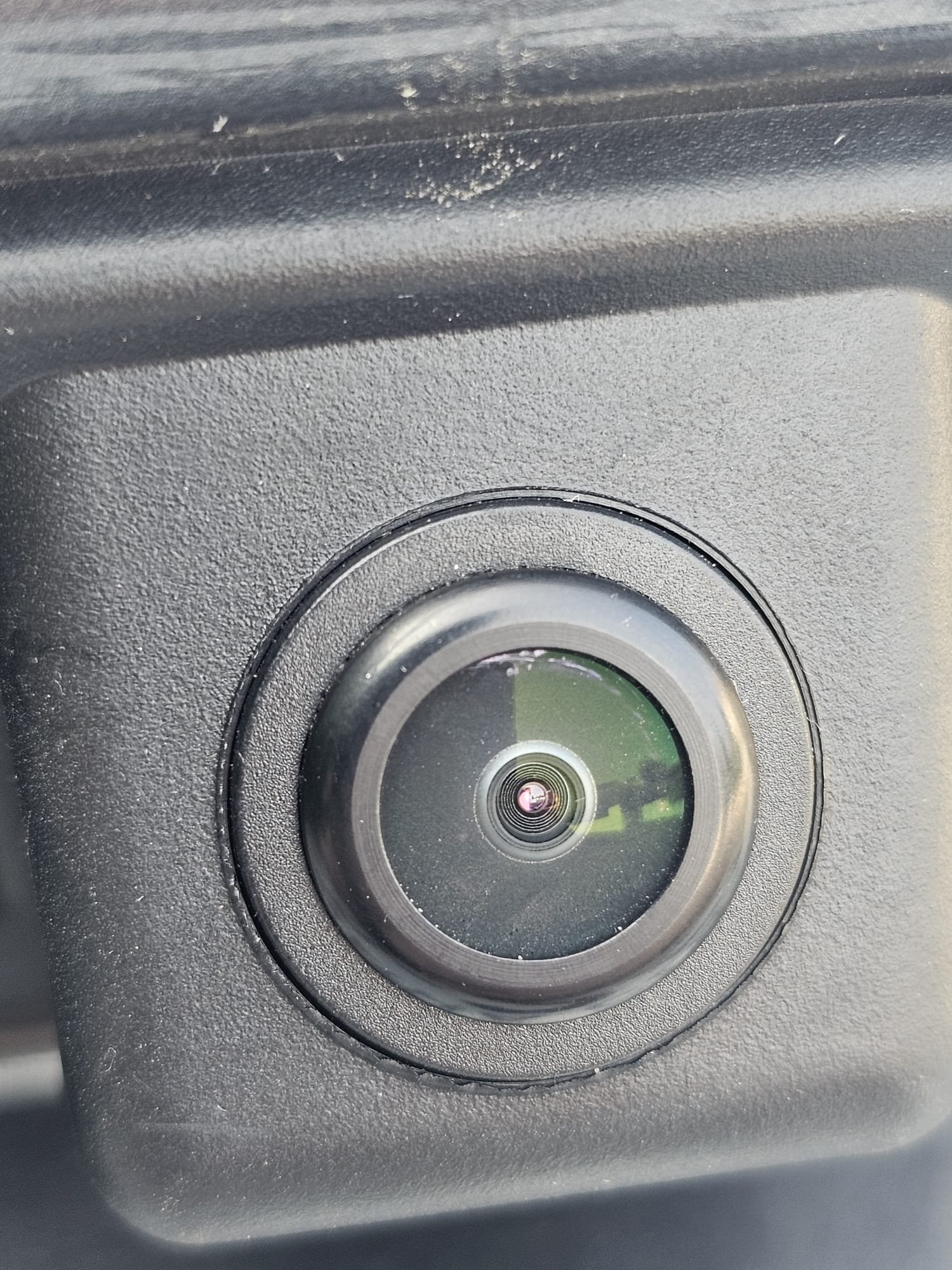

The other thing I'm wondering is if there could be a second protective film on the lens?
I took one off when I first installed the camera, but when looking carefully at the lens, I do wonder if there is a second one??image.thumb.jpeg.6febd9fbae898da532d2afcee5cadf7e.jpeg
Edited by mojos

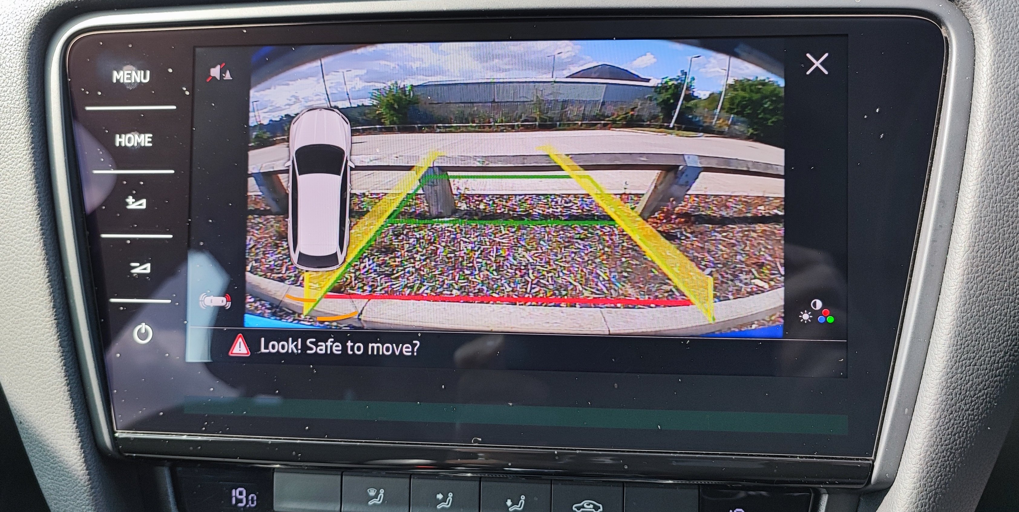

I have just recently completed installing a camera, so many thanks to @weyland for the original post and detailed install information.
My car is a 2015 Octavia estate but has the updated MIB2.5 Columbus infotainment system. The Aliexpress listing for the plug and play version specifies that it is compatible with 2017 onwards 'facelift' cars only - I took a chance that this refers to the infotainment system rather than the vehicle as a whole and the good news is that it does - the camera works perfectly including the guidance lines.
I routed the cable up the A pillar and through the headlining, guided by a length of stiff garden wire and it was easier to do than I feared. The hardest part was the final bit inside the tailgate, with a stubborn plastic rivet to remove the upper trim panel and the guide wire getting caught up inside the box section 😠 Some mild swearing was involved but I got there eventually...
The kit I ordered was MQB-Cam A link here and the boot handle/camera is a perfect fit in the tailgate. For just under £30 delivered this is a great upgrade to the car.

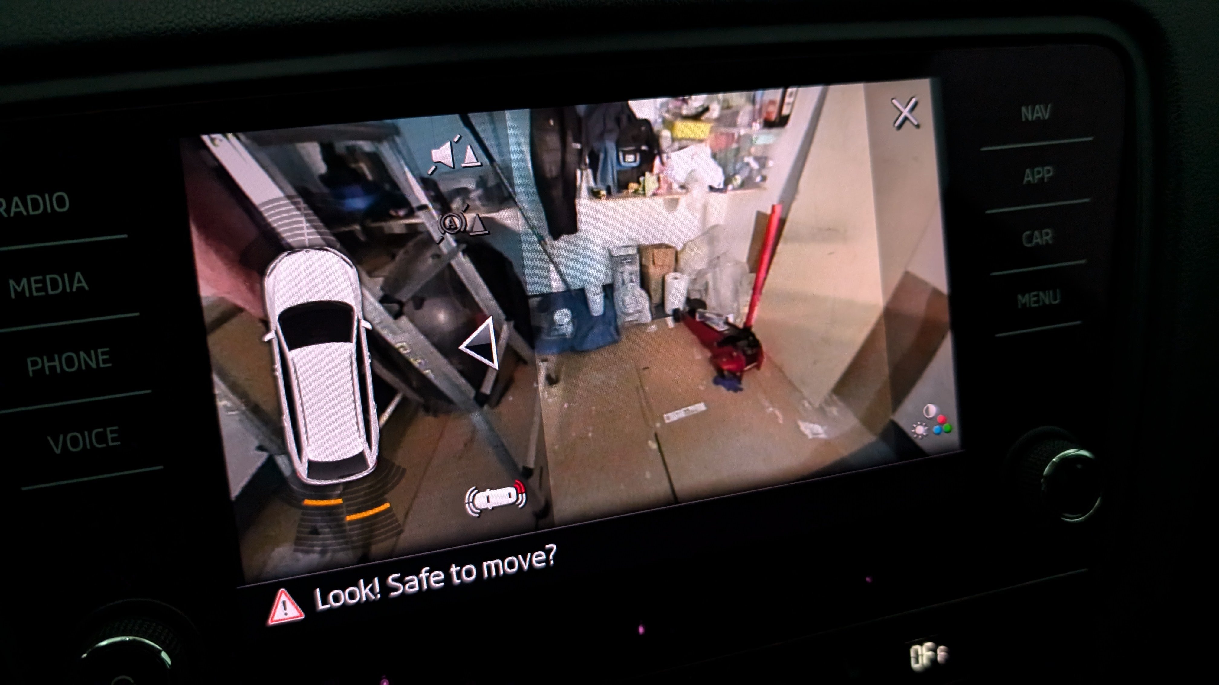

Thanks @weylandall installed and working now, The cable routing process was surprisingly easy.
Hi and many thanks to @weyland and all other contributors to this thread! got my camera (Cam-A) last week and decided the weekend just gone would be my D-Day.
Took about three hours on Saturday and half an hour on Sunday to neaten things up/make sure boot trim was back in place properly. started at the front to check the camera was working and had the devils own job of getting the media unit out and back in again once the harness was fitted, some lying in the footwell and wiggling around managed to get it back in! moved to the rear to check the new boot release switch would work which it did RESULT! decided on the lower route for the video cable as i didnt fancy getting too close to the curtain airbags, then my first error of tracking the video feed cable from front to back which left me getting the bigger end of the connector through the boot gator/grommet..... good 45 minutes, a lot of swearing and a sore back later it was through and fed though the left boot panels to be plugged into the boot release plug and jobs a goodun, all works perfectly, probably just take a little time getting used to it but its really good for the money!
anyone reading this thread wondering if they can or can't do it, just go for it! the knowledge and information in this thread is invaluable and helped me a lot! so did a good set of trim removal tools from amazon and a multlibit screw driver from Aldi with the torx bit required the inner boot pulldown! now onto the list of new black badges and a maxton kit, i'm feeling very brave and very mekanic!

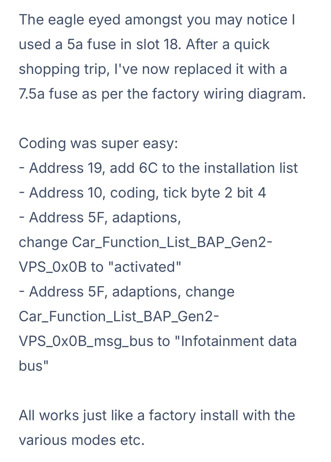

What I tried to do in VCDS:
1) Address 19, add 6C to the installation list
2) Address 10, coding, tick byte 2 bit 4
3) Address 5F, adaptions, change Car_Function_List_BAP_Gen2-VPS_0x0B to "activated"
4) Address 5F, adaptions, change Car_Function_List_BAP_Gen2-VPS_0x0B_msg_bus to "Infotainment data bus"

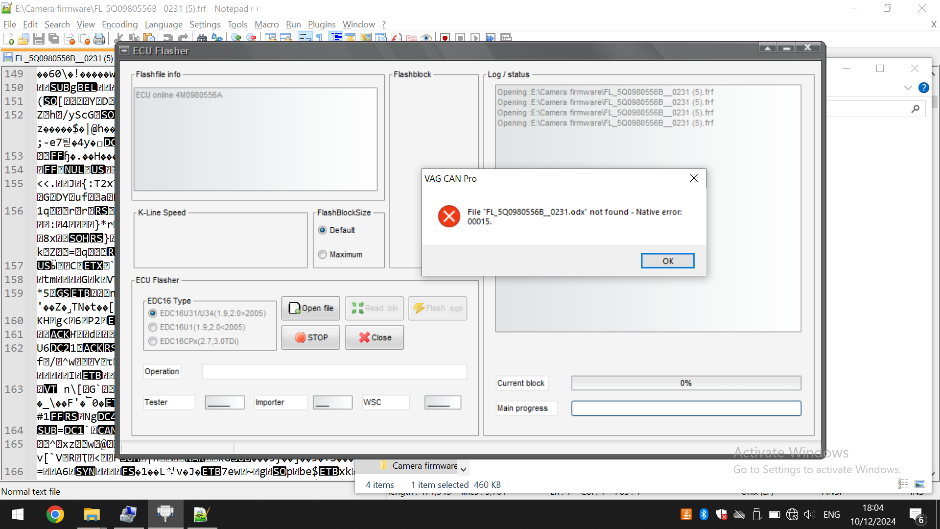

Thanks! I talked to the seller and he gave me these two files to flash the camera and I hope I can flash it with ODIS + VAS5054A, once I do that I will update. Cheers.
FL_5Q0980556B__0231 (5).frf 速派 5Q0980556B (3).xml
FL_5Q0980556B__0231 (5).frf 460.88 kB · 2 downloads 速派 5Q0980556B (3).xml 297 kB · 2 downloads
I can't flash the camera. Does anybody know why the VCP won't allow me to use the frf file and throws the following error "File "FL_5Q0980556B__0231.odx" not found - Native error: 00015"?

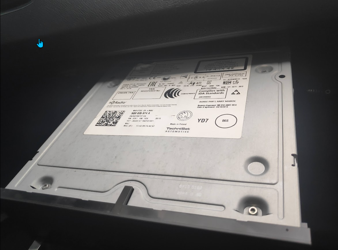

Remove the glovebox (open, rock left to right whilst pulling up & you'll hear the bottom clips release. Raise the glovebox lid up and inside the housing and reach in and remove the dampening on the left hand side)
Use the stereo release keys to release the multimedia unit.

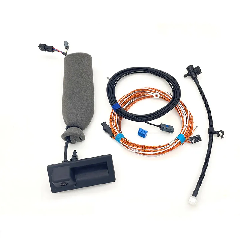

The kit used here comes with a replacement harness that sits between the original one and the media unit & includes the video feed cable. Some people have removed the upper glovebox section to provide more access, be careful not to unplug the airbag connector if you do this. This can be fiddly, but I found the best way was to lie on my back with my head in footwell looking up at the unit from underneath. With the media unit slid fowards this gives access to the harness. It's the large one at the bottom and there is a locking connecting that needs to be pushed backwards to release. Check how it works on your replacement harness. Unplug old harness and plug it in to one end of the new one, push the harness in to the void and plug the new connector block in to the media unit. This took me a while to get it all to fit in. When done you can now test the video feed to the rear camera before your start wiring it in permanently.

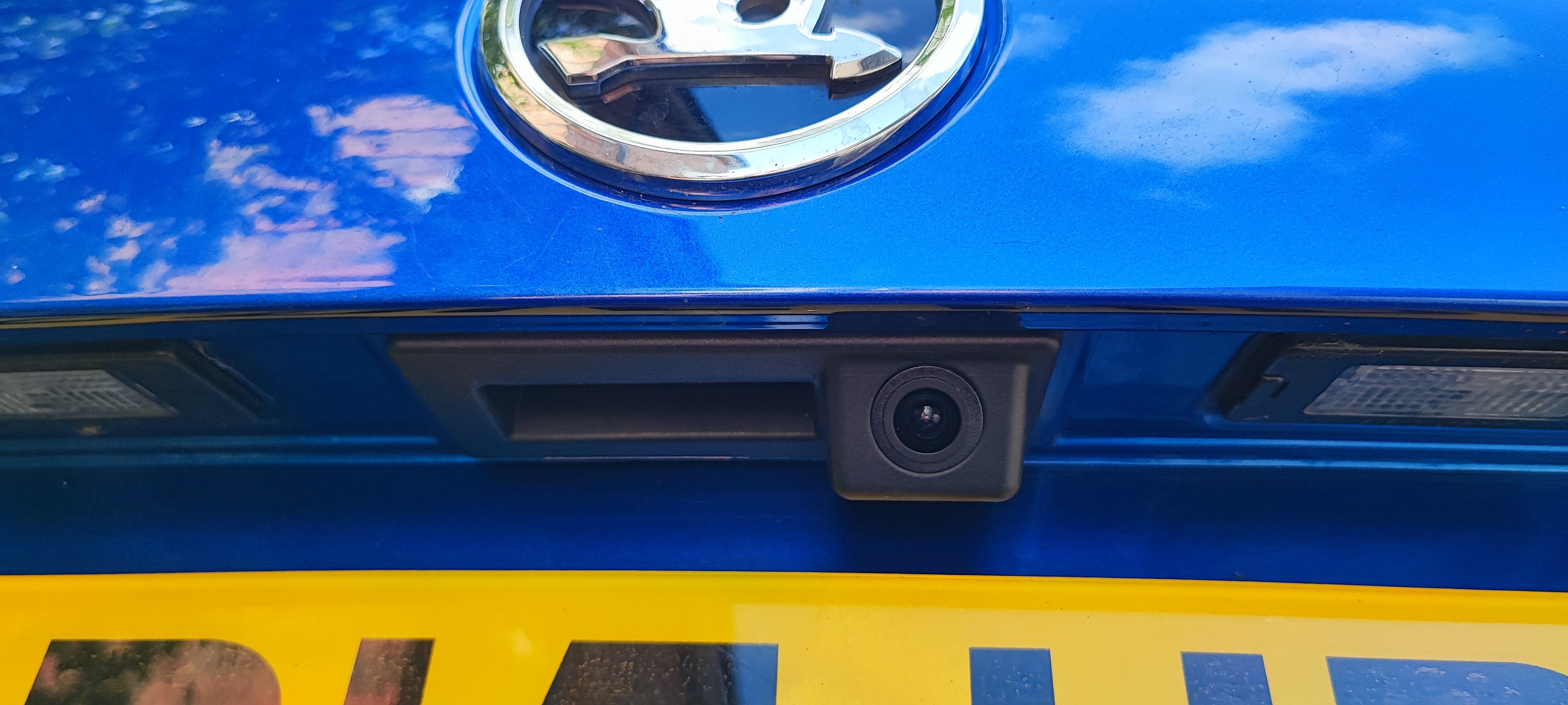

Once you've got the cable this far it's a case of feeding it through the rubber gator, up the side of the boot and over to the handle; connect the video cable and tidying up any spare cable.
Everything should now be up and running. Retrace your steps to refit your trim. You now have a fully working reverse camera, activated when reverse is selected and with dynamic guidelines. The parking sensor guide now shifts to the left of the screen the same as an OEM reverse camera.

6 hours ago, mazzy960 said:
This section of the forum has got a good usable information but in my case; I could not use it too much as my problem is related to the coding of the Genuine Skoda Camera
Did you read the second post in this thread... That contains the how I coded a genuine RVC on my Octavia.
You might need to do some extra coding as you have a trailer module so please also add a full autoscan from VCDS.
Hi Langers2k,
Thanks for your rapid reply.
Yes as far as I am aware you have got one coding instruction that i have the screenshot of the relative section below;
I did go through 4 or 5 steps but unfortunately due to the new labelling of the some components of the VCDS; then some of them appears different on my car or not available?
Even though I have tried it 3-4 times unfortunately no luck!
But thanks very much again for your time, effort and rapid reply?
Still in need of help to sort this coding business out then the smaller problem is quite unreasonable rear boot lid handle as I explained in my post above.
But if I missed some other coding instructions whilst I was reading your posts any direction provided will be much appreciated.
Regards
