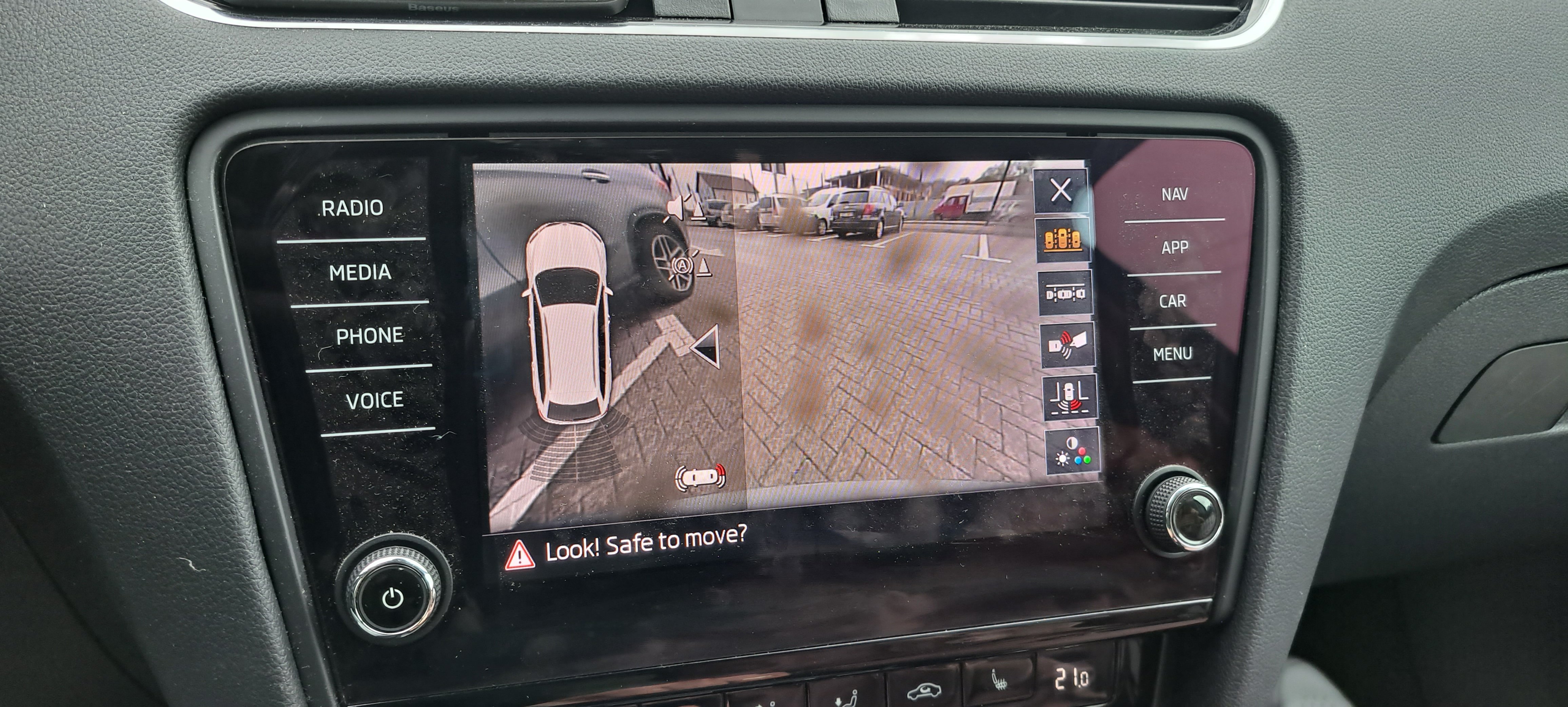

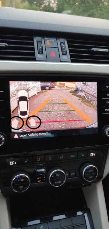

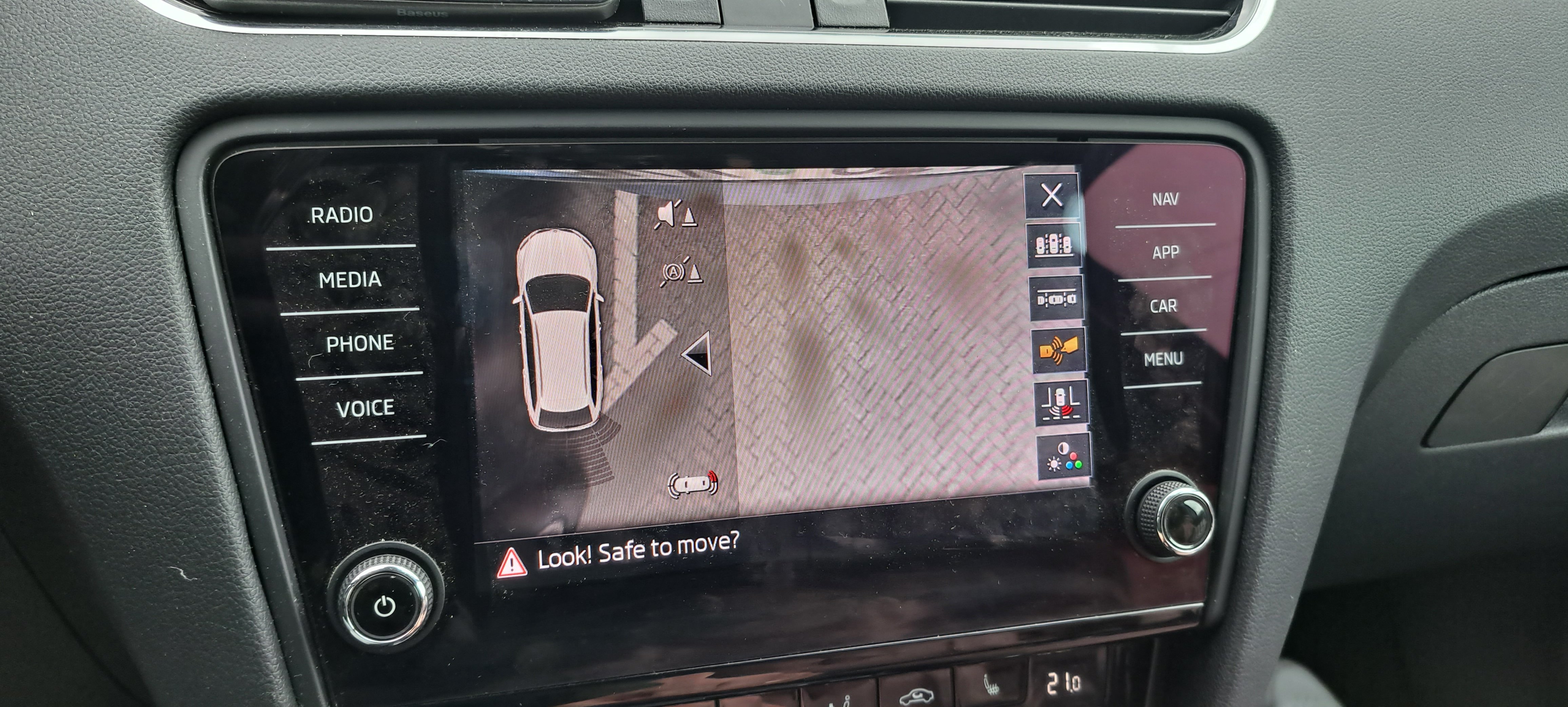

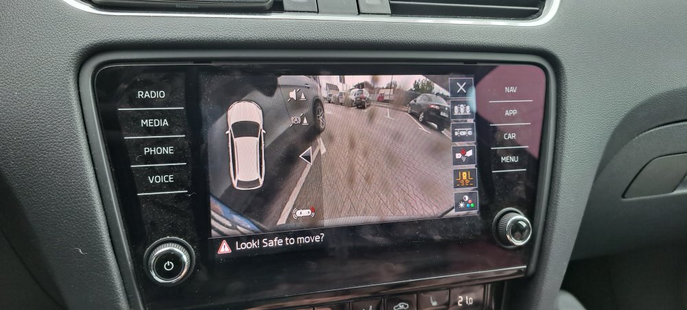

I`ve purchased a highline camera, and managed to fit it in.
I have an EU spec car with the wheel on the left, so I had to adjust a bit the wiring. Went through the right side of the car the same way as langers2k to get to the MIB unit, however I had to extend the +12V to fuse box, which is located on the driver side.
I`ve coded it similarly to langers2k, and it functions as expected, all modes are available (fish-eye, normal view, hitch view).
The only thing missing are the guidelines, and there are some errors with the camera module which I can read with VCDS however I am unable to figure out what to do next.
Any help would be extremely helpful, as I would like to get it running as expected.
You will see the photos with the way the camera works and here are the fault codes in VCDS:

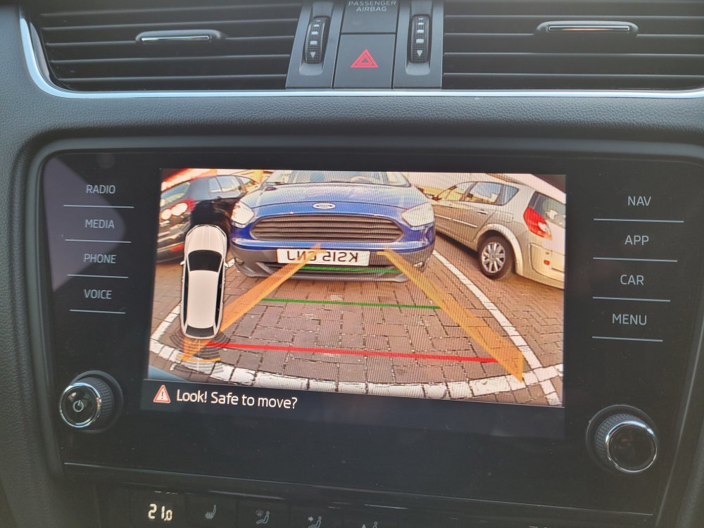

Found the issue.
My car has no parallel parking, however the option was enabled in the camera module.
Disabled it, and the lines appeared. Seems to be that the databus info being sent by the camara was not according to the expectations.
Now, lastly I need to calibrate it.

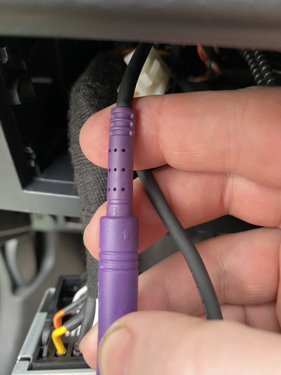

In the hope it helps people in the future, I fitted one of these kits to my 2019 vRS Estate over the last couple of days but couldn’t get it to work - very simply, no response at all when putting the car into reverse.
I contacted Sinosmart via WhatsApp for help and they commented that there’s a manufacturing issue with the dashboard end of the long camera cable. Where it connects to the converter harness, the arrows don’t align with the keyway which means that it doesn’t mate up properly if you line up the arrows (like I did originally).
Hopefully the photo attached will show roughly how the arrows should look to align the keyway, but make sure the two halves are then pressed home to make the connection sound.
