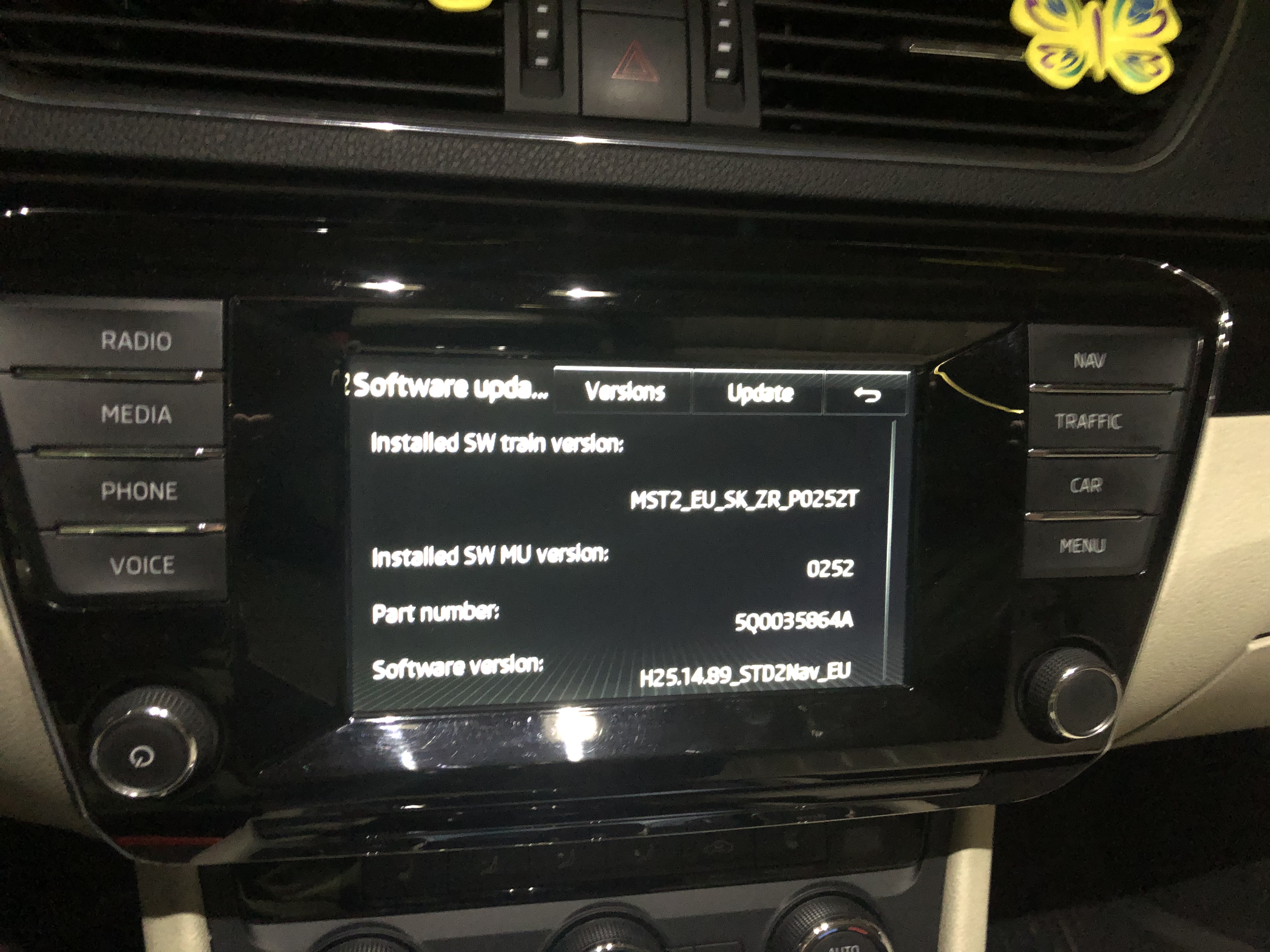

Hello, maybe someone can help with upgrading Amundsen to newer firmware than I currently have. It is now MST2_EU_SK_ZR_P0252T
MST2_EU_SK_ZR_P0253T_V0020171002.7z This is last availiable one that you can install without any tricks, but with some tricks you can upgrade up to MST2_EU_SK_ZR_P0478T.7. All instruction and FW you can find here

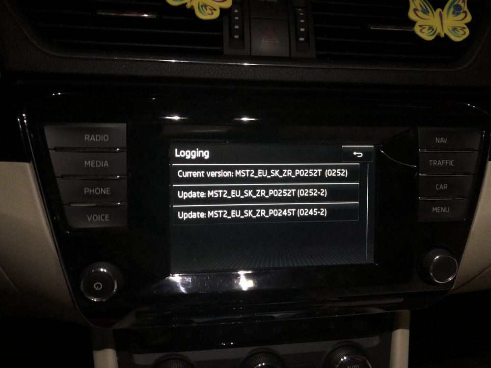

Thanks, managed to upgrade to 0253, but how to upgrade to 0478 doesn't allow writing to an older version. or I do something wrong.
You didn't read my answer fully, i mentioned that it is impossible to switch from one series to another without some tricks, as i mentioned full instruction could be found in MEGa link was provided before you need to modify some files, some post you can see, here and here and here articles how change SW or region. I don't have MIB stn i can't provide you detailes, i did only for mine MIB 2.5 high.

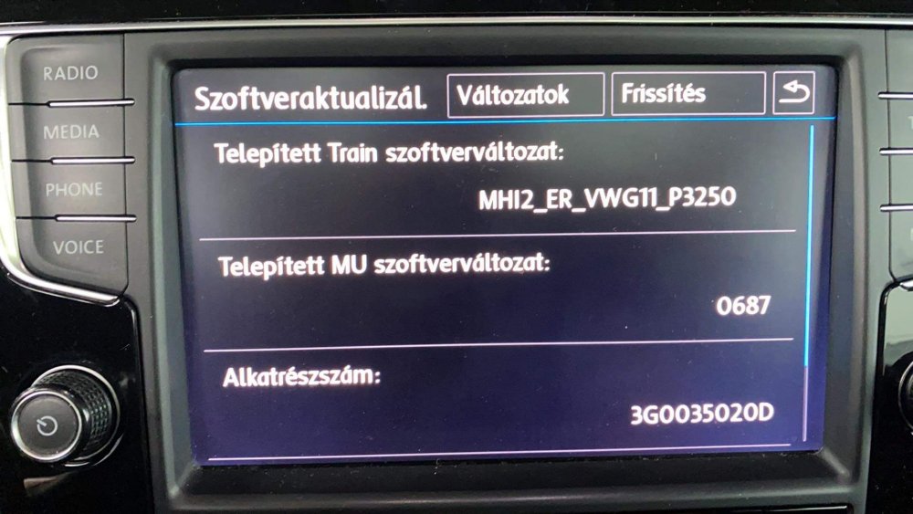

hi please give me new link the mib 2.5 thanks
My car is vw touran. this link is good?
Which file its ok?
1 hour ago, palipalesz said:
Which file its ok?
Try to download mu1427 check metainfo2 file there is support trains list if yours train in this list go ahead, if not check lower version.

Which part isn't clear? You can see your train mhi2 so open mhi2 folder then chose vw if it so then you train vwg11 any fw but my recommendation check highest one each fw contains metainfo2.txt file there is support train list. So you need just check is your fw in this list if it so go ahead, if not check lower version. So as i mention previously you need to use MHI2_ER_VWG11_K3342_MU1427 it supports (SupportedTrains = "MHI2_ER_VWG11_P3250*,MHI2_ER_VWG11_P3301*,MHI2_ER_VWG11_K3332*,MHI2_ER_VWG11_K3342*")

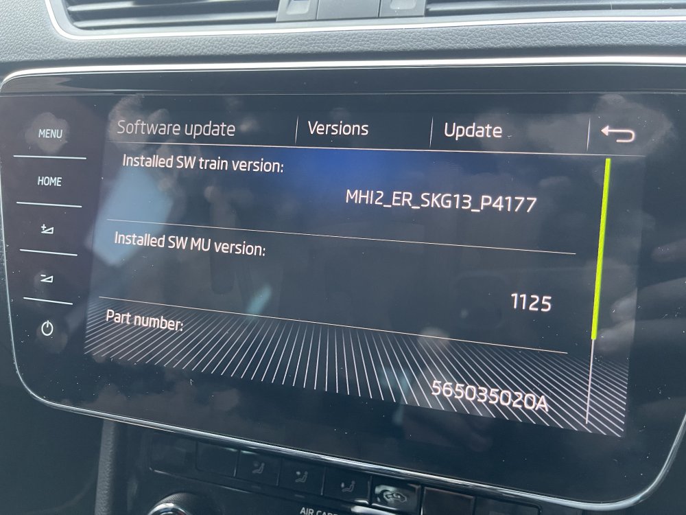

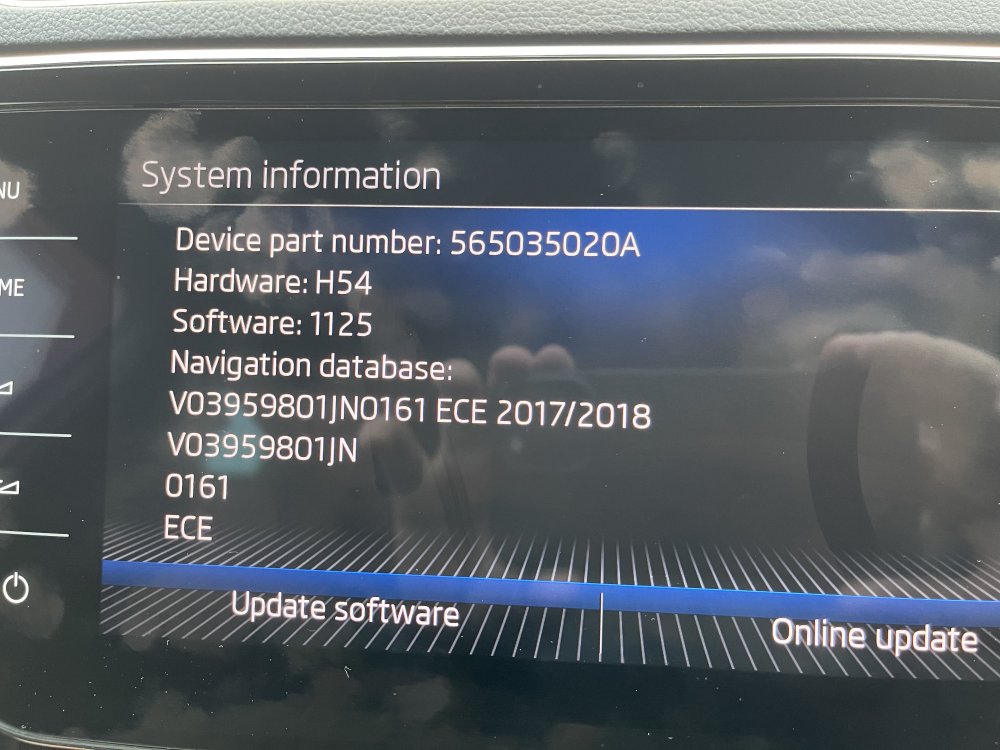

Can anyone point me in the right direction for updating this guy?
https://mega.nz/#F!r9tC3ABC!Y-HVkemvshkcSn3vWMauOw!jktw0KaQ unzip to root of SD file MHI2_ER_SKG13_P4526_MU1440.7z then update, don't copy folder with name MHI2_ER_SKG13_P4526_MU1440 you need to copy files from it to root directory of your SD card

Cheers, got it downloaded. I’m assuming this is just an update file and won’t require anything to be setup again such as car play or Skoda connect?
Nothing, except 1555 FW update error (could be found while scanning) could be easily deleted by odis VSDC obd and so on, rest of function will be the same.
