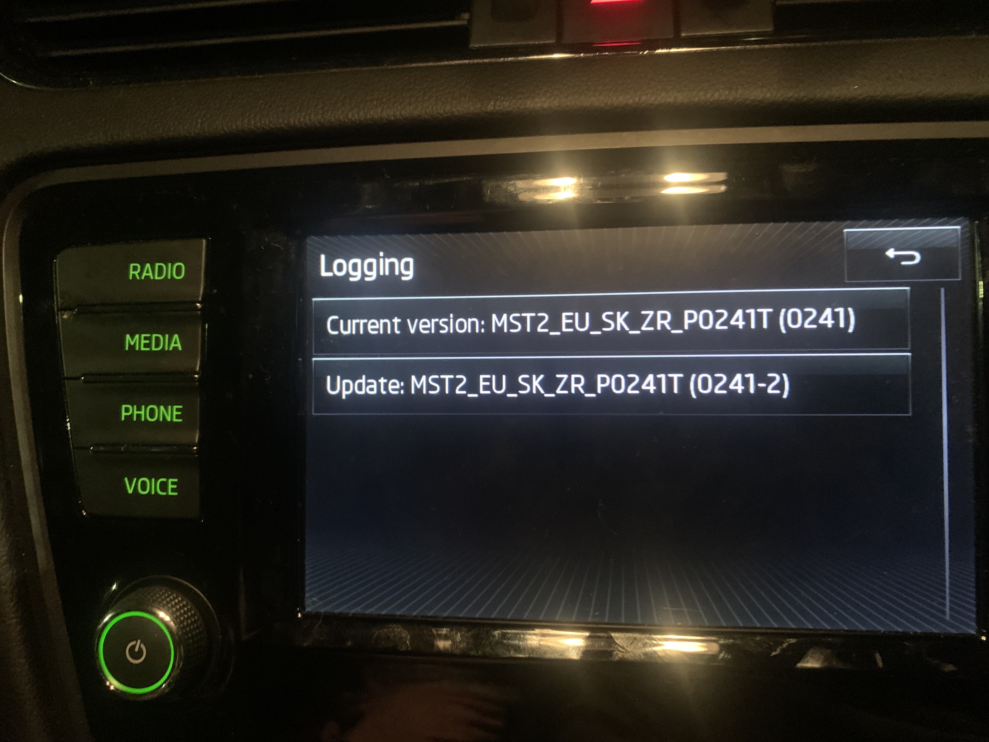

Hi Guys,
I stumbled across this Post looking for the update for my Skoda multimedia after obd eleven informed me that my software is out of date.
I currently have MST_EU_SK_ZR_P0241T , Am I correct that the update MST2_EU_SK_ZR_P0253T_V0020171002 is the correct file for my system?
Regards
Macca

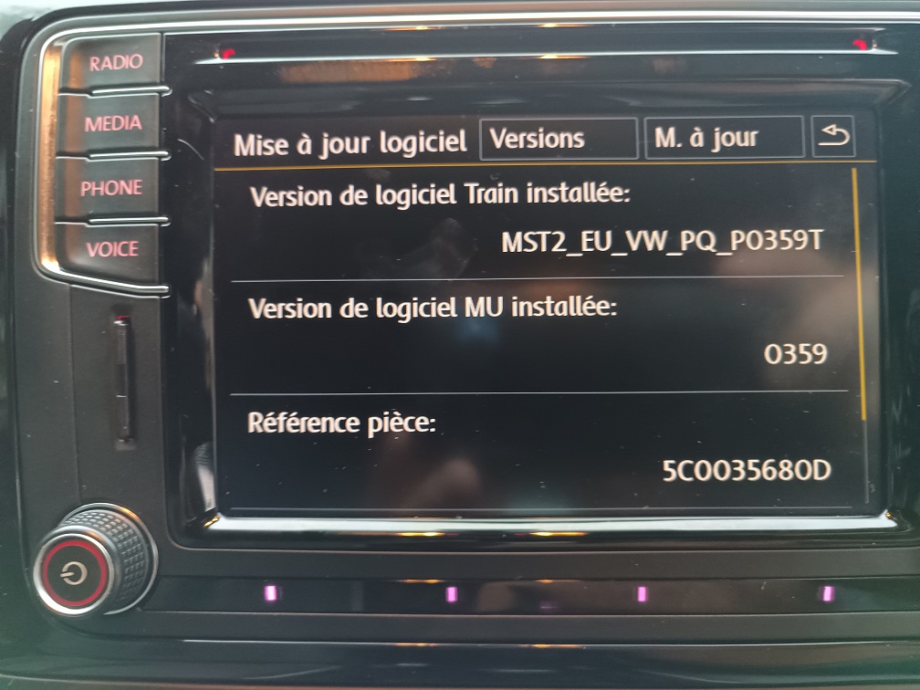

Hello everyone,
my current version is this one, I'm looking for the new update...
Do you have a link please?
Thanks
Bumping the thread on behalf of the new French contributor, if anyone can help him with this please do as infotainment is beyond my skill set. @ld31

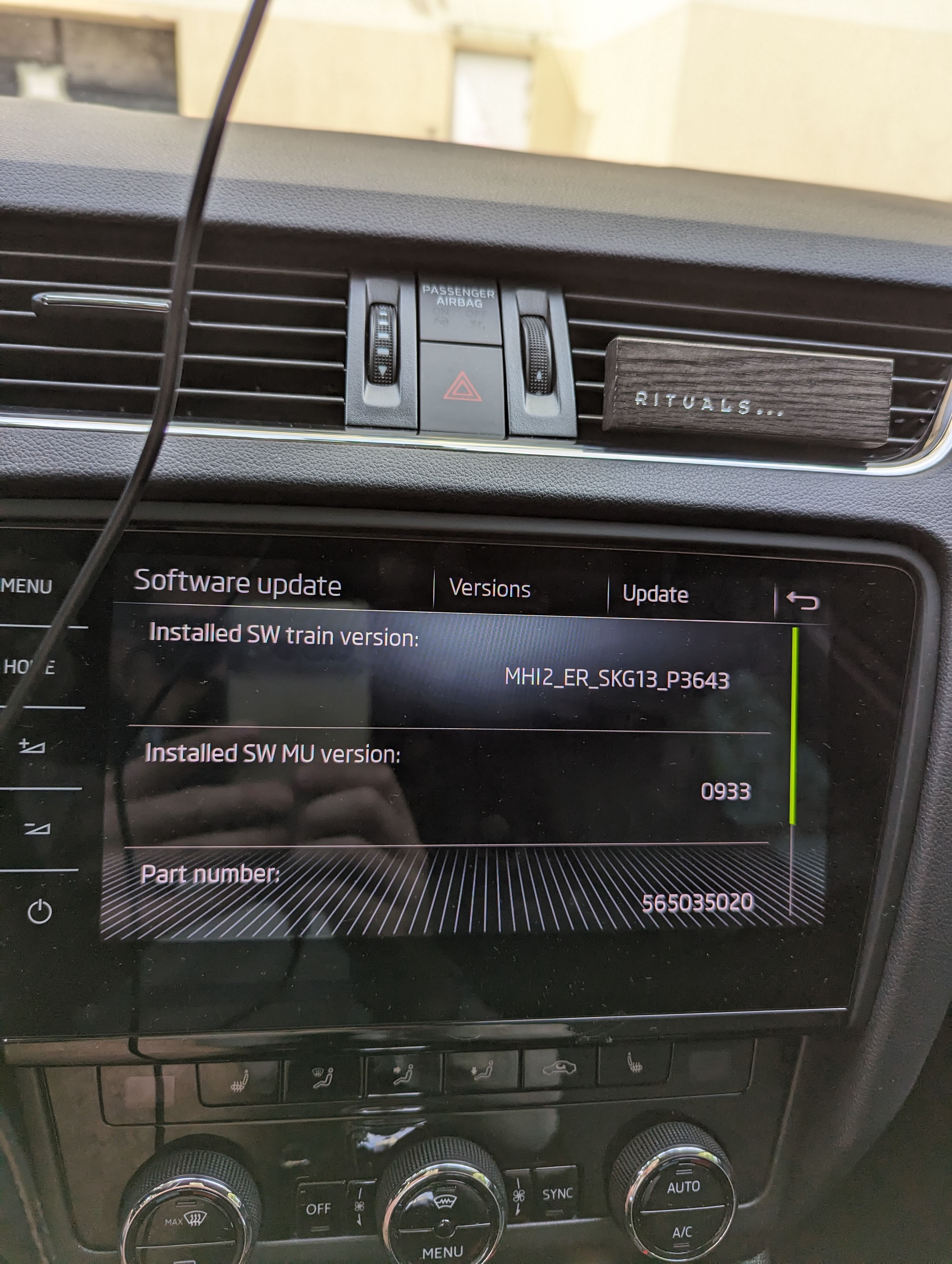

Hello everyone,
my current version is this one MHI2_ER_SKG13_P4520, I'm looking for the new update...

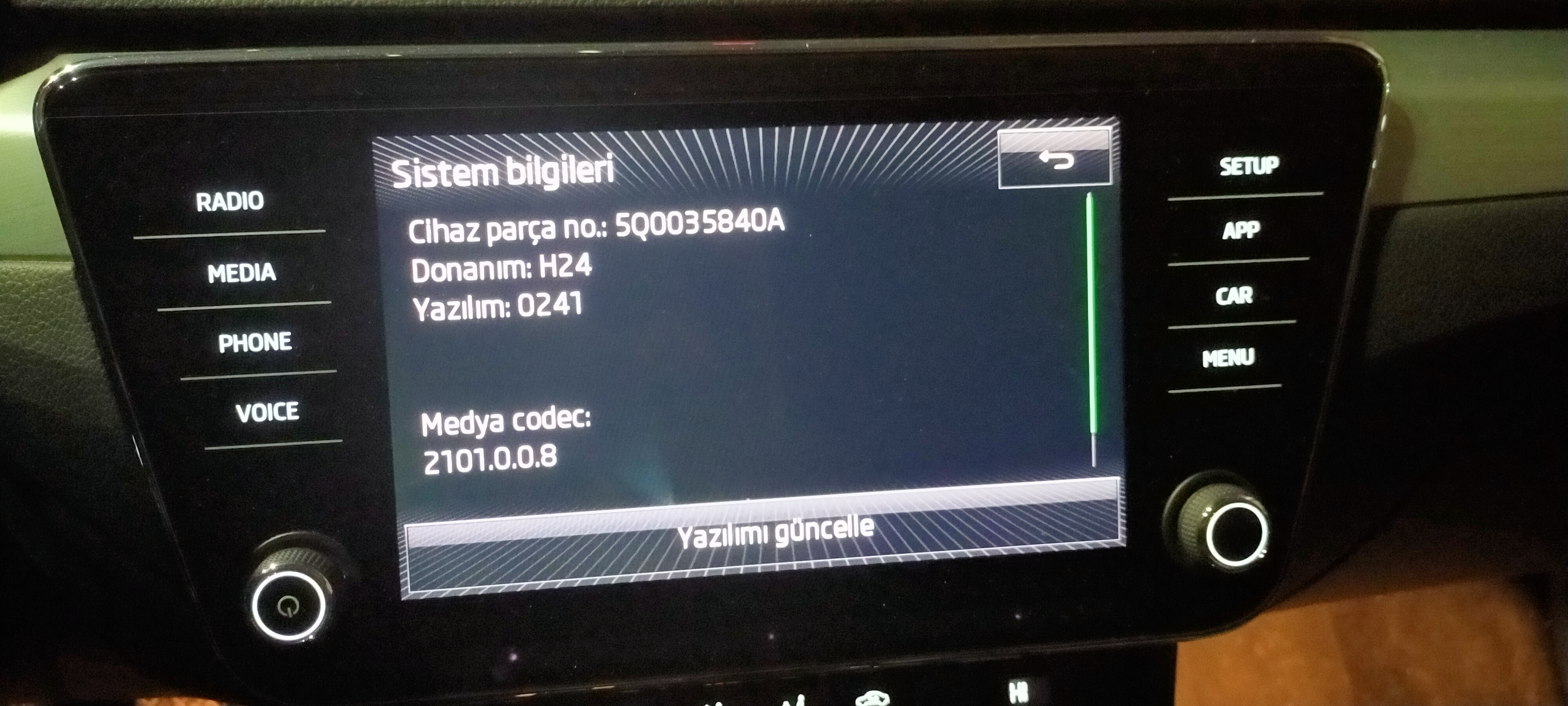

Bunun güncellemesini nasıl temin edebilirim.  @pab567Teşekkürler.
@mstkrs pls use English

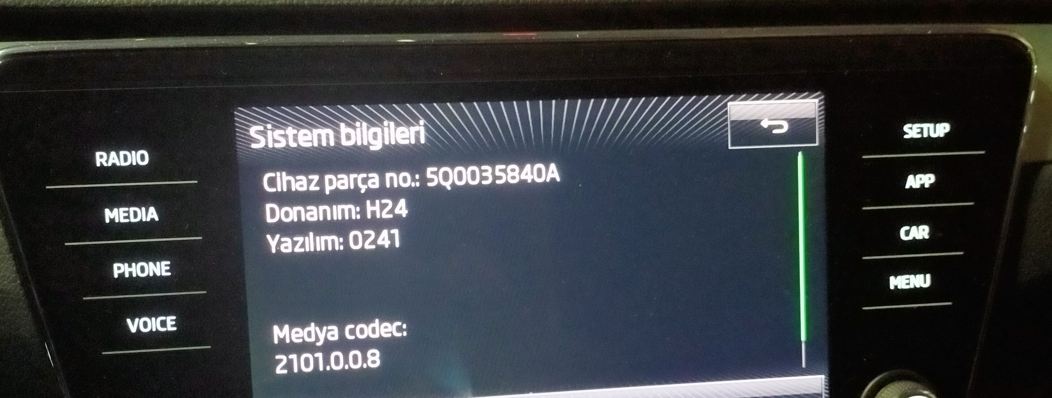

This is the current multimedia software version of my vehicle. Is there an update file? How can I hope? @Thanks.
Show train version

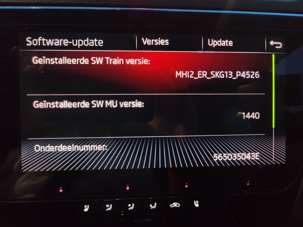

On 10/12/2023 at 16:16, RozhkovDim said:
Hello everyone,
P4526
1440
Google it mibsolution
@mstkrsyou have download link on PM

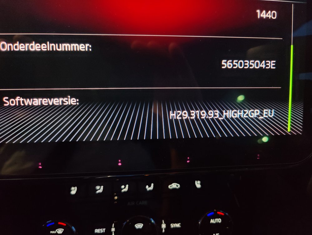

Is there maybe a firmware upgrade available for my mib 2.5?
Nope, you are running the latest available version.
