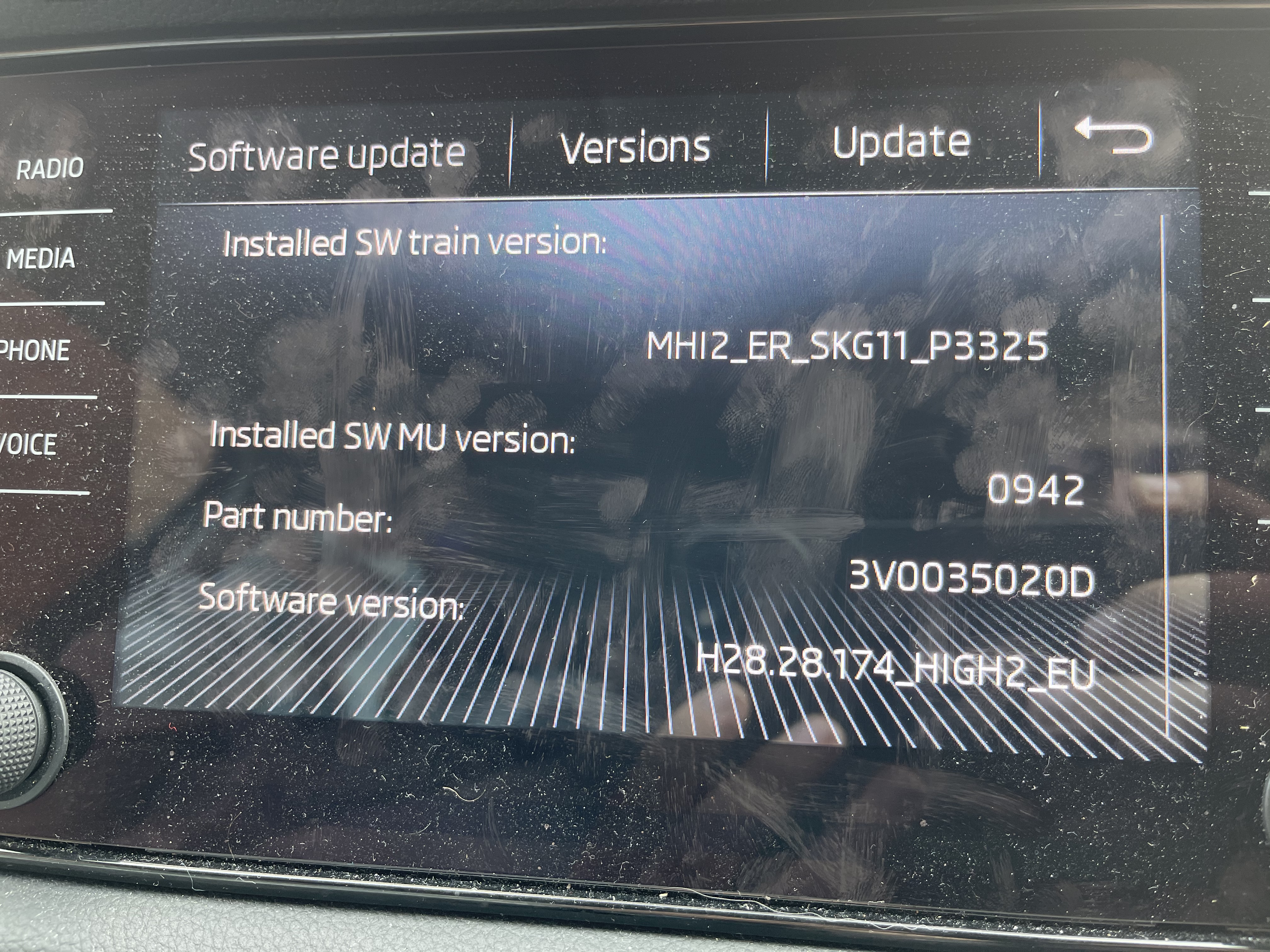

Hi all, not sure what MIB version this one has (2017 Kodiaq Edition TSI) but can someone provide the update file for it. Cheers.
also it has the wireless charging mat but doesn’t seem to have wireless CarPlay...
also has canton, not sure if that matters.
Wireless will not work due to it isn't support 5ghz frequency. MHI2_ER_SKG11_K3343_MU1433 from here http://uploaded.net/f/5yrq0j

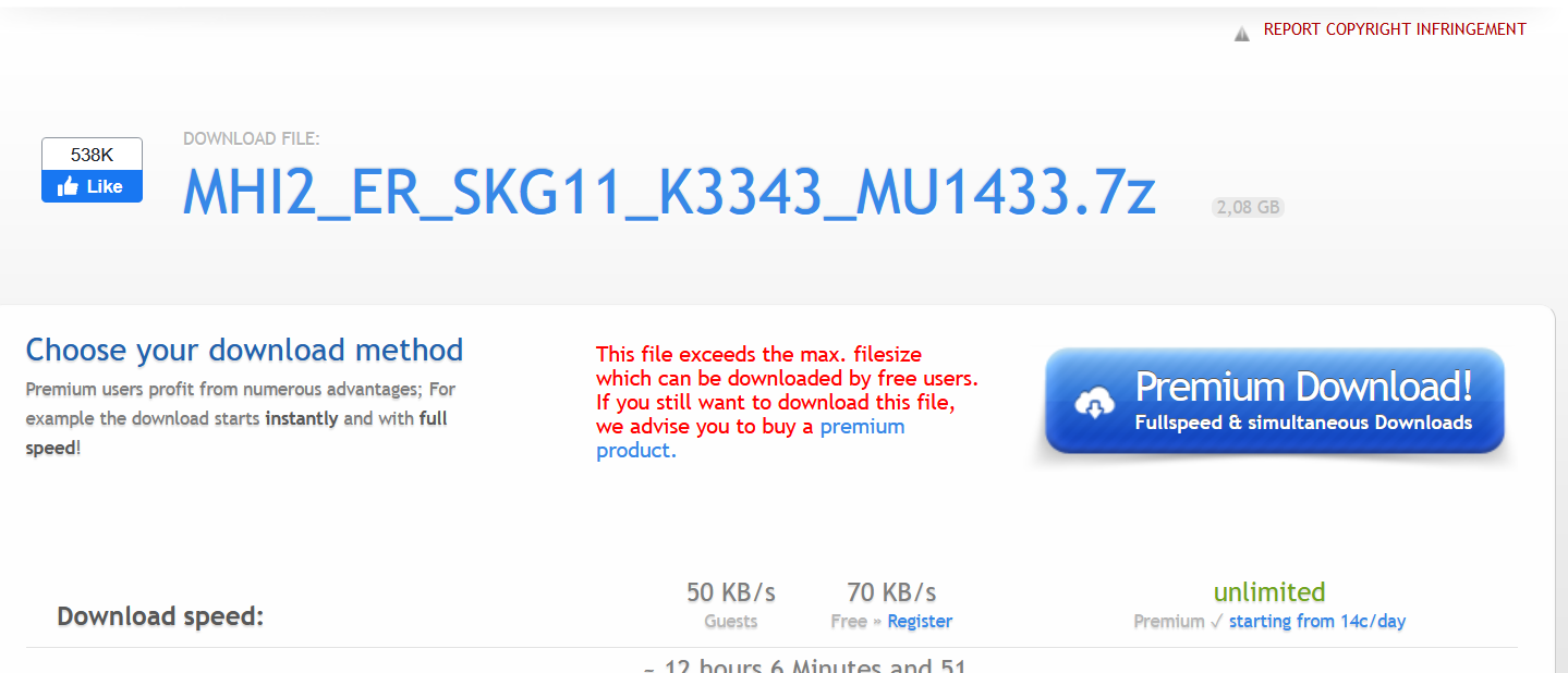

Do you have it available to download on another platform?
I prefer to download from mibsolution.eu guest/guest
That’s class! Thanks man :D

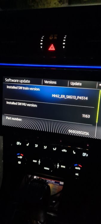

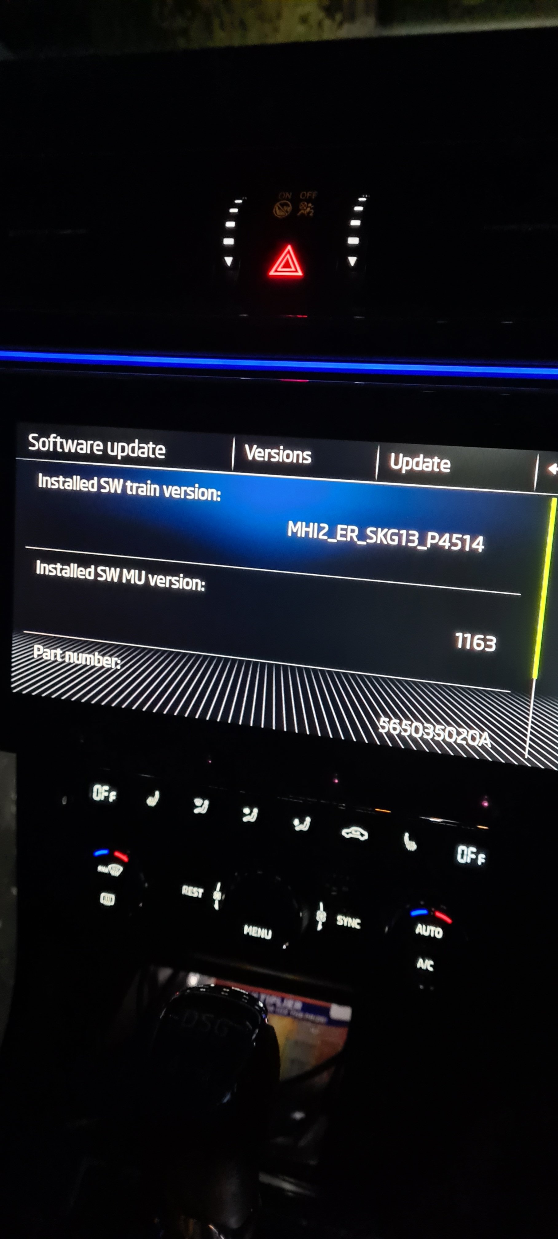

Hi All,
First time posting here. I've had a good read of this thread. I just want to make sure I'm downloading the correct update for my system.
It's a columbus system with this train version:
MHI2_ER_SKG13_P4514
Is this the correct update for system? :
MHI2_ER_SKG13_P4526_MU1440
If it helps its a superb 2.0 tsi 4x4 280.

On 15/04/2021 at 00:29, Jordski said:
Hi All,
MHI2_ER_SKG13_P4514
Version is right

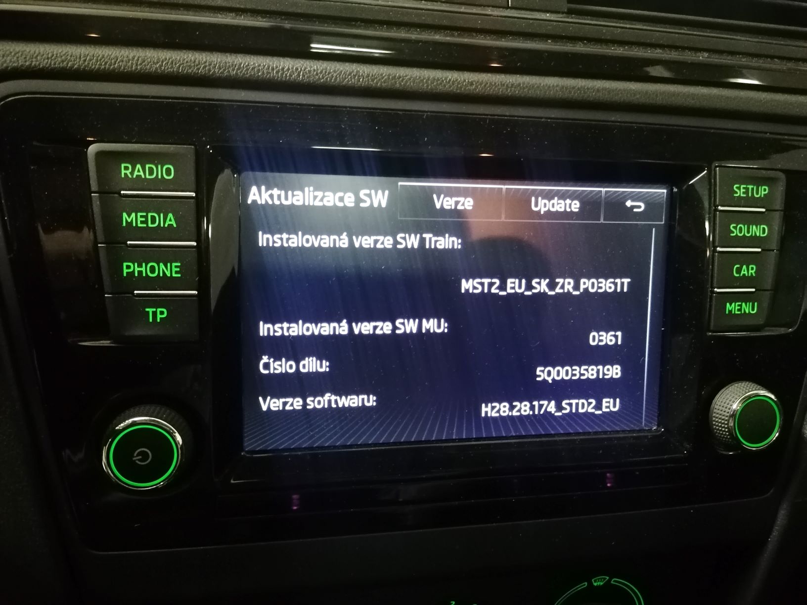

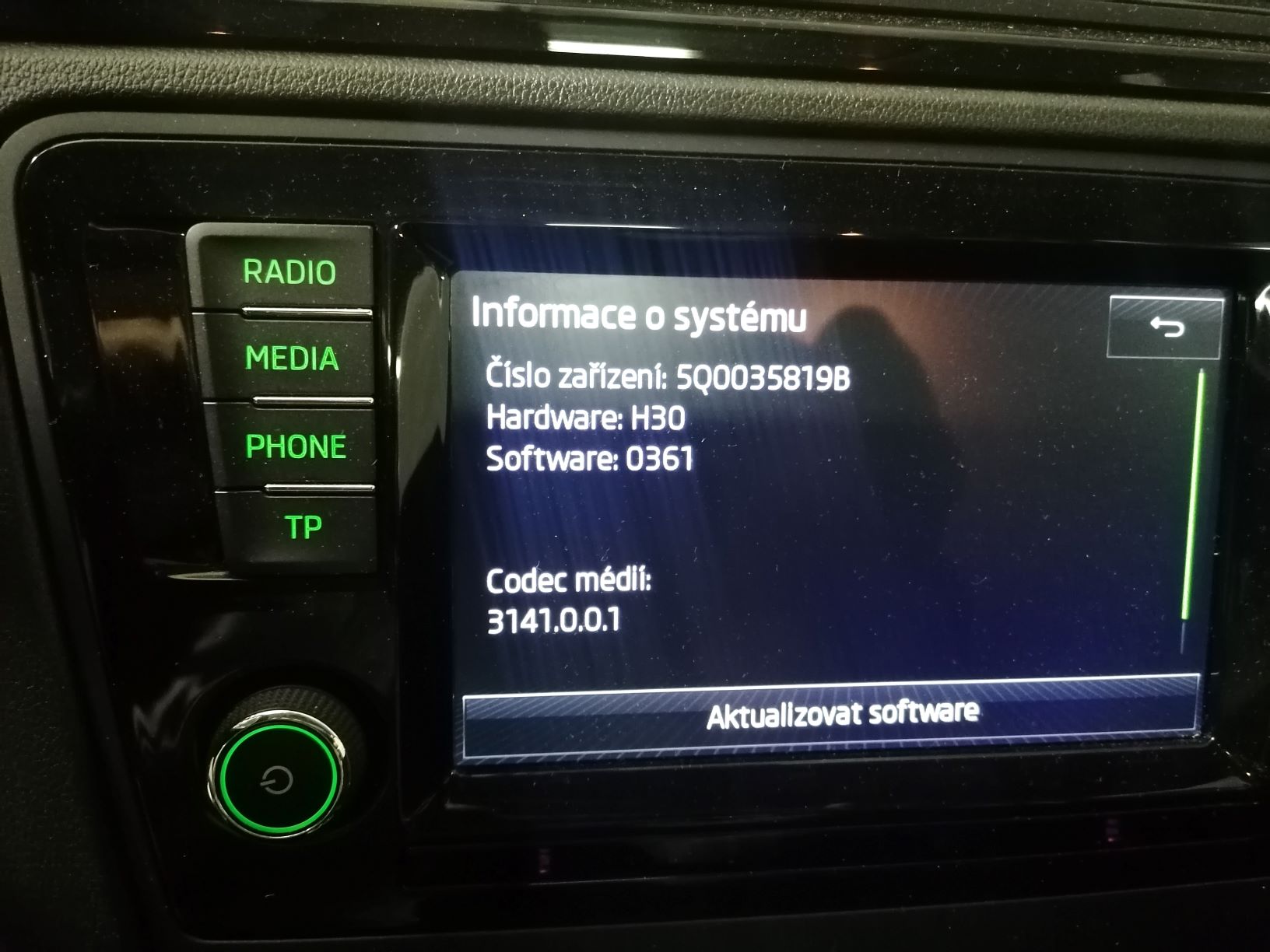

hi
My system is
MST2_EU_SK_ZR_P0361T (0361)
can I update to this version
MST2_EU_SK_ZR_P0478T.7z
Please consult
I'm a newcomer here
unlocks to me SmartLink AndroidAuto
Thanks
On 23/05/2021 at 17:29, Jaroslav said:
hi
My system is
Please consult
I'm a newcomer here
Thanks
It isn't so easy to guide you go through his articles https://www.drive2.ru/l/582864309097344755/ and you will find all that you need to do
@RomanB
Thanks
I don't think it's going to work anyway.
The garage told me it's going to cost 6,000 crowns.
I'd like to go around it for free.
