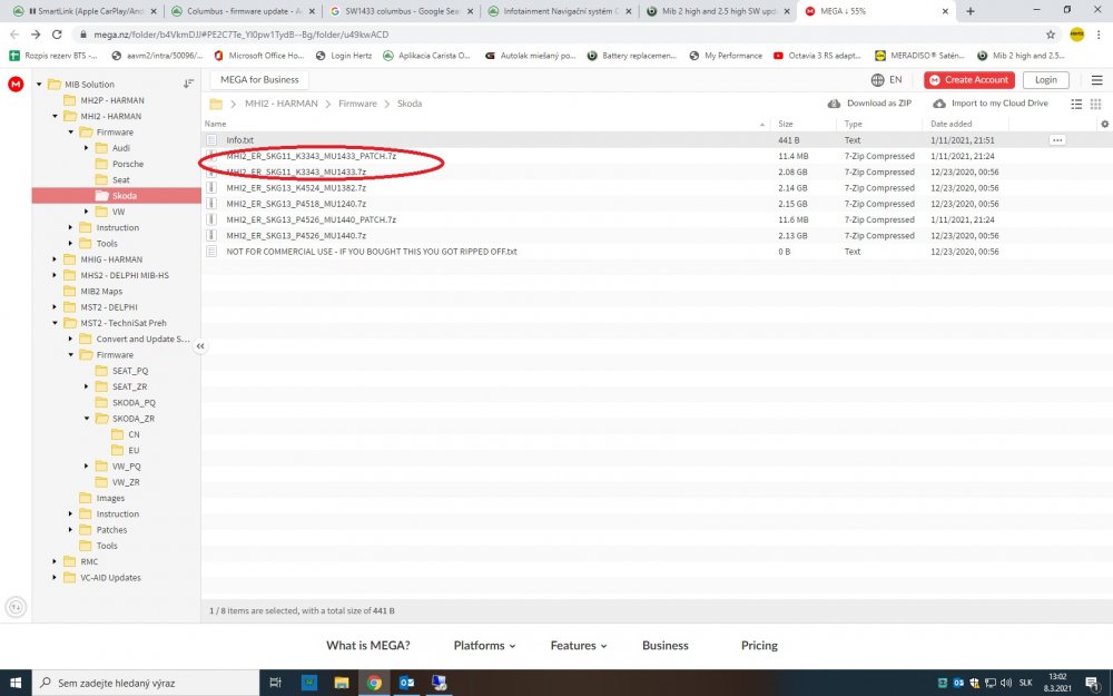

Great, got it updated with no issues with the engine running. I noticed in one of the other MEGA directories is a file called MHI2_ER_SKG13_P4526_MU1440_PATCH.7z - Not sure what this is for as when downloaded its a weird file type. Im assuming its a more up-to-date patch for the one I installed?
It was described here and here

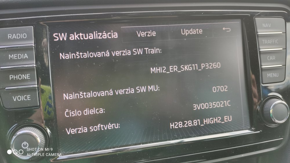

If you have mib 2.5 last fw is 1440 https://mega.nz/folder/b4VkmDJJ#PE2C7Te_Yl0pw1TydB--Bg/folder/u49kwACD but you need check your train first (press menu for 10 sec)
Thank you for your Reply RomanB. I will download that file. Thank you for the link. And yes, it is a mib 2.5.
The software train:
The software train:
So then 1440 last available fw
Thank you for your help RomanB. Updated this afternoon. All went well and smooth. For others: due to the size of my SD card i was unable to format it in FAT32. Used exFAT and all went well.
