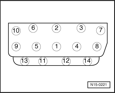

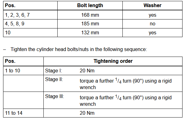

  • Head bolts are various different lengths and some have washers and some don't. They have to be positioned into the right holes. Here's the info you need....     Tightening/positio

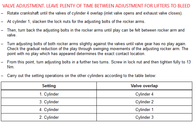

So the tappets arrived today, boy that was fast, so all systems go for the 8th. Just a couple of questions I got please guys, to take the inlet manifold off, do i only have to disconnect the electrical connectors to the injectors, I can leave all the fuel lines or fuel line ect connected .. also when you say to put 2 turns ect on the adjusters does this mean one full turn of the nut, 180 degrees?  Thanks man 😁
Tightening/position order....
Tappet settings (they are hydraulic but have an initial setting procedure)....
A further 2 turns.. is that a full 180 degrees of the nut. Just to clarify.. is it easy to mess this up and does it have to be bang on exact.
Two turns of 360 degrees. It doesn't have to be absolutely bang on, it's just to get the lifter pistons set at about half way down the lifters.

Personally, I would set them as you are having the head skimmed. Probably makes not much difference but you know they will be right. It's a pretty straightforward procedure. I just jacked one side of the car up, put it in fifth gear and turn the jacked up wheel to turn the engine.
