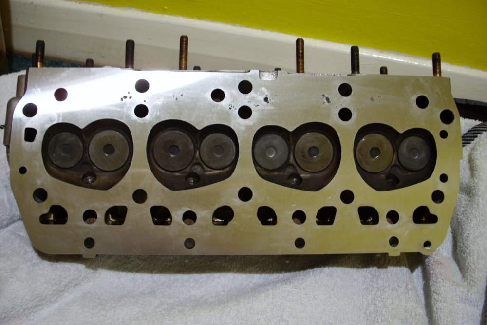

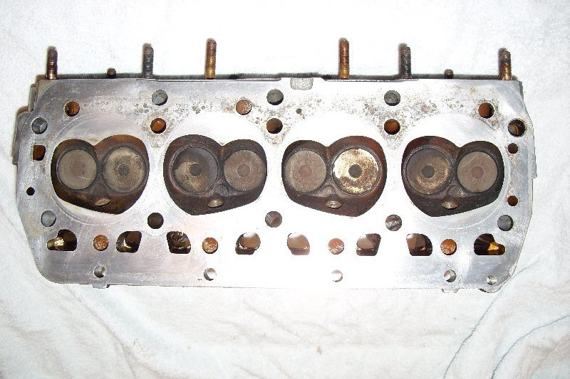

Before...
After....
Still a tad of corrosion on it which worried me but it's been absolutely fine with no more water loss. It was blowing it out of the expansion tank before.
